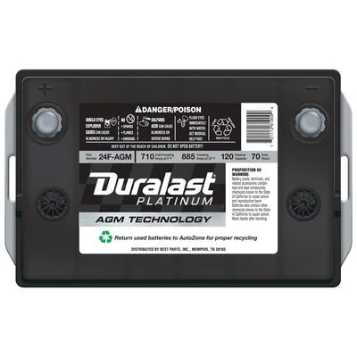

My understanding is that 24 vs. 24F means that the F is reverse polarity and the positive terminal should be on the left.
The specs for this battery read:
Part Number:24F-AGM

I'm more inclined to believe that the Autozone website here is wrong. I can't see the markings on the battery.
When you connected the multimeter, do you know if you got a positive or negative voltage reading?

I believe you are correct Sir. BTW it was a positive reading per pic on page 2
I went looking for more pictures of the 24F-AGM battery and found:
Looks like its correct.
