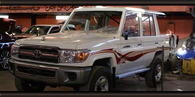

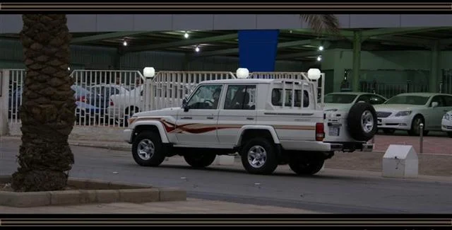

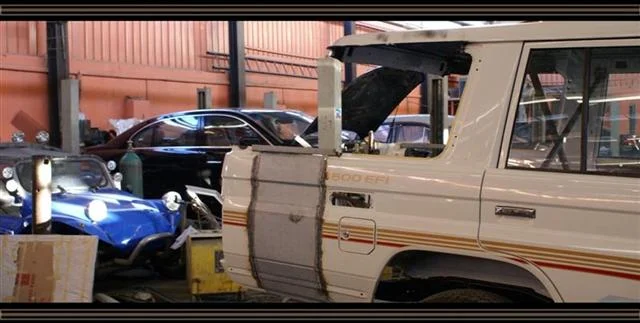

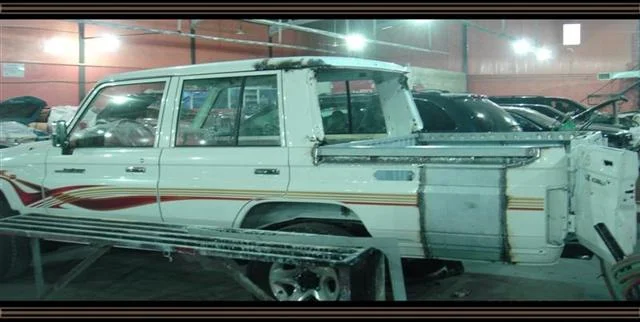

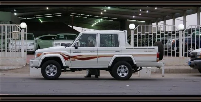

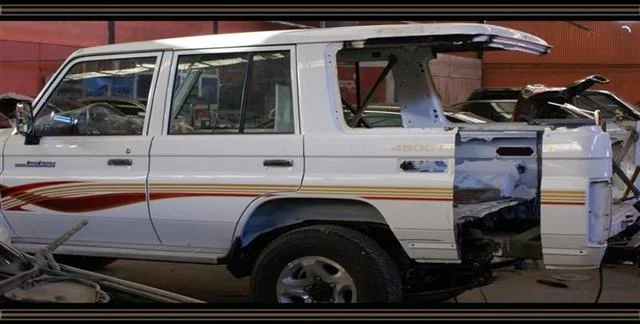

Here is a new 70 series 2007 with body Fabrication .
Location: Saudi Arabia
Enjoy the pics :)

Looks nice. but rear overhang quite substantial and will get caught in crossings.

Those dual cab conversions are doomed if they try and carry anything heavier than the weekly shopping.

i like your conversion...nice work of art.
i hate to see the bill for the work though.

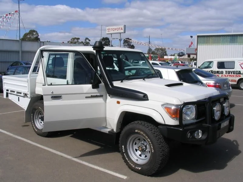

Rosco-Hi what do you mean doomed,chassis failure or the load bin collapsing?
The roof forms part of the structural strength and its no longer connected and they have also added 400mm to the length.
I can see they have added some reinforcing but it still looks weak where the top of the tub joins the rear pillar.
I predict it will crack the body in that area but it will depend on the load and how its driven especially offroad
A stronger way would be like this one below so it can move around a little independantly to the body, but I guess the Saudi customer wants the factory look,but I it will depend on the load and how is driven
