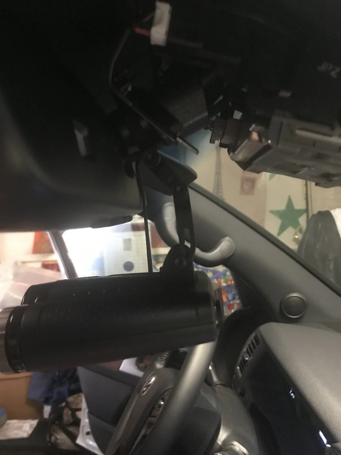

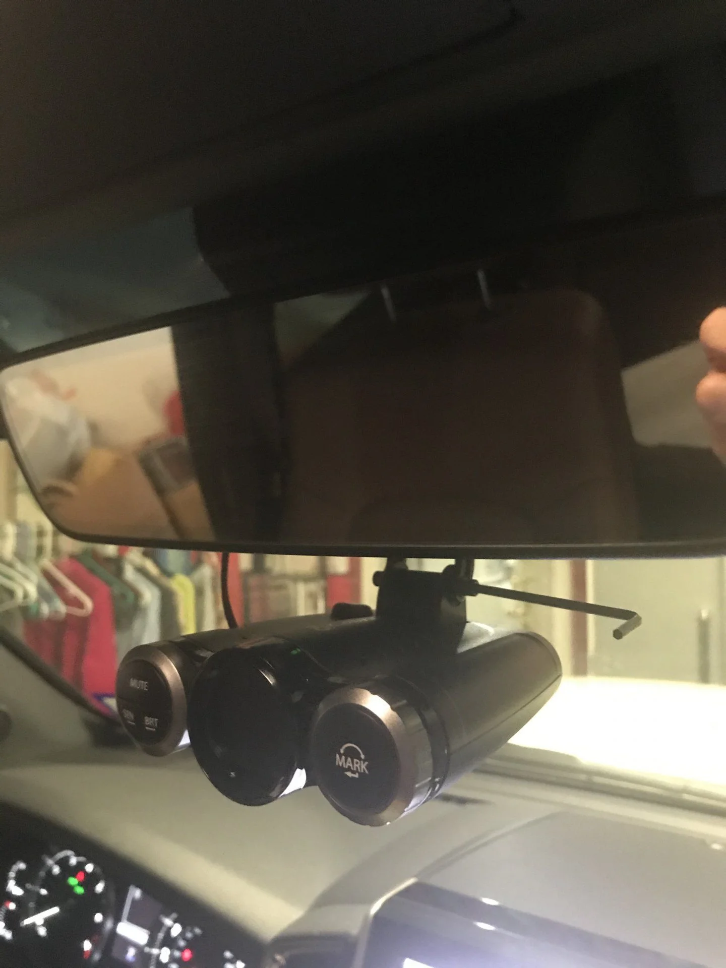

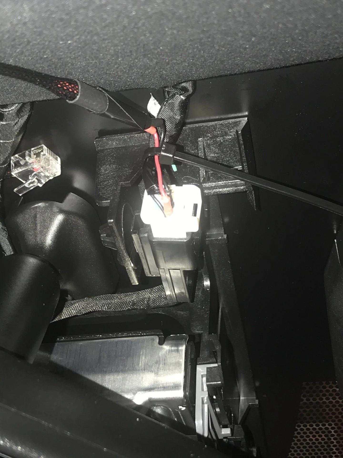

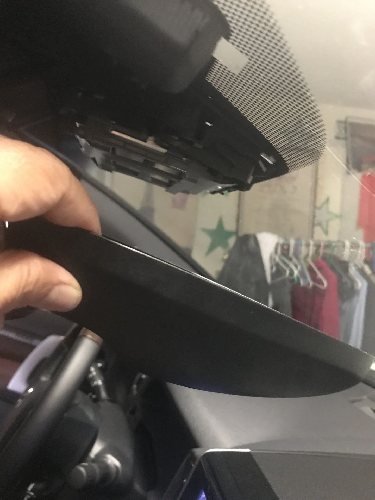

Did the mirror tap and blend mount for LC21 today. Rj11 for road scout combo.had some pics but resolution not great.
White wire -ground, black -active.
Small Top cover needs to be remove ist then the and main one covering the mirror mount
