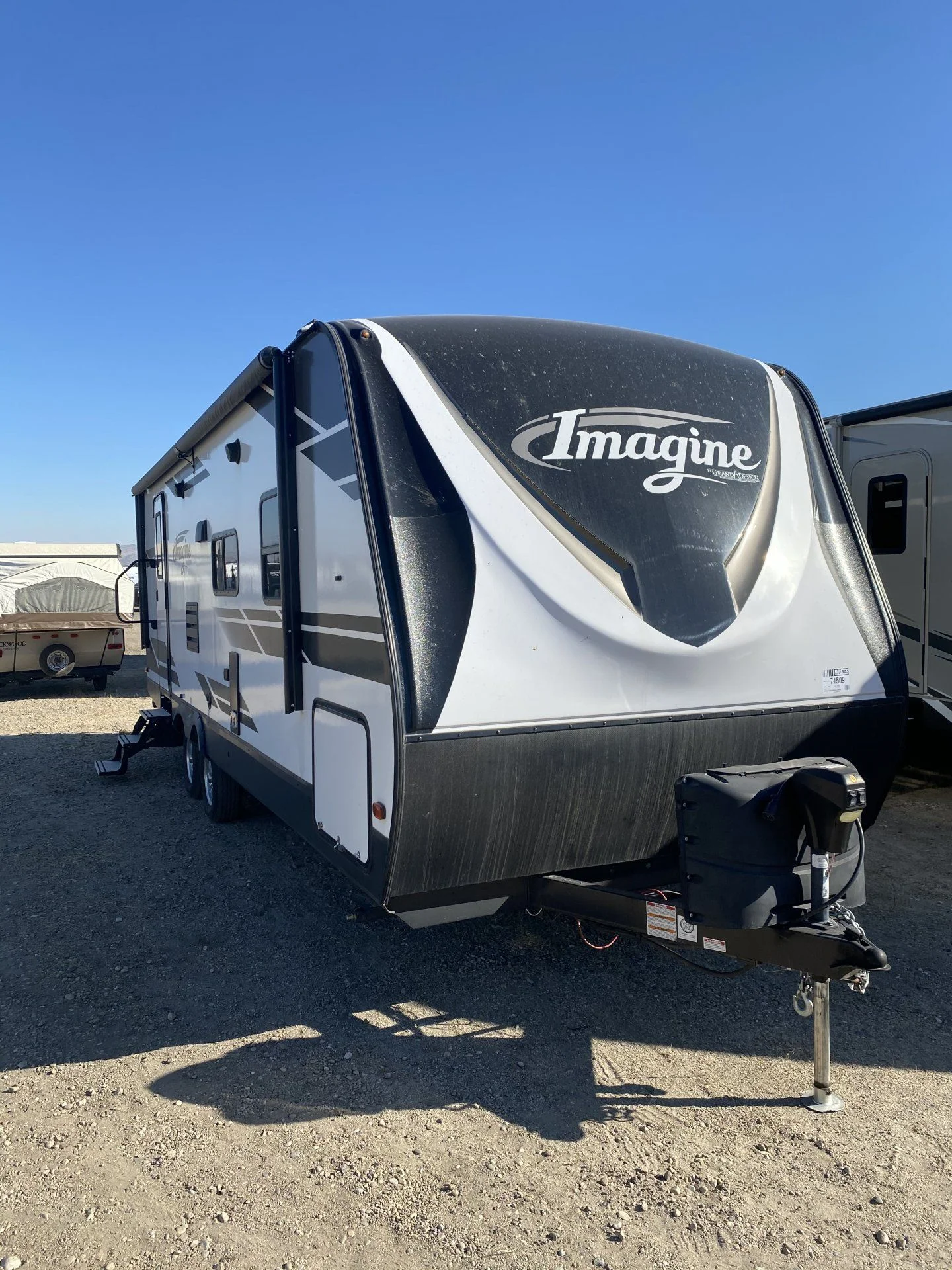

Thank you. Trailer is a Grand Design Imagine 2600 RB. Thank you for the overview of your towing experience. From everything I read I thought that that was going to be the experience. Just for the heck of it I’m gonna spend the extra $300 and get the airbags. And then hitch it up and go.
