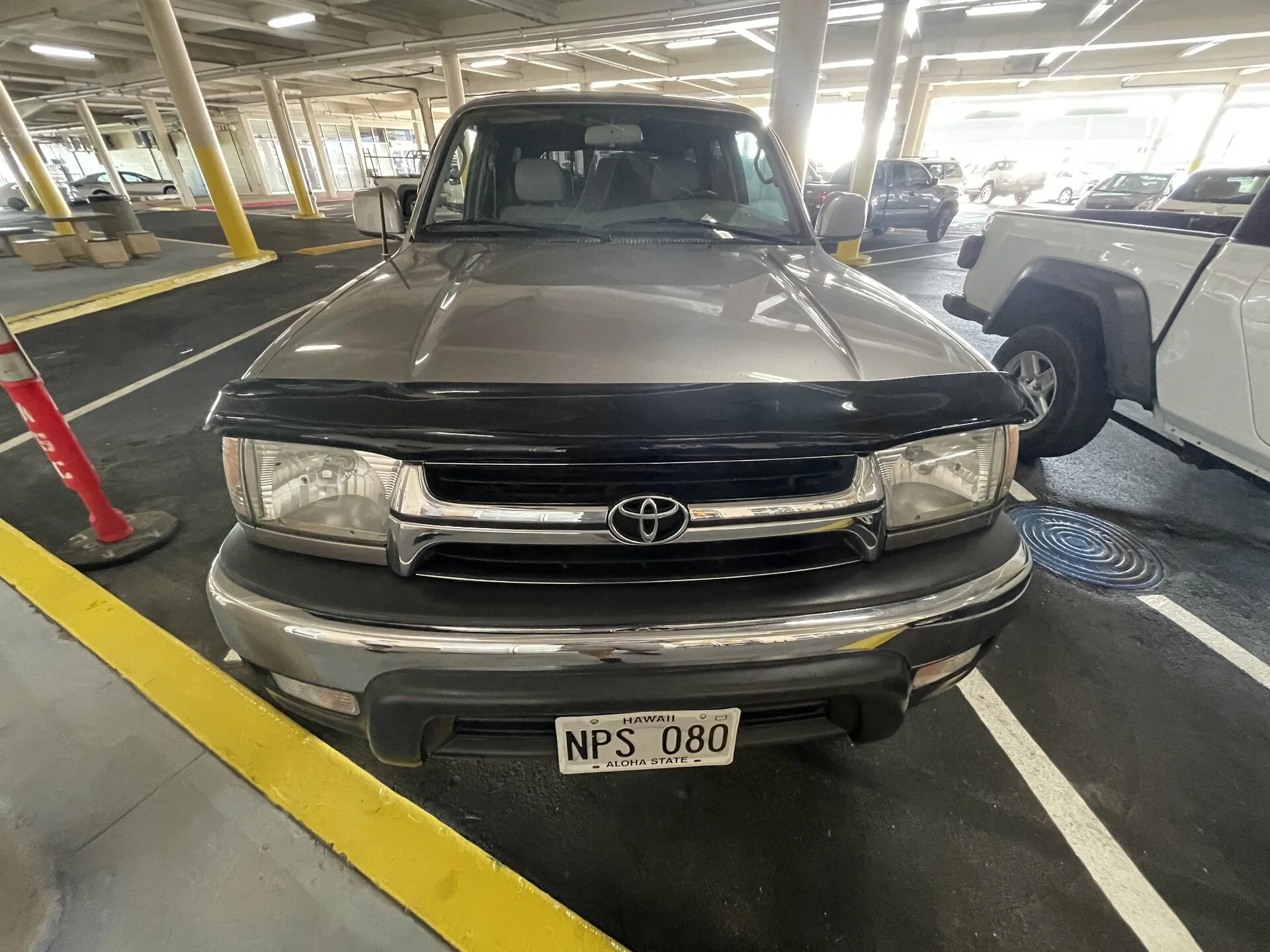

the reflective chrome stuff fades, to me the ones in the pictures look very faded. these are new aftermarket ones
