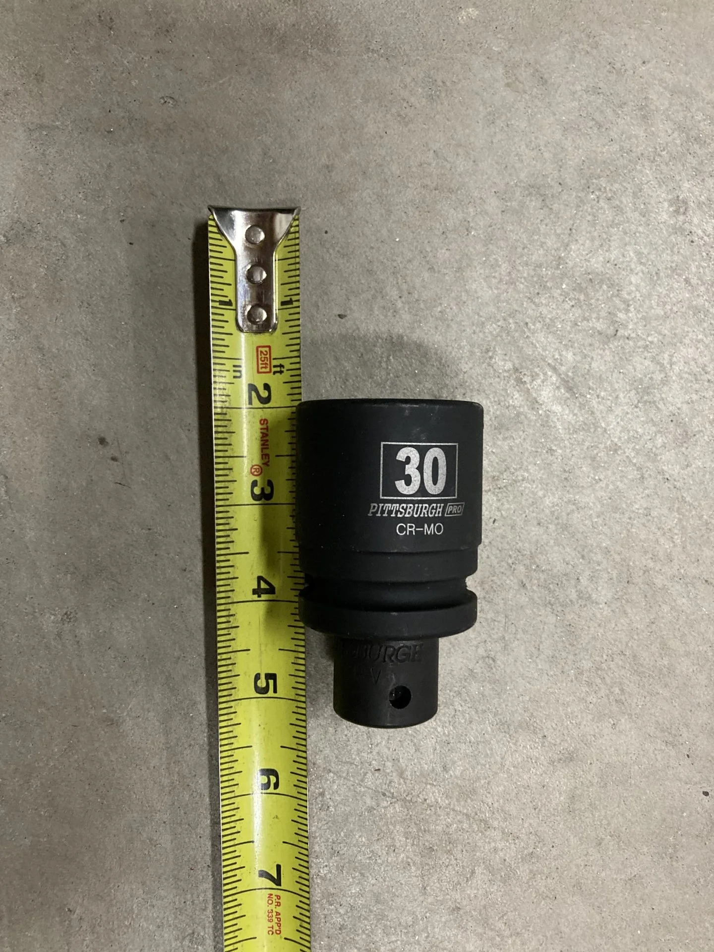

Need to borrow a shallow 30mm or 1 3/16" shallow impact socket, 1/2" drive
Aug 21, 2003
854
16,781
Tijeras, NM
Let me know if you got one.
Thanks.
I might have a 30mm, but it won't be impact.
I have a chrome 12pt, but I need 6 point impact !!
30mm 3/4 drive with adapter is a hair over 3” long. I assume this is too long?
I do have a 3/4 drive breaker bar
Or I have a 30mm deep 1/2” drive

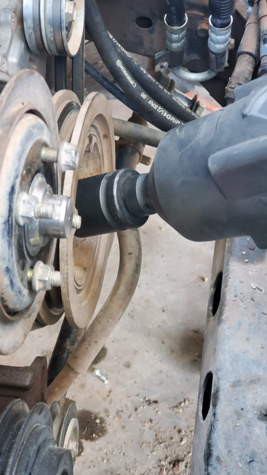

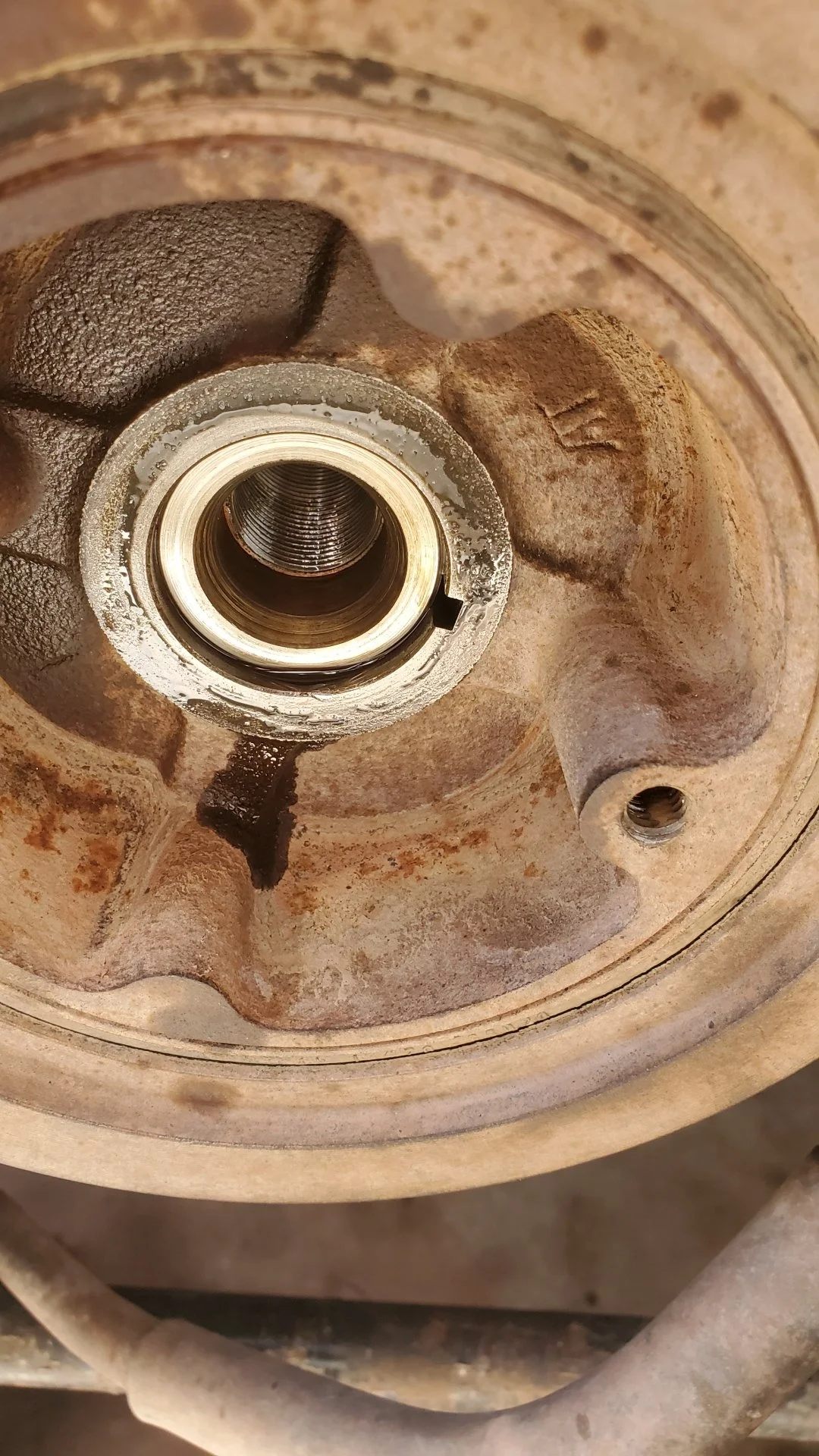

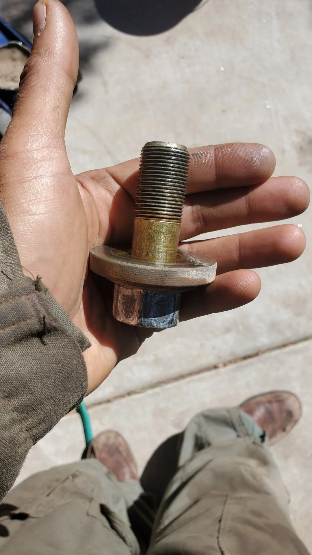

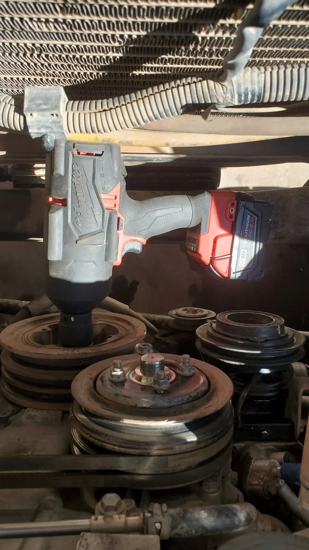

Finally got the crank shaft bolt out :bounce2::bounce2:. She first broke loose with the torque multiplier on the bolt head while a 14 mm deep socket on the flywheel bolt head (was holding the engine from rotating), against the bellhousing. That broke her loose, then a high torque impact brought her rest of the way out. Thanks again Virgil for the help💪 and Juan and Leon for the tools loan. This took three days :bang:. I was afraid of ruining the threads inside of the crankshaft or if I some how managed to shear off the head of this massive bolt. Thankfully, all worked out well. As you can see, the threads are clean and no loctite was used the last time. One theory is that the cruddy engine oil somehow snuck into the threads and acted like loctite but that's a WAG. A new bolt is getting ordered today as I don't have a tap or a die that large.
