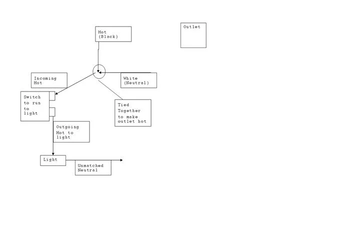

I'll try to keep this as non-confusing as possible. I have an outlet that used to be hooked to a switch so if one desired, you could switch the outlet on and off at will. At some point, someone didn't want the switch and converted the outlet to always hot. To do this, they spun the hot and neutral together and called it a day.
Here is where I come in. I want to use the power supply to connect to a switch that runs a recessed light. The problem is that I want to maintain the outlet in an always hot condition because my plasma is hooked up to it.
If I leave the neutral/hot spliced together and run a hot pigtail off that to the switch, I will end up with an unmatched neutral coming off the recessed light. It seems like my only option is to keep both the outlet and the light connected to the switch, which I would like to avoid because I will no longer have my hookup for the TV.
Thanks
A picture below might help:
Did they wire nut the wires together in the switch box?
You need to go to the box with the outllet and pick up your power there. There should be a hot coming in, that will feed the outlet and switch and the white can be connected to the other whites and become a neutral again. That shoiuld give you hot and neutral to the switch.

Crap, I was afraid that might be the case, it's quite far away unfortunately and will require cutting drywall and monkeying around fishing wire.
Please make sure that you disconnect the black and white wires in the switch box before you turn the breaker back on

I think I am just going to abandon getting power from that area, I have a live outlet/switch in a much more convenient spot that I can pull and pigtail off of. In order for me to find said outlet and pull hot wire from it I would need to do significant fishing and sheetrock work just to make it happen. Needless to say, there is an outlet and switch nearby in a bathroom that would make a great place for a new switch to pull from.

I already fished the wires in for the ceiling light. I ended up running off a switch and relocating the whole switch panel. It works great now!
