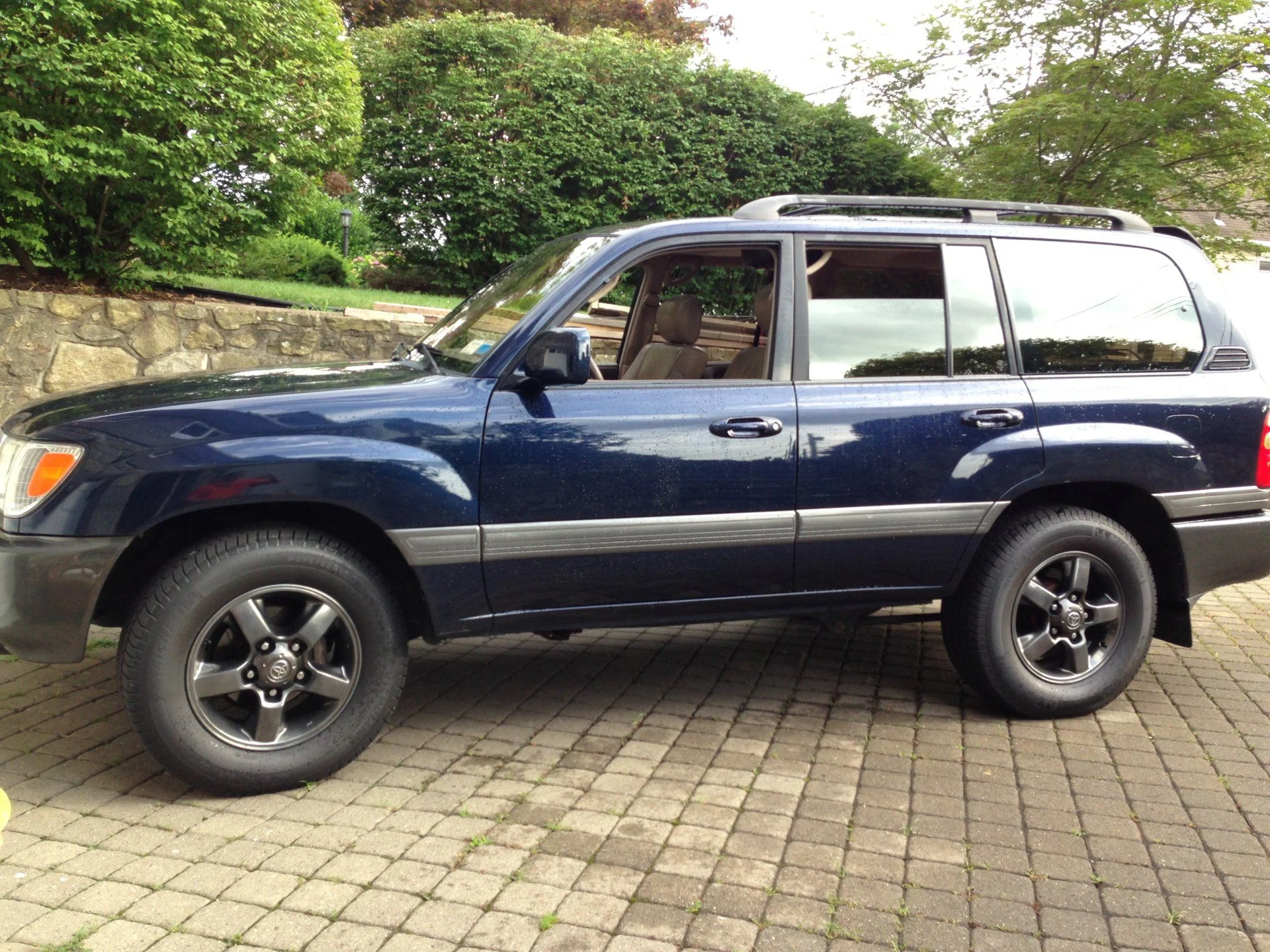

Did you refinish the wheels yourself in the dark grey? They look fantastic.
I’ll price out OEMs. The Bilsteins lasted 100k.

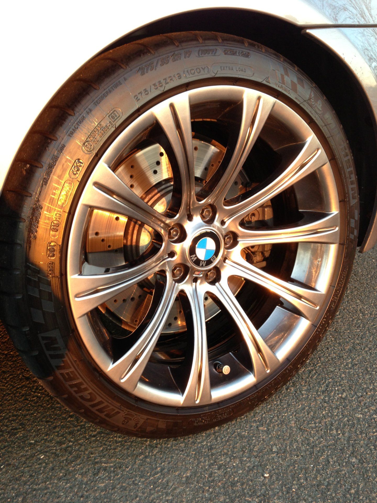

The wheels are what’s know as shadow Chrome. I had an M5 when I had this truck and loved the finish.
I got the black chrome trim and swapped out the gold (dark time in auto trim!). Then the wheels were done at my brothers in laws shop in New Rochelle,NY.
The wheels are chemically stripped and powder coated gloss black. Liquid chrome is painted on the surface while it’s still hot. You just paint the spokes and lip. The pockets just get the over spray which gives the shadow effect. The whole wheel is then powder clear coated.
I’ll see if I can find a few pics.
