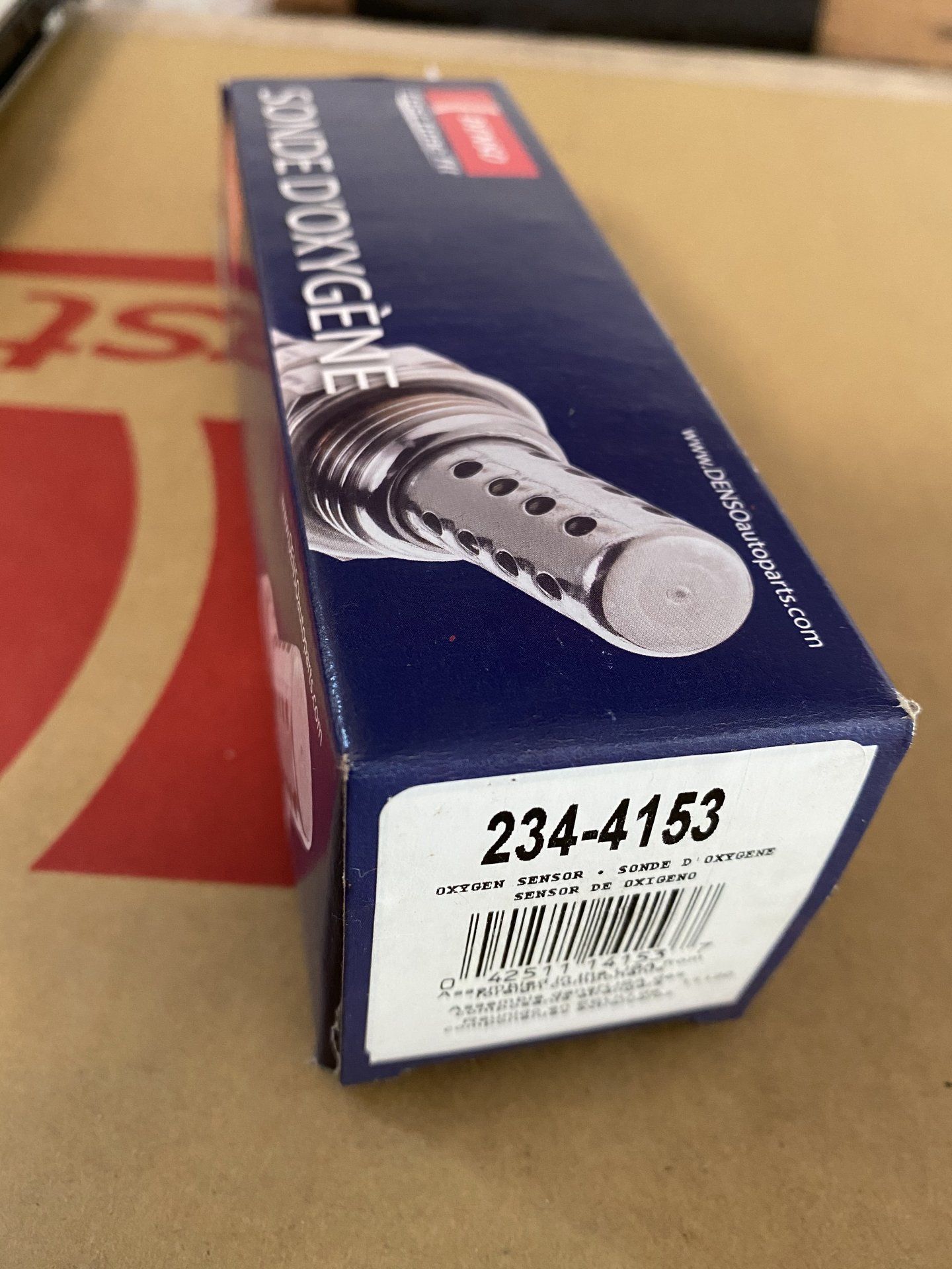

My mechanic friend has a obd reader which can monitor o2 sensor reading and we went for a ride and he told me the rear sensor was not very responsive. He suggested to just replace it. So i called the dealership and they said that o2 sensors are now discontinued. I seen on here people are going to sparkpulgs.com and getting quality sensors. So i did and the new sensor came in, installed it and same thing. PO141 second ride again.

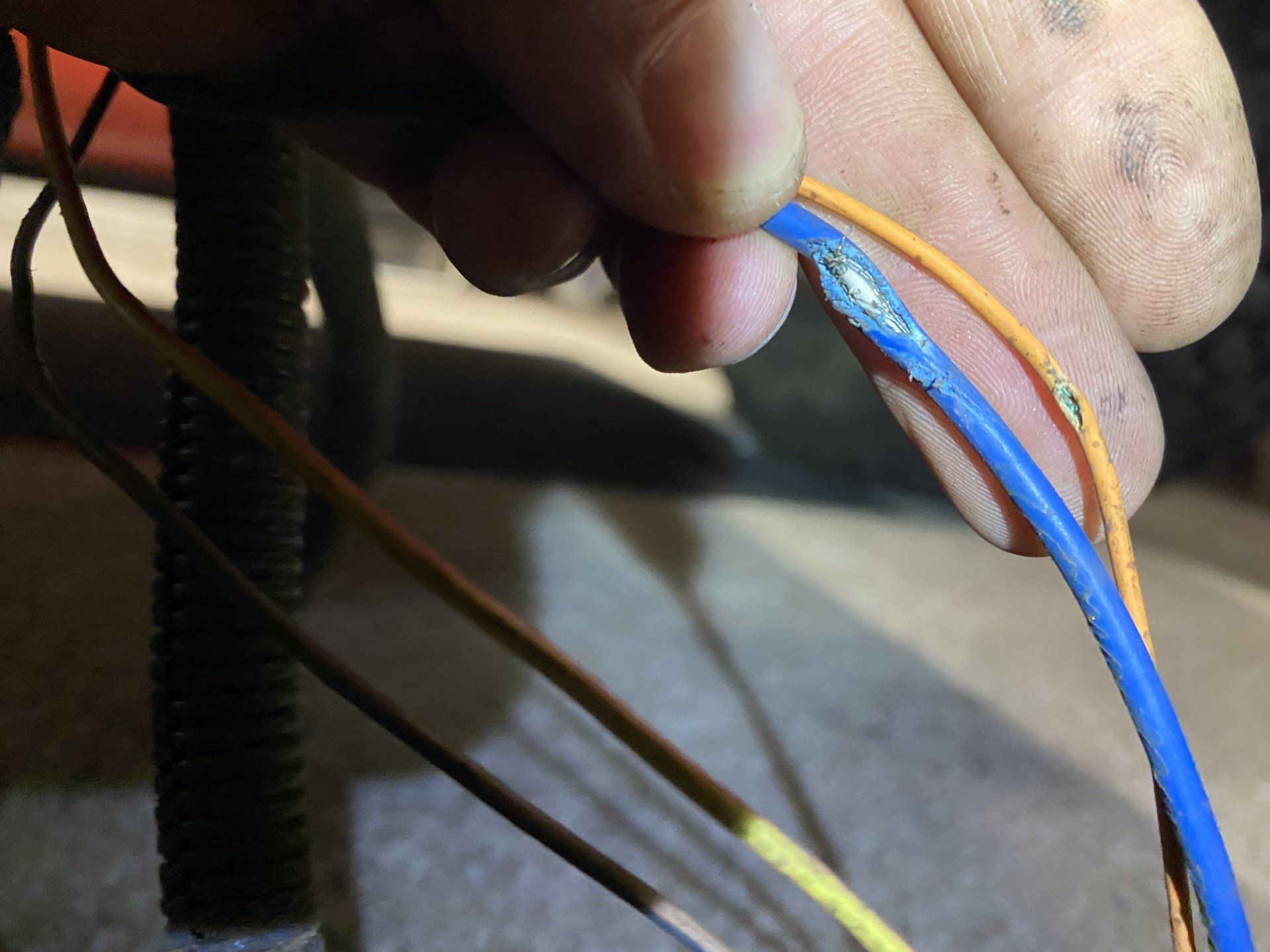

I visually checked my emissions connections but nothing seems a miss.
