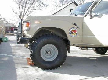

    here's 36's

    at the time it was stock shackles with well worn 4" alcans.
