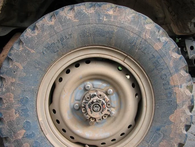

How about this? I guess you'd need to pick up some splitties.
Split rims are relatively easy to find but my concern is repair of flats when we're stateside as most gas stations that do flat repair won't touch split rims.
if you have a full size spare you can deal with it when you want. FWIW with 8 ply tyres and a tube I've never had a split rim flat. Knock on wood. :popcorn:
Bull had a nice write up on how to change one in 40 tech
https://forum.ih8mud.com/showthread.php?t=55037&page=1&highlight=split+rim
