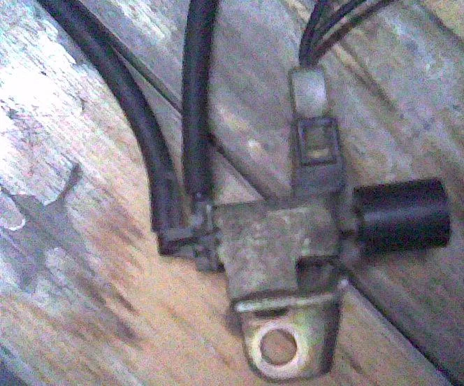

Also, what is the purpose of the two relays attached to the body on top of the break booster? See pic 1.
Pic 2 is the relay I am using as replacement for the 'vsv relay'.

The pipe configuration is well described in former posts by rutbeer. If I remember correct, the nozzle with filter (in the pic) is going to get suction from alternator (metal pipe connects to it). Middle nozzle to VSV (engine shutter). Pipe to the left most needs free air.
I do not remember the part number. Use the pic to describe it to a tech. Any relay with similar working will do the job (it has to be 24V).

How did you take this pic? Is that your elbow or leg?:eek:
