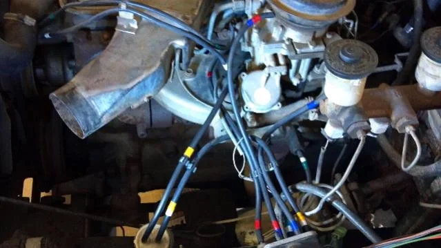

Would the process description in the second post be similar for a 4/75 40? The previous owner performed the desmog so I would like to double check there work. Also, I am in the process of installing a new wiring harness and would like to avoid wiring in the computer and vacuum switching valve. Attached is a photo of the guts if someone has time to double check.
Thanks
Dane
I'm also interested if these instructions apply to a 4/75. Mine has a previous owner desmog as well. It's "backfiring" through the exhaust while engine breaking. Need to check the timing and air/fuel, but an incorrect desmog with a vacum could be causing it. I want to make sure it was done right.
