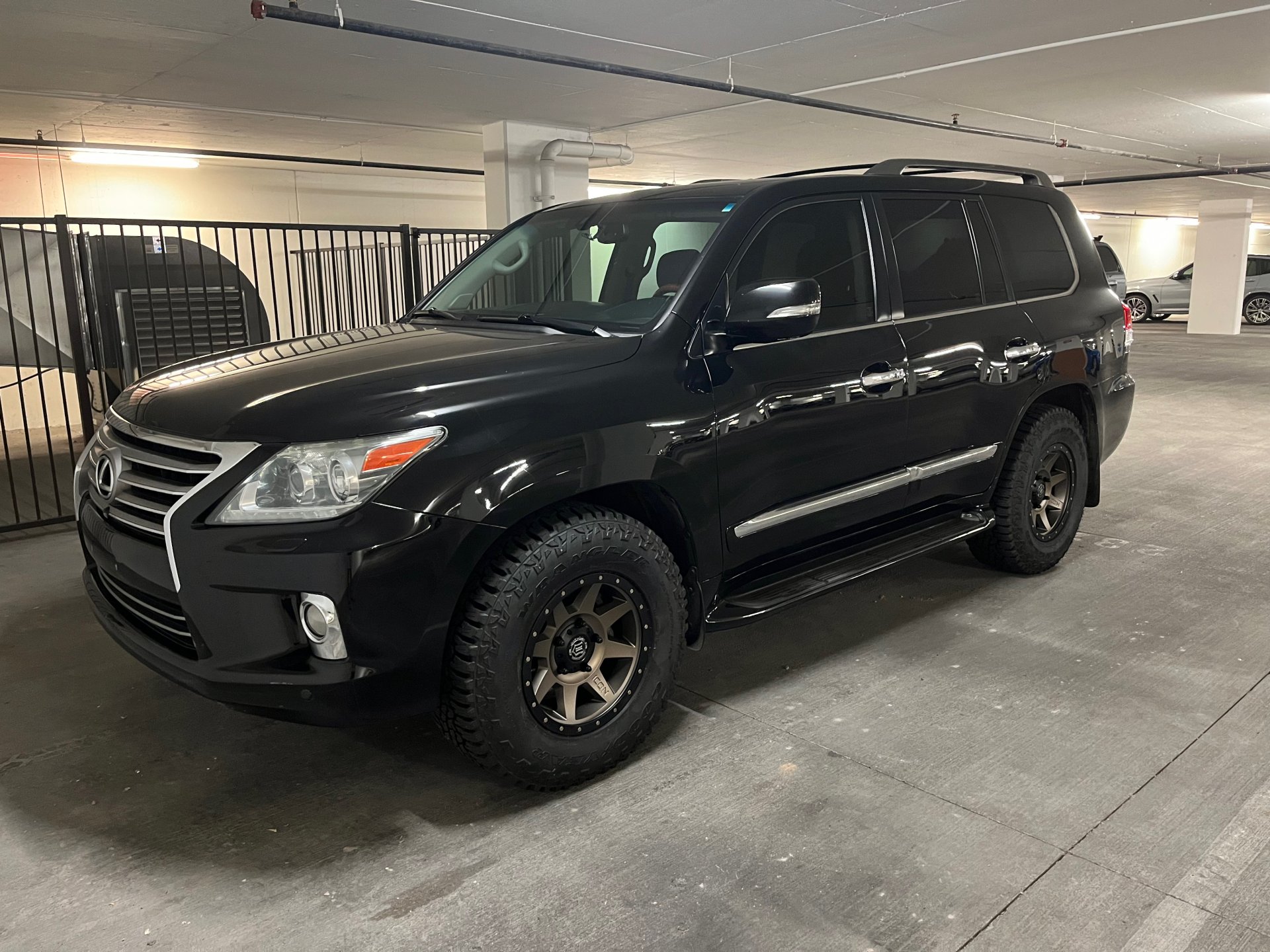

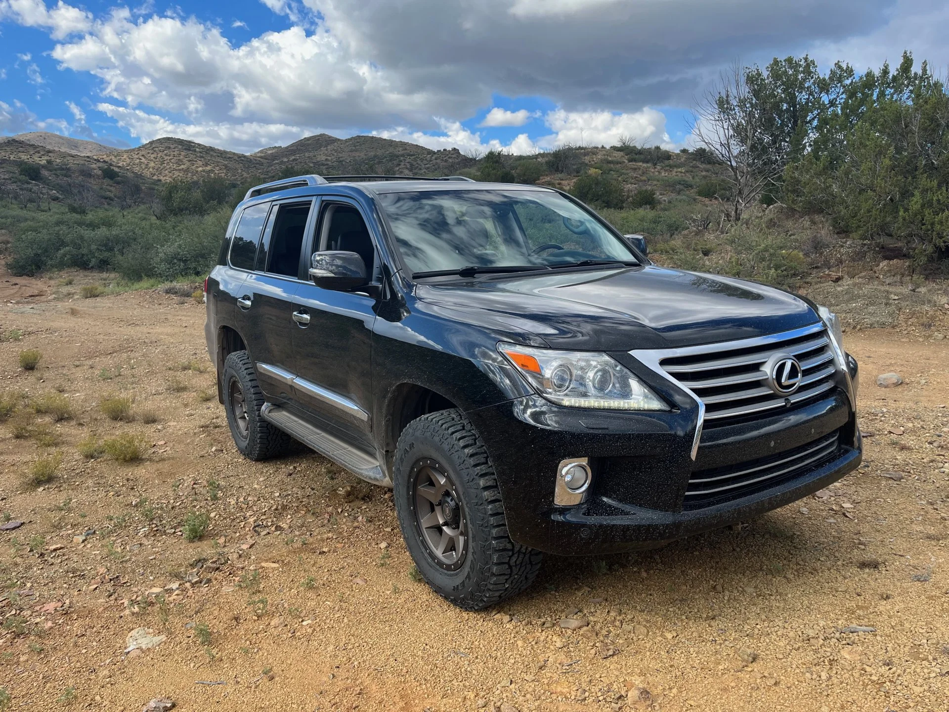

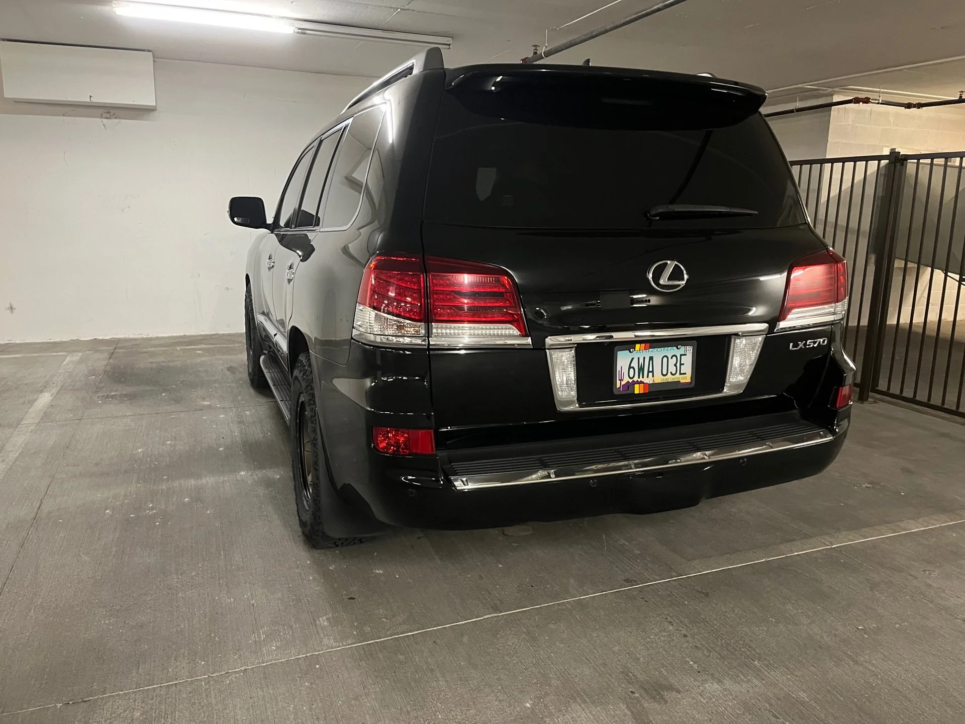

Thanks ! Any pics of your rig ?
Nothing terrific as I haven't done a proper shoot but here it is to give you an idea. Indoor pics are AHC Normal. Outside pic is AHC High.
If you look closely the indoor pics I have the front mudflaps on. That is mostly what rubs. I took them off before the outdoor pic but have put them back on after slicing off the parts that were rubbing. It will become extremely obvious when you put on your new wheels tires/take a look. There's also a small plastic piece held on by two screws in front of the front wheels that will probably need to go. Easy stuff.
ICON Rebound Bronze - 17x8.5 +25
Goodyear Wrangler Ultraterrain - 285/70/17

Very Nice !! Thanks for the pics it helps a lot especially the side shot showing the tires don't sit outside the wheel well . The bronze might be good on my Starfire pearl exterior color 2
