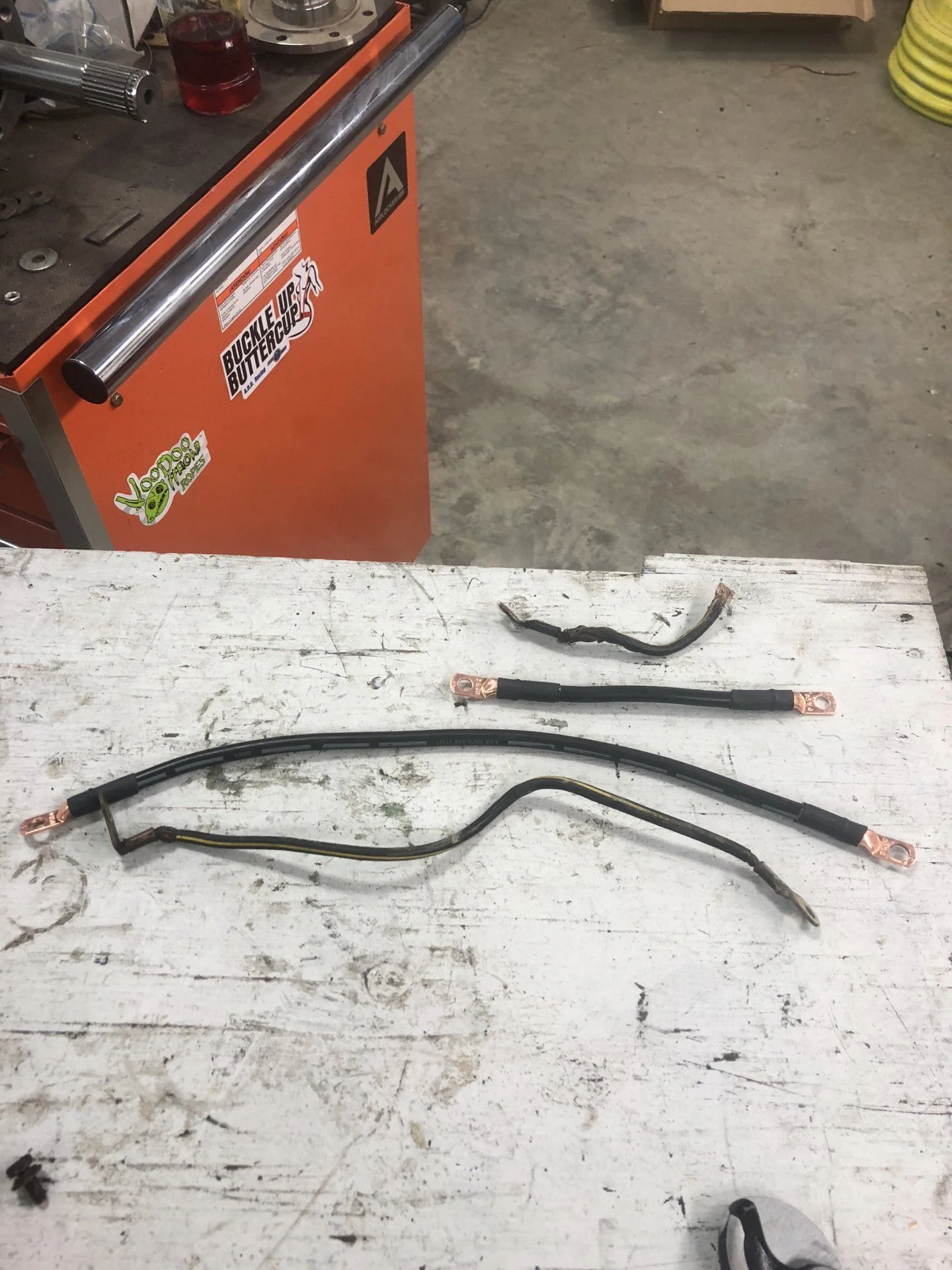

Another thought, do you have a good ground between the battery and engine? If that's missing, you might get enough current through another path to engage the solenoid, but not enough to turn the starter.
