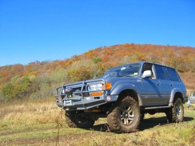

I've previously run 2" lift + 35"s, and 4" lift + 35"s.
2" lifted cruiser went absolutely everywhere my 4" lifted 80 did, and then some too.
I think 3"lift is about the sweet spot with an 80. More than that you risk driveline vibrations, and start adding lots of modified parts to fix suspension geometry etc.
