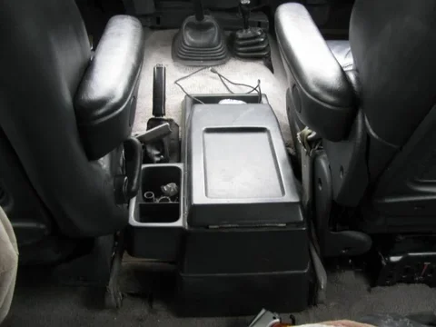

I installed a new Battery and I also installed a set of PT cruiser seats.
