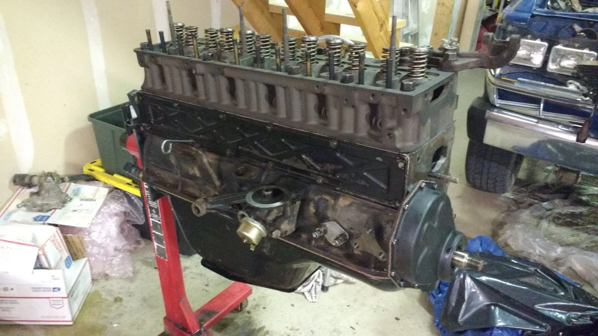

Yeah! This has been a fun little project so far! I've been doing some engine bay cleaning and parts cleaning. Waiting on the cylinder head from Empire. That should be ready Thursday. Also collecting parts to replace while I'm in there. Just dropped off the radiator today at Walker radiator.
Got the cylinder head back yesterday. They said it was in pretty good shape. They replaced the valve springs and did a complete valve job. Starting to go back together!

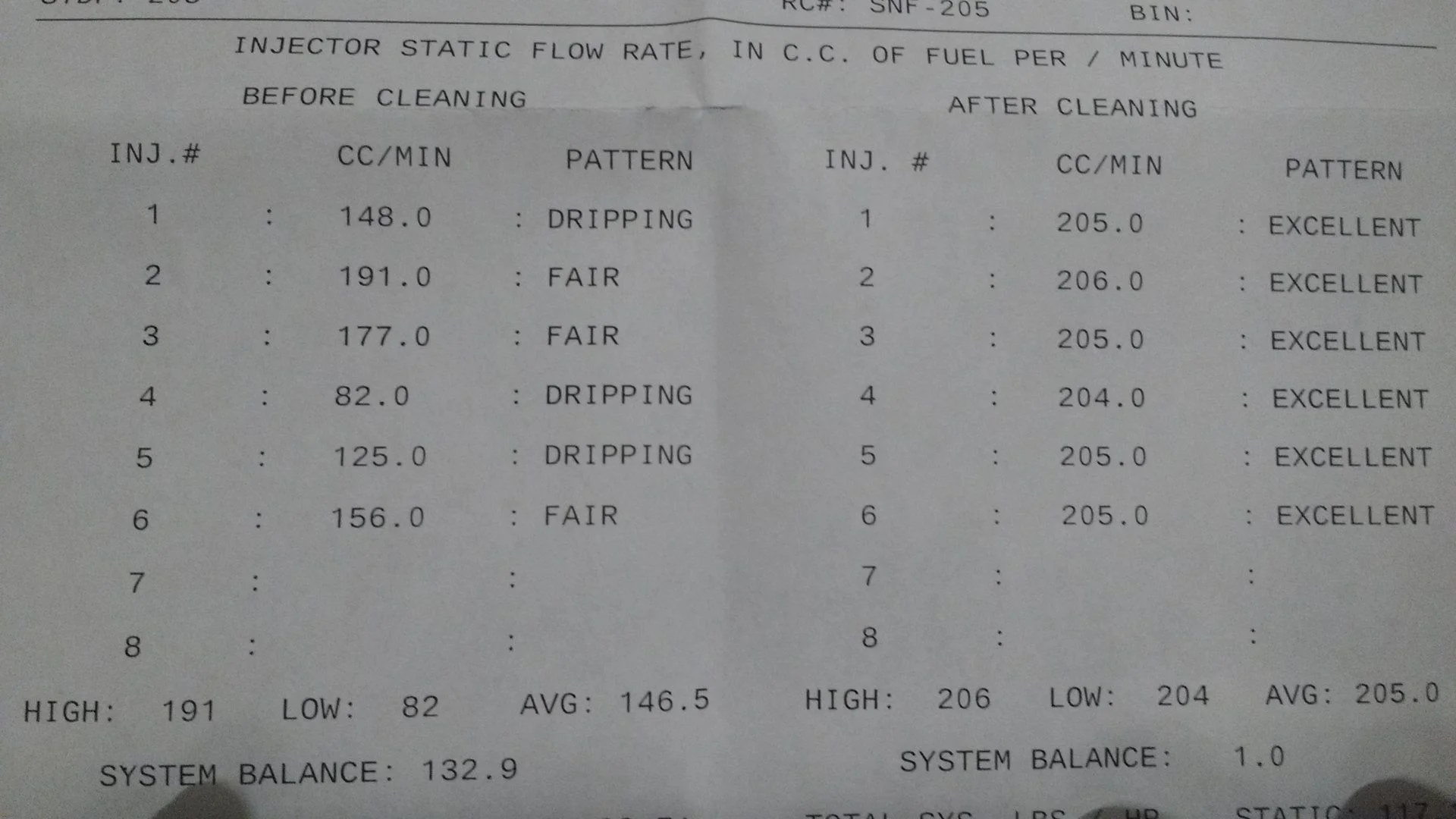

Also got my injectors back from RC in California. Flow rates were pretty bad on a couple of them.

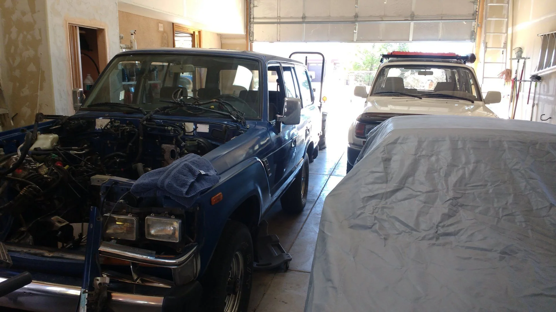

Meanwhile the 80 just sits in the corner, sulking. Here's what he's saying :flipoff2:
He's still getting love. Going to drive it up to Denver next weekend. Maybe I'll stop by Slee and get some sliders. He still has a garage spot!
