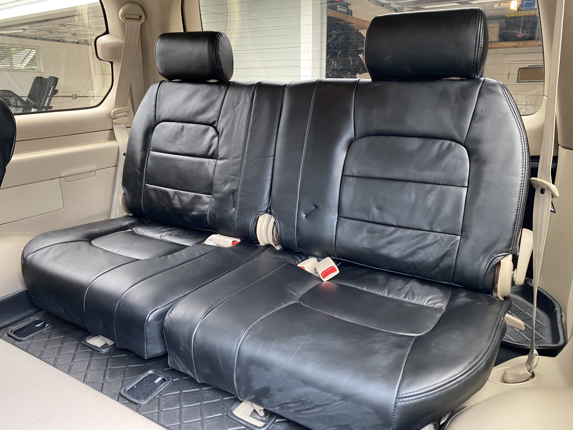

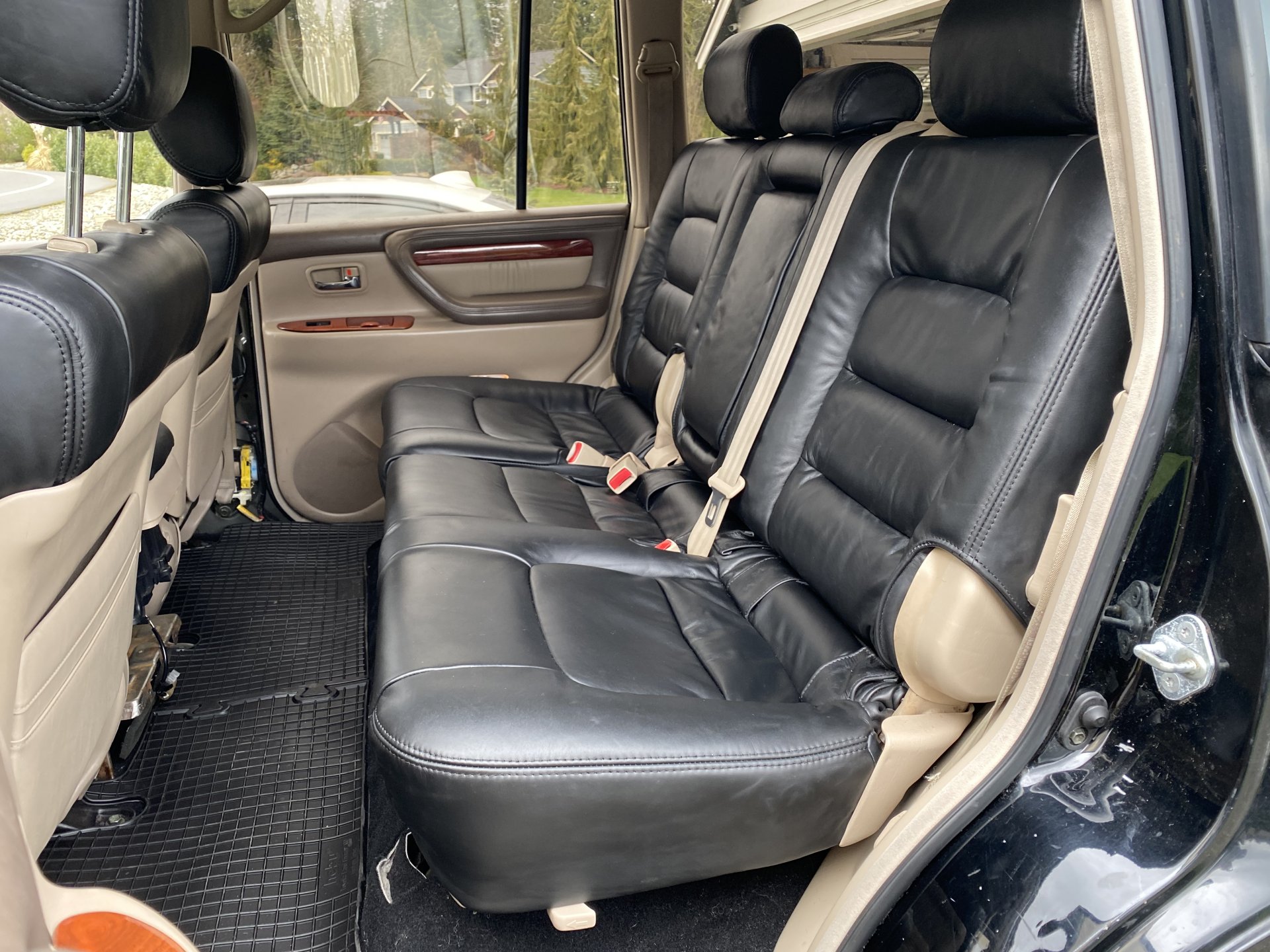

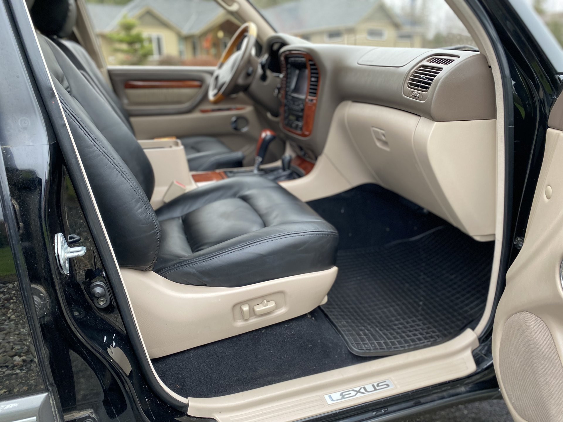

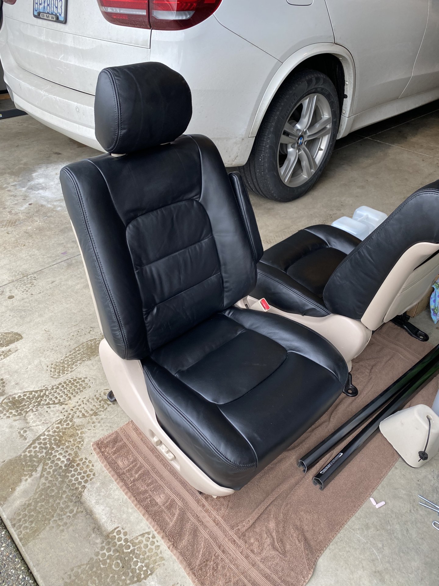

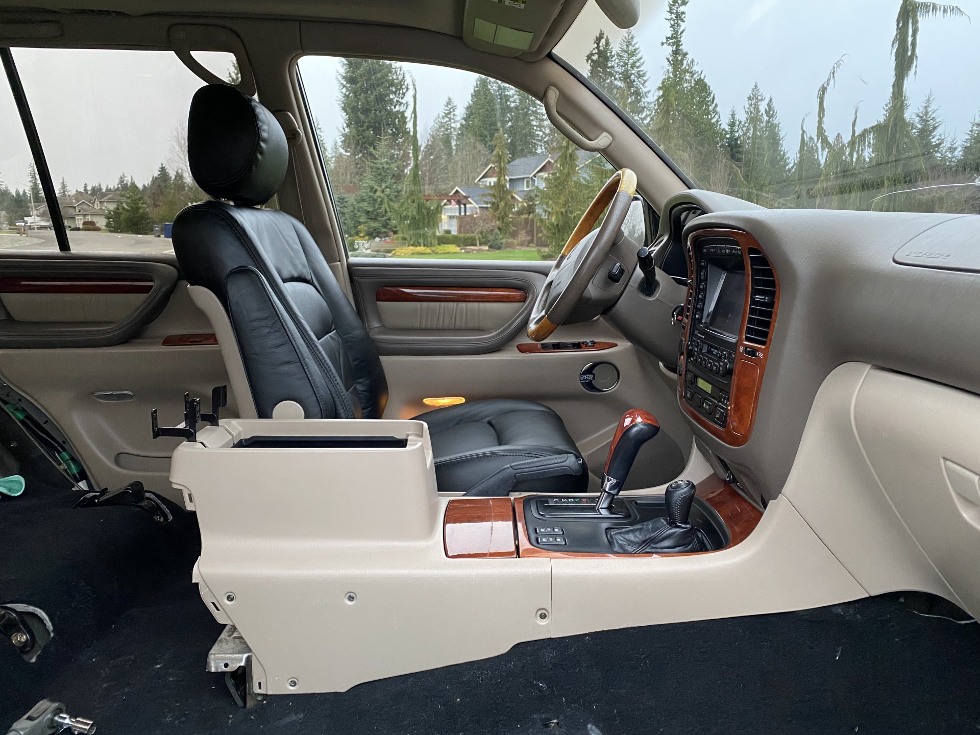

Installed the 1st and 2nd rows. The leather is looking better and better everyday and I’m very pleased with how it turned out.

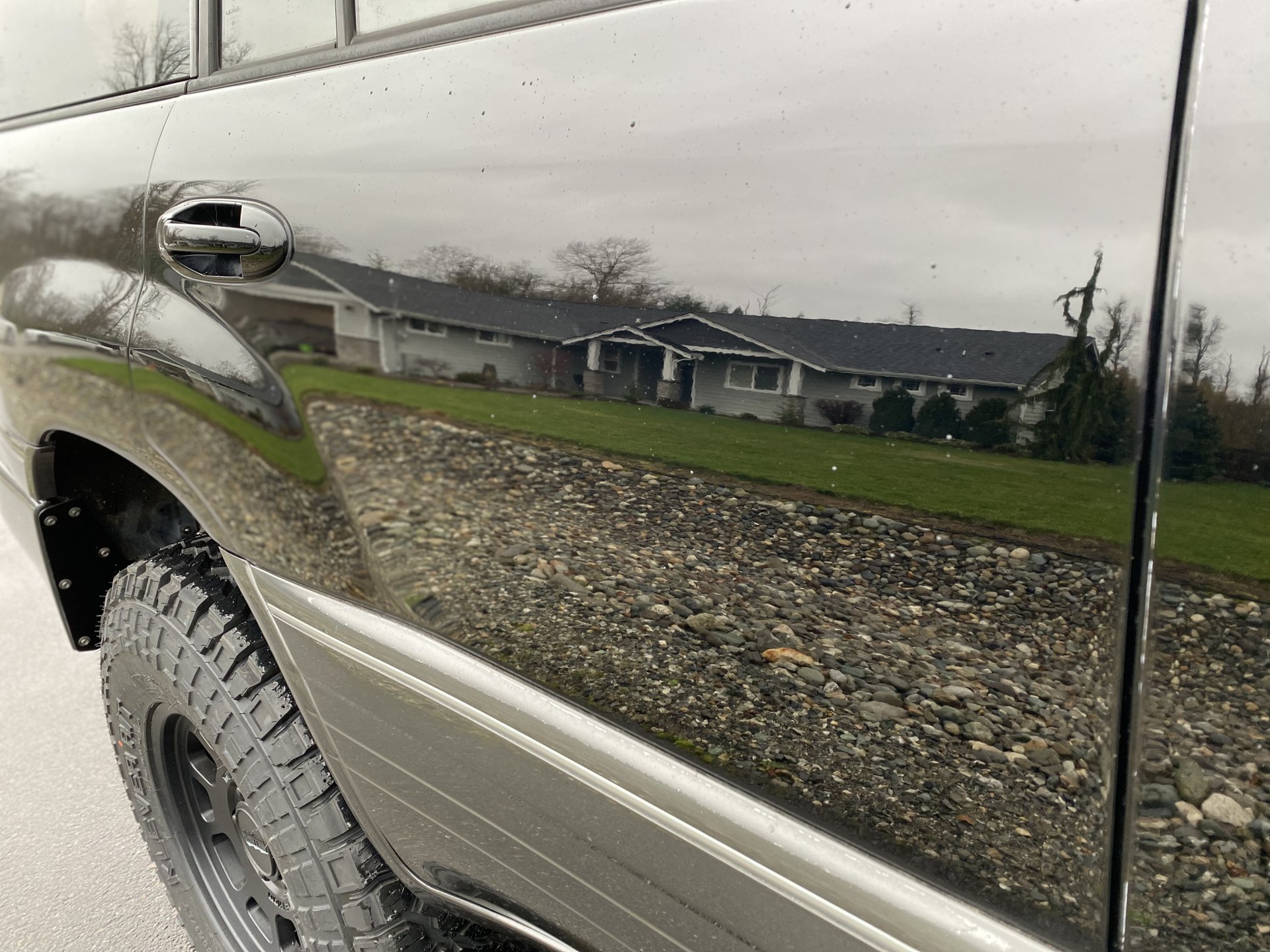

Went bigly today. Clay bar and wax.
Used griots correcting cream with orange pad which took about 3 hours.
Finished up with griots finishing coat with black pad which took about 30 minutes.
Lexus paint is so much better than Toyota, based on my experience.
The paint isn’t perfect but for a 20 year old rig is looks amazing!

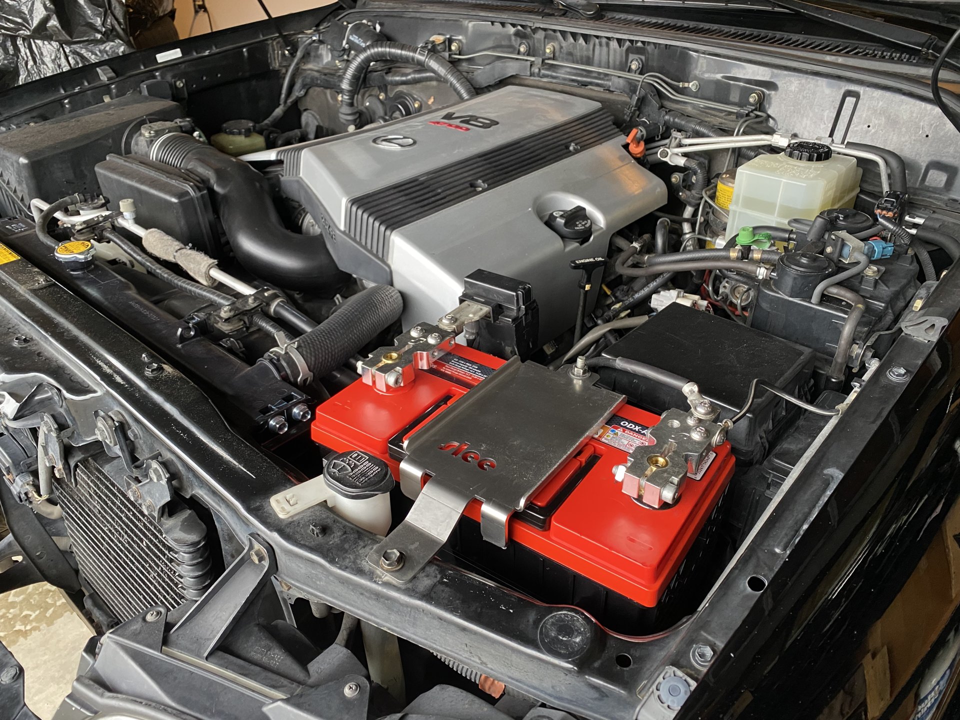

Forgot to post final pic of the group 31 battery set up which was around $750 with tax for the complete set up lol

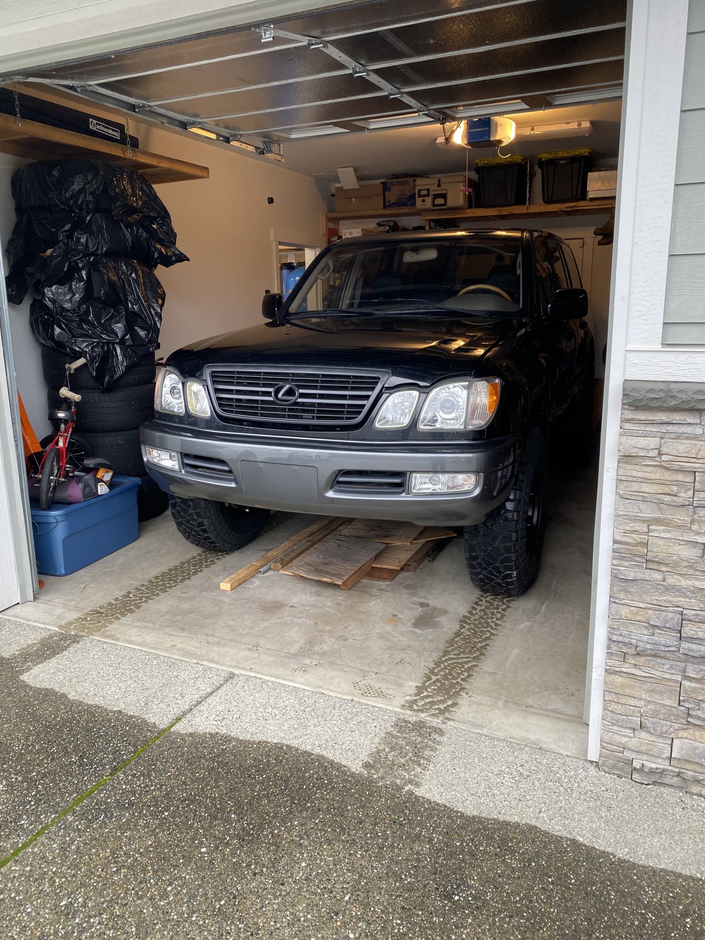

Pic in garage where she’ll sit till it’s towed for alignment and until sold :(

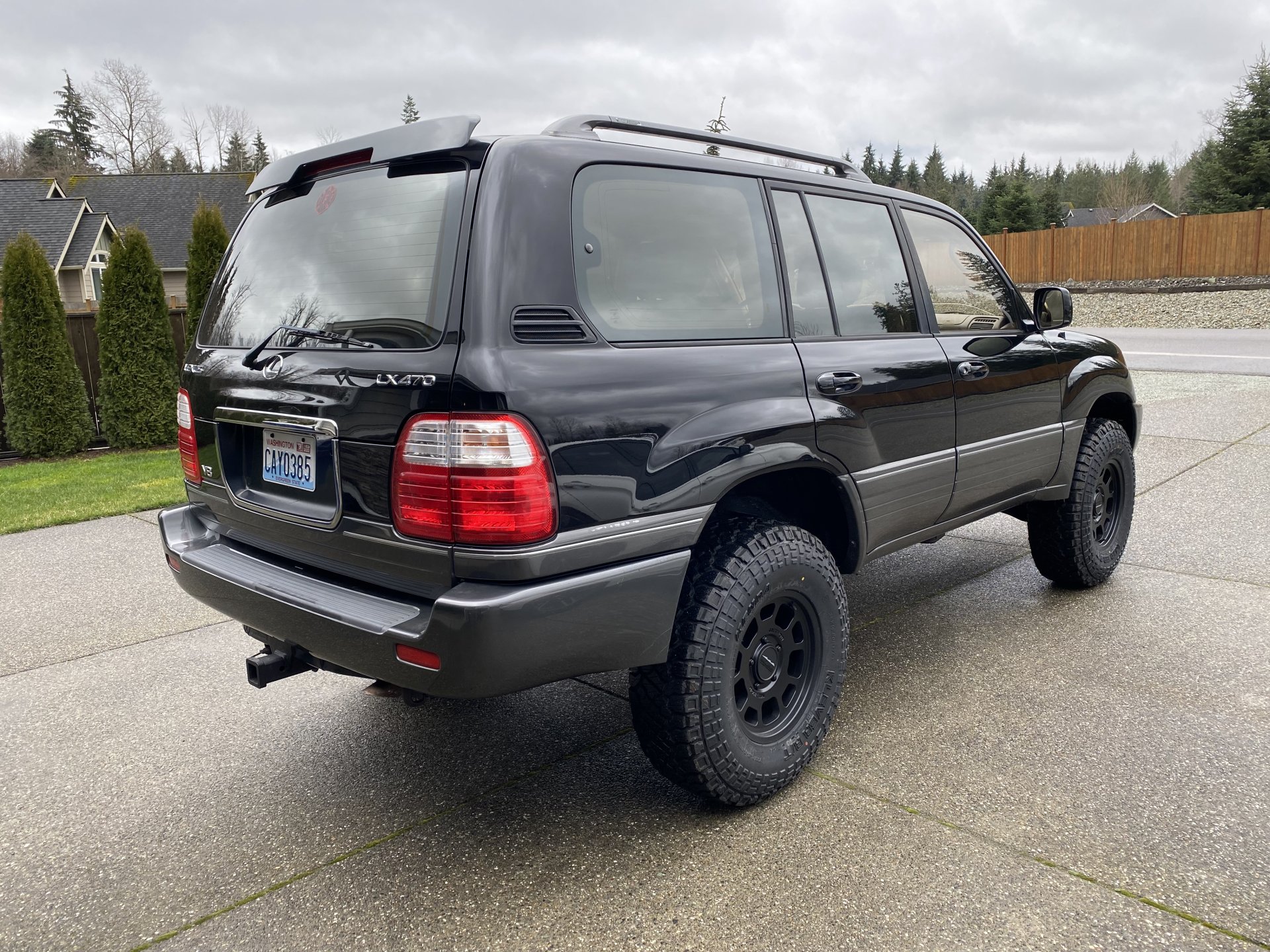

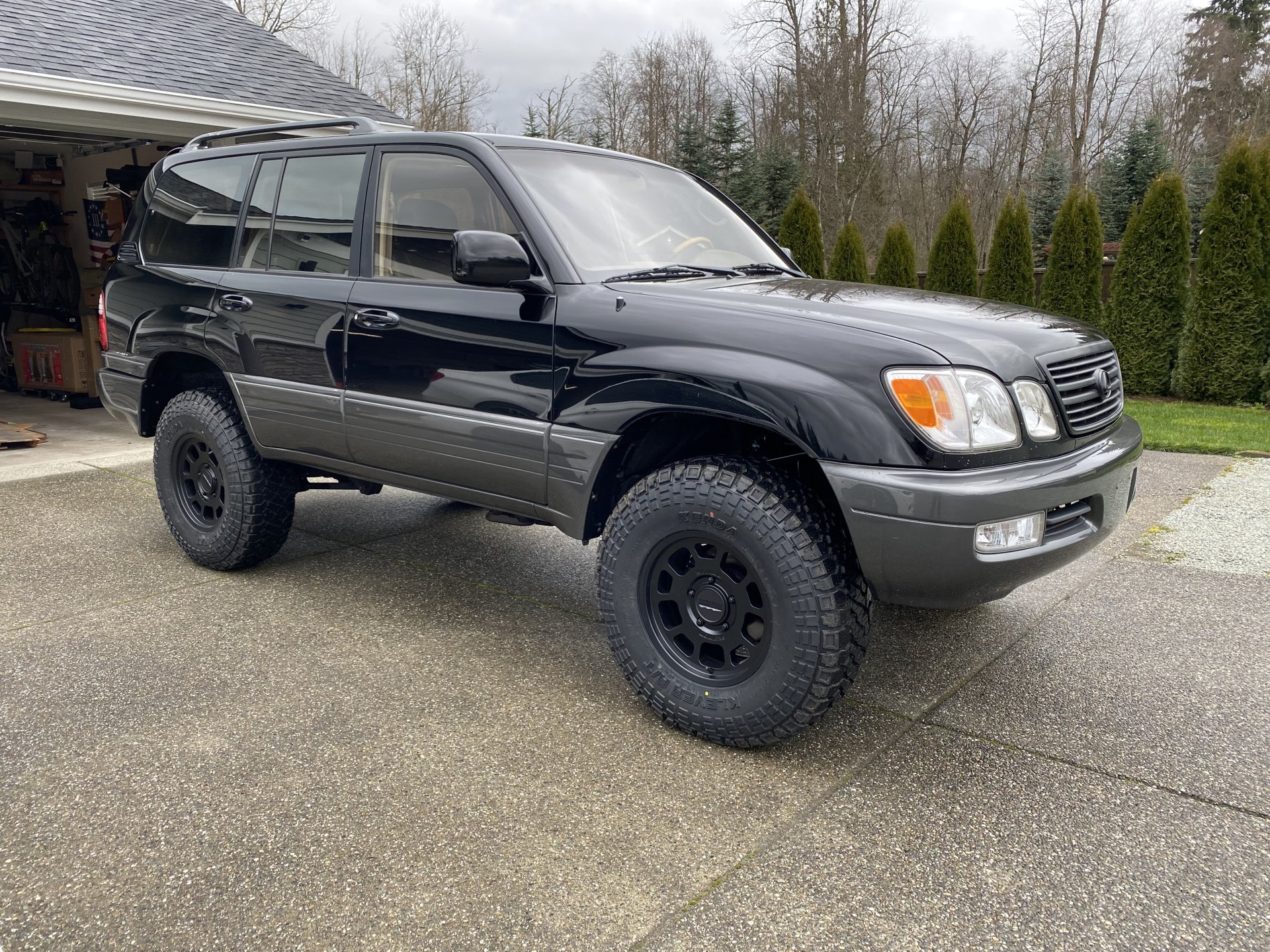

Installed OE painted roof rails.
Driving her today to a buddies house that’s an hour away.

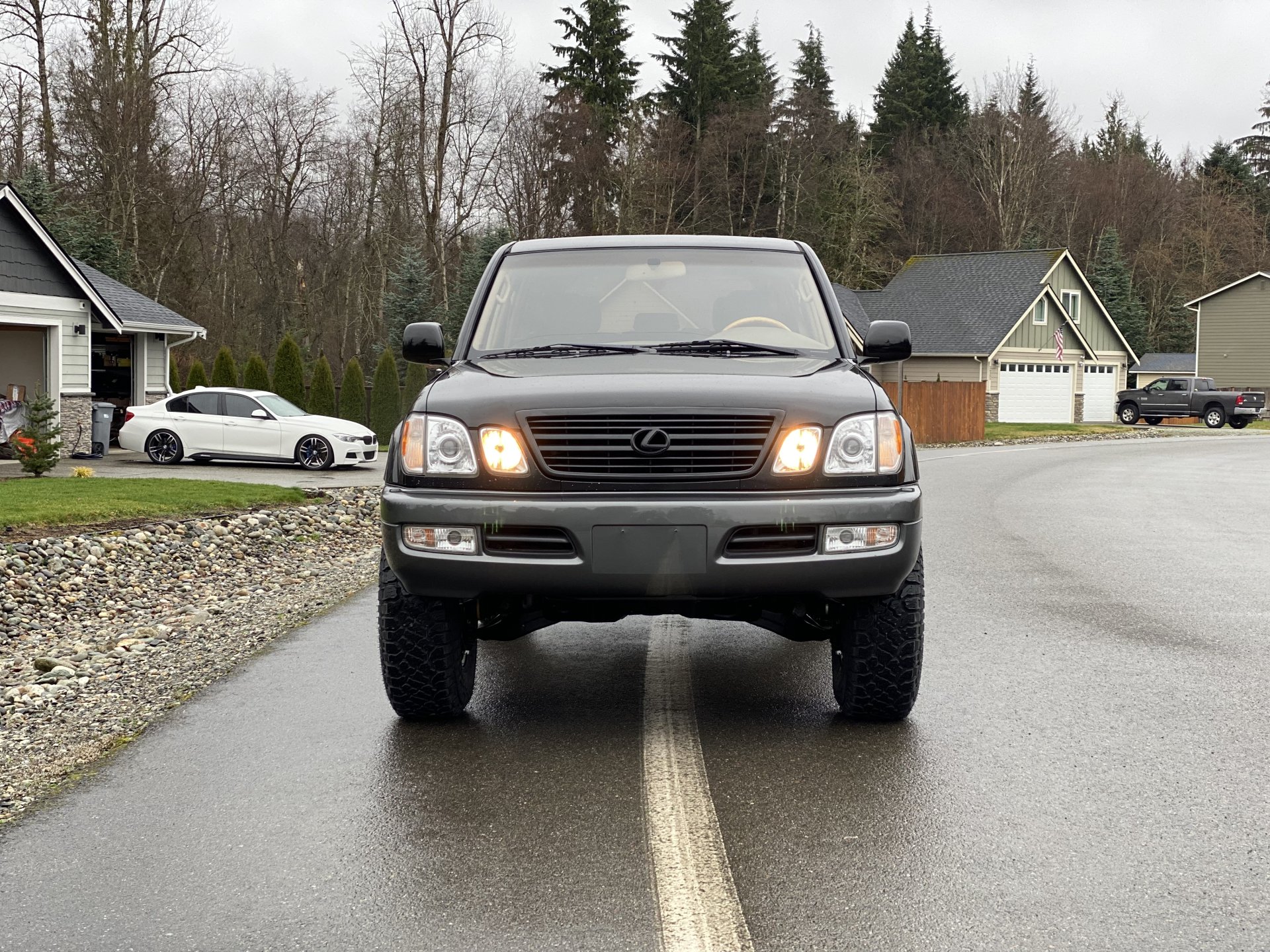

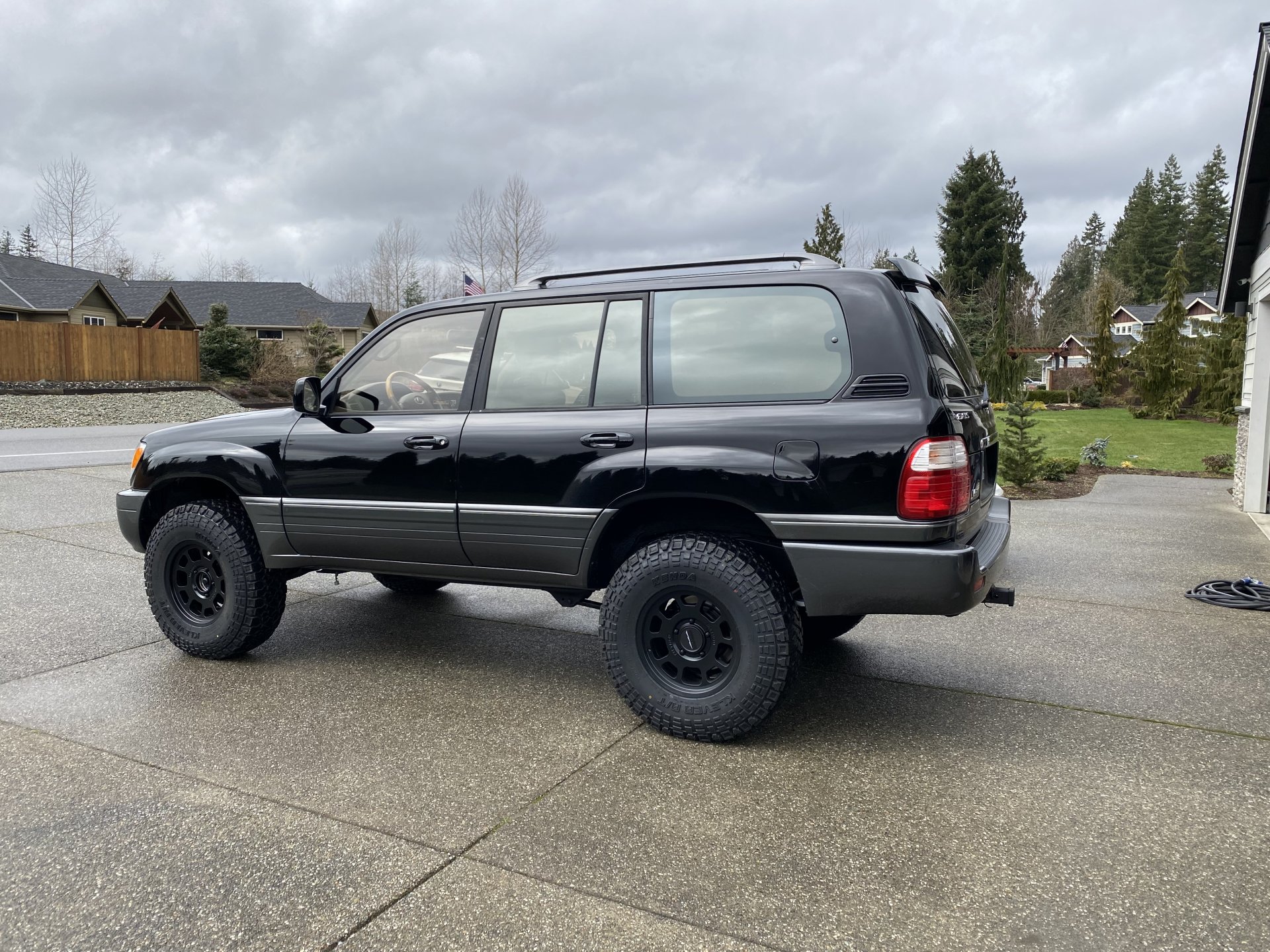

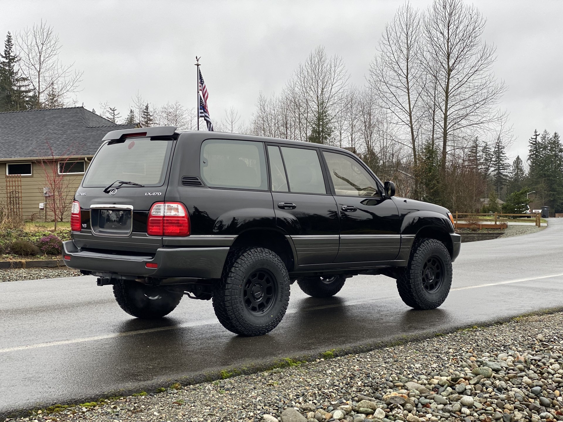

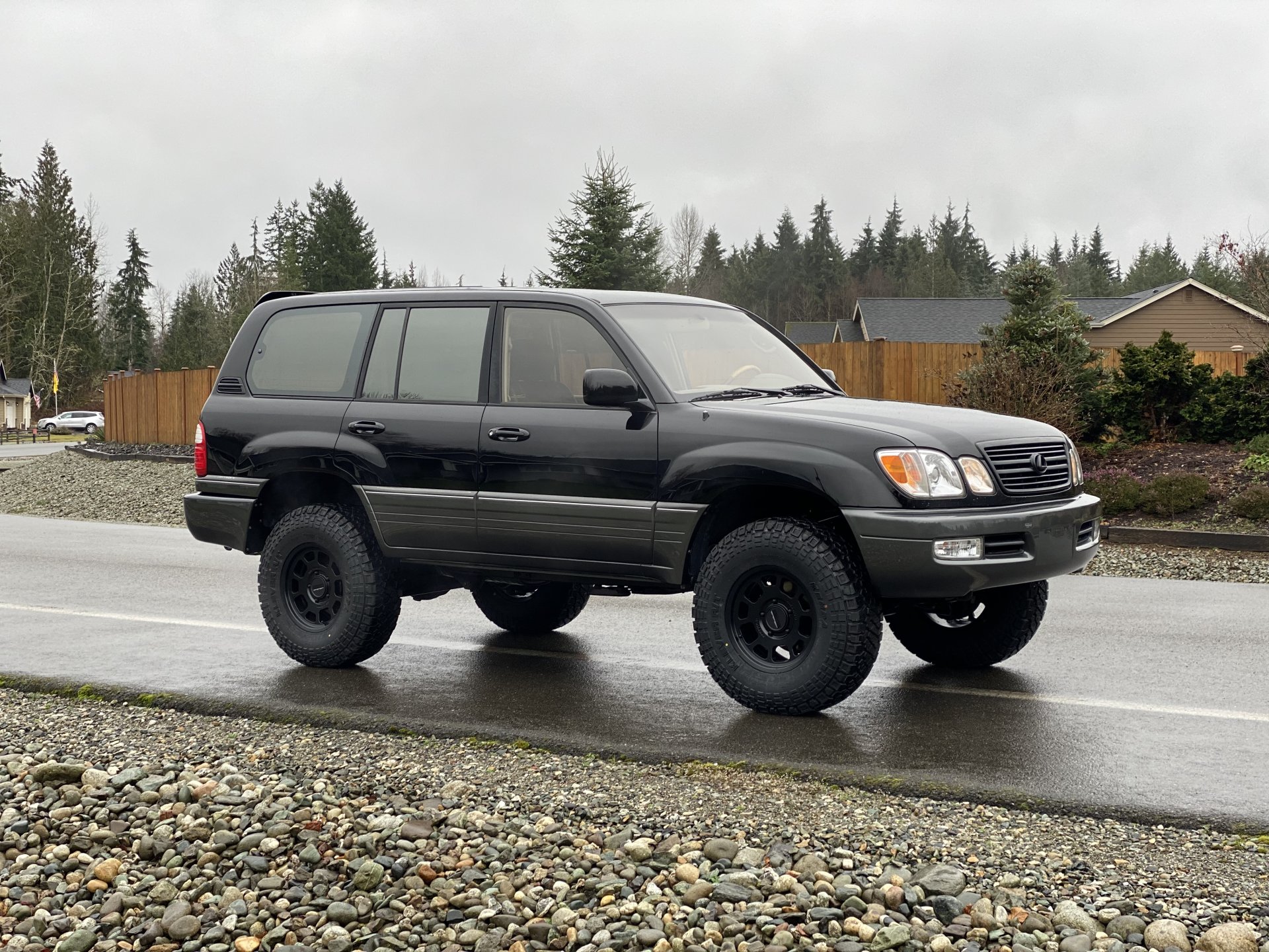

Couple pics from today, just getting back so I thought I should take a pic.

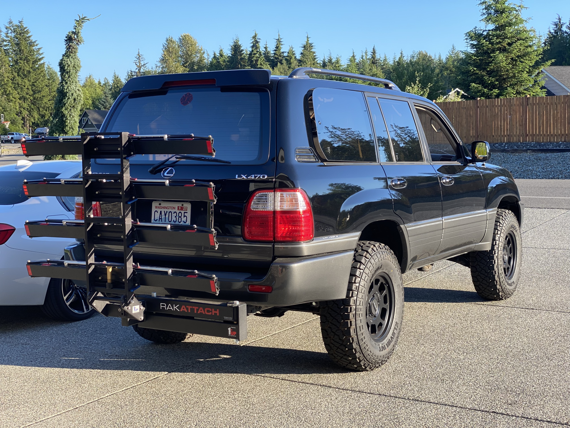

Great thread! You've got me inspired to freshen up the old bike hauler!

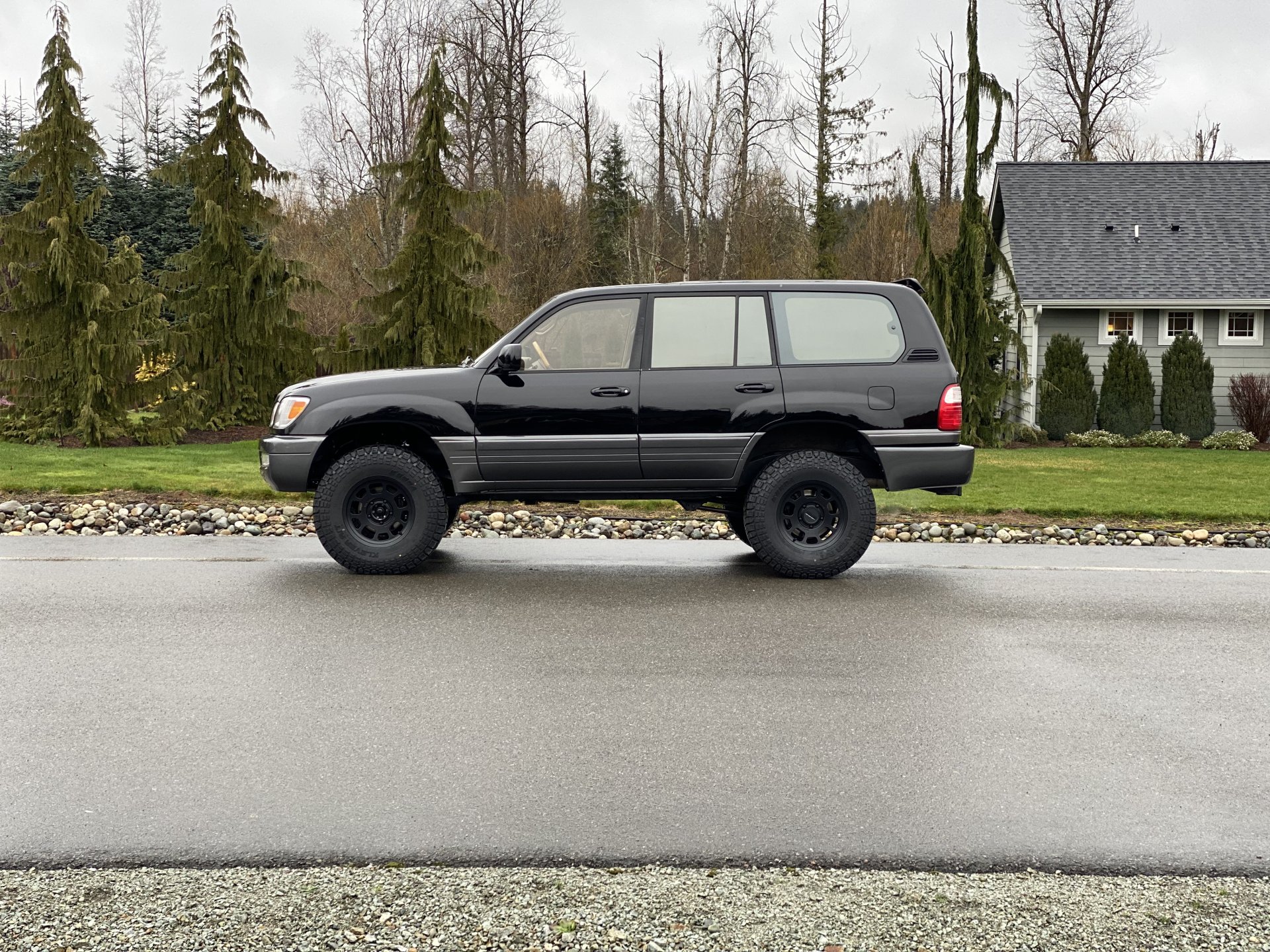

Took the rig on a several hundred mile road trip and there were zero issues.
My wife even said it was better than our X5 diesel for road trips haha
Over large dips on the freeway going 80 the suspension soaks them right up and is very compliant on the road.

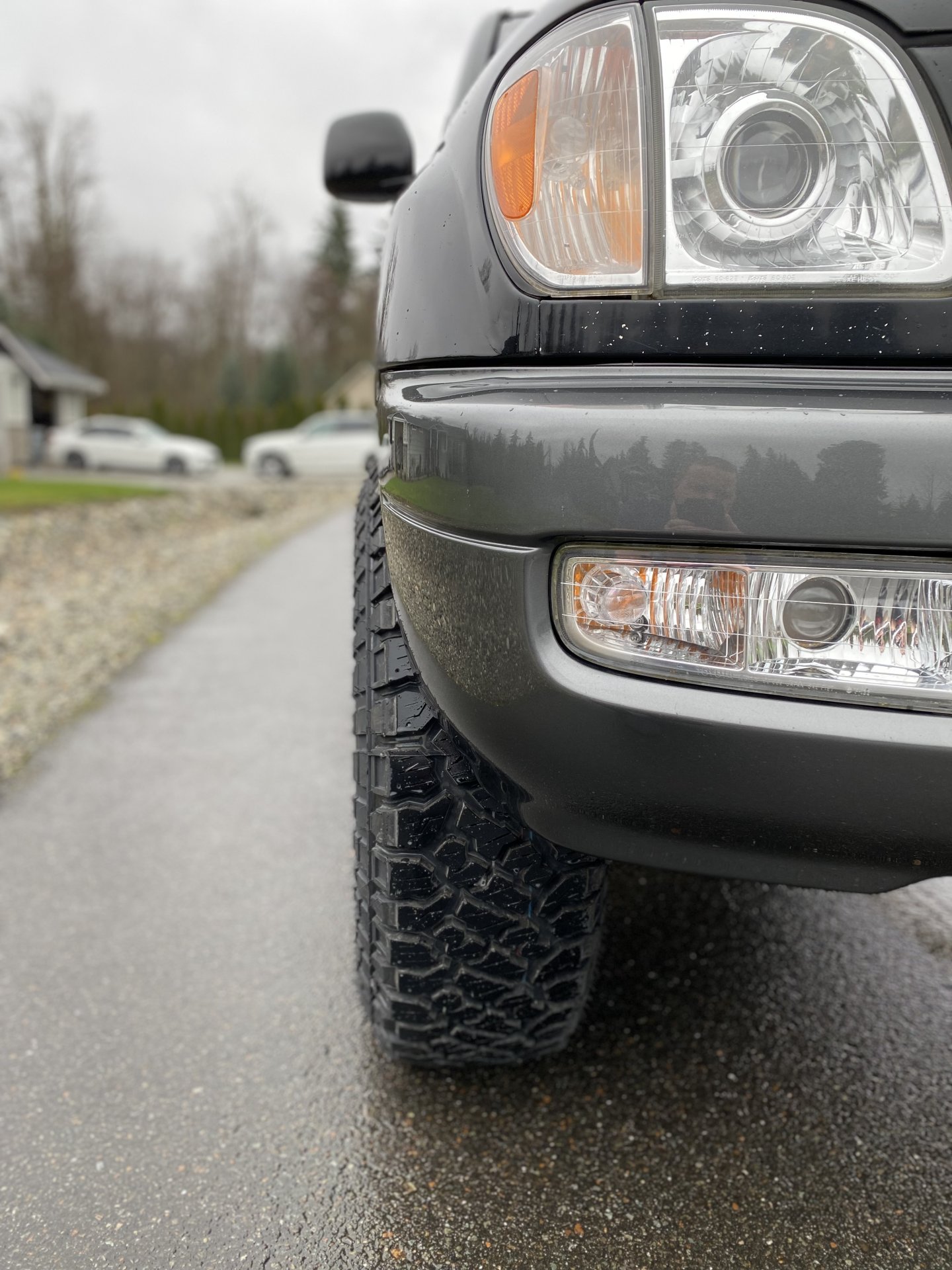

Dont have an approximate MPG with the 35's yet but its better than 10 so far and thats with me driving with zero conservation in mind.

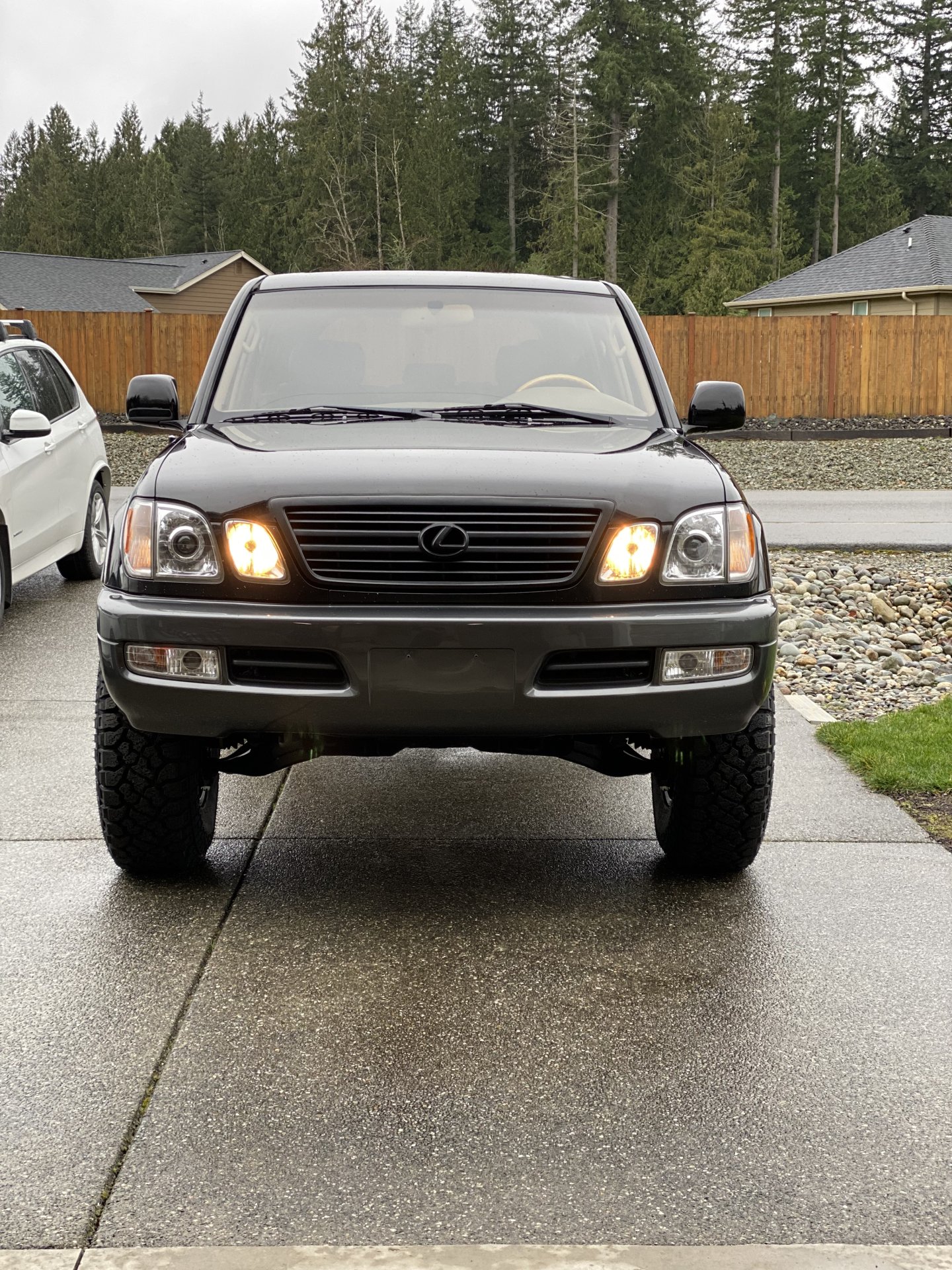

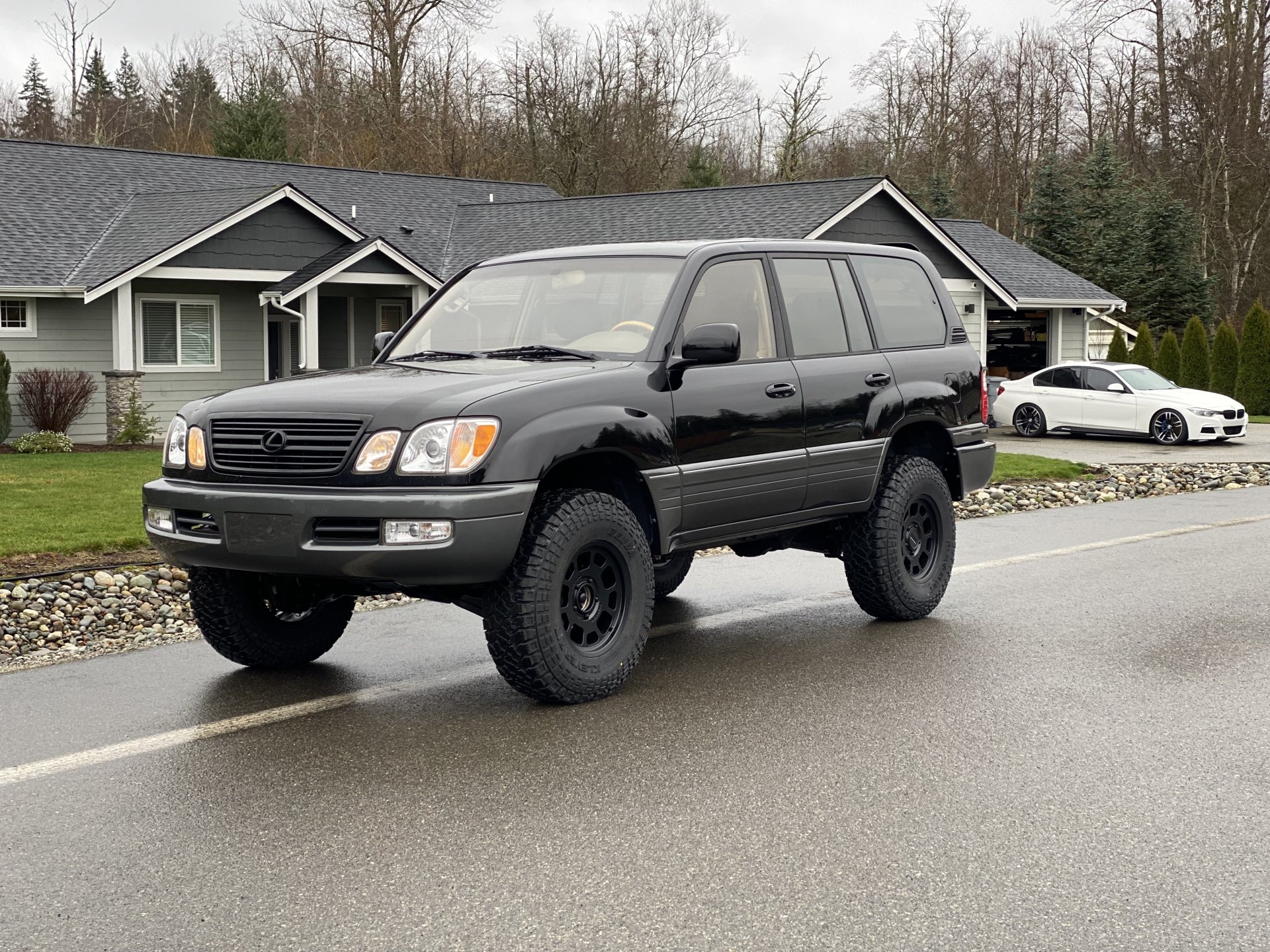

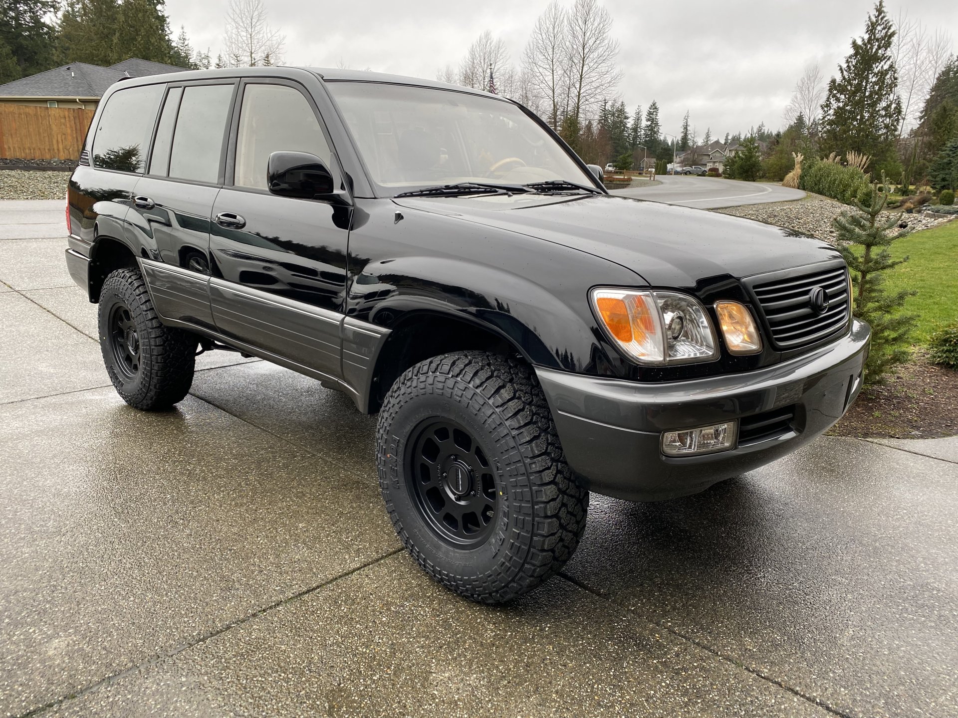

Pics below of the rig are taken after a fresh coat of Griots Carnuba hand applied wax :)
All that is left is the manual climate controls and stereo install.
