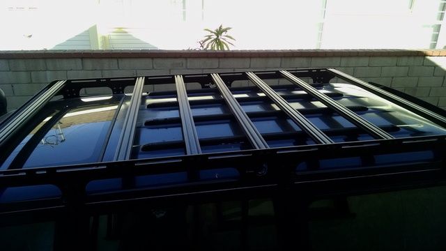

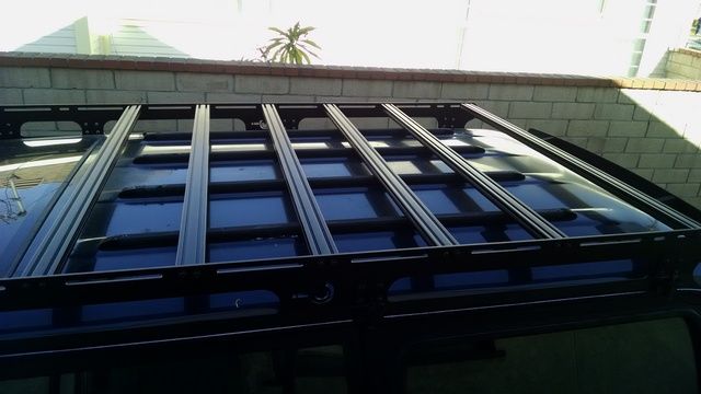

My installation notes and review of PrinSu Design Studios roof rack
My gutter feet were capable of bending the gutter with out deforming... something must have changed.
Also - did yours not come with rubber boots for the exposed thread?
Mine:
Received mine about a week ago and finally got it installed.

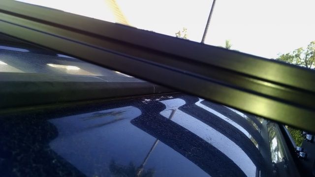

I experienced the same problems with the gutter mounts bending as mentioned above. I have emailed Zach about this. We'll see what he says. Great rack otherwise! Love how low profile it is.
Another note, I removed my gutter trim and it seems to have given the gutter mounts a little better angle....

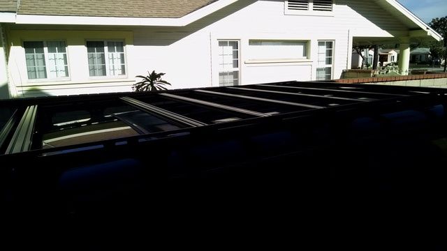

Installed the PrinSu about 2 months ago. I echo all the comments previously mentioned. clamps are a little weak, but the fact that it is one continuous foot in the gutter should make up for it. No instructions, it would have really helped to have thought about putting the air deflector on the nuts and then sliding it in the rail. I did in fact almost go insane.
I really love the design. It looks nice, fits well, is light, low profile and strong. Here are some picks loaded. I did not notice any issues carrying this semi heavy load.

Mine came with the rubber caps too, but once the clamps deformed, the threads were too long for the caps to fit. Rather than cut off the excess threads, I'm going to make new brackets and then see where I end up.
