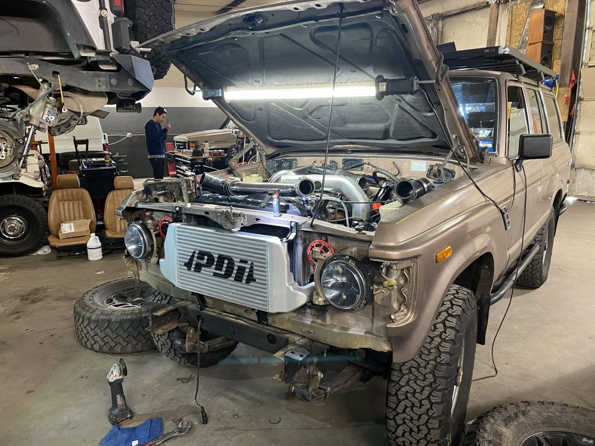

Hat's off to PDI AU for their 60 series intercooler --- after the install I did a 300 mile / 480km run crossing some mountain passes to check out her new lungs.
First video is on flat/rolling hills freeway at 65mph/105kmh :
Second video is going up a long incline:
Result: I am thrilled - the highest EGT temp I could reach going up a long incline in 5th gear was 854F / 456C!
I'll turn up the fuel a smidge next week to keep her from catching a cold.
Currently at 1/2 turn in on off-boost and 1/2 out on on-boost.
