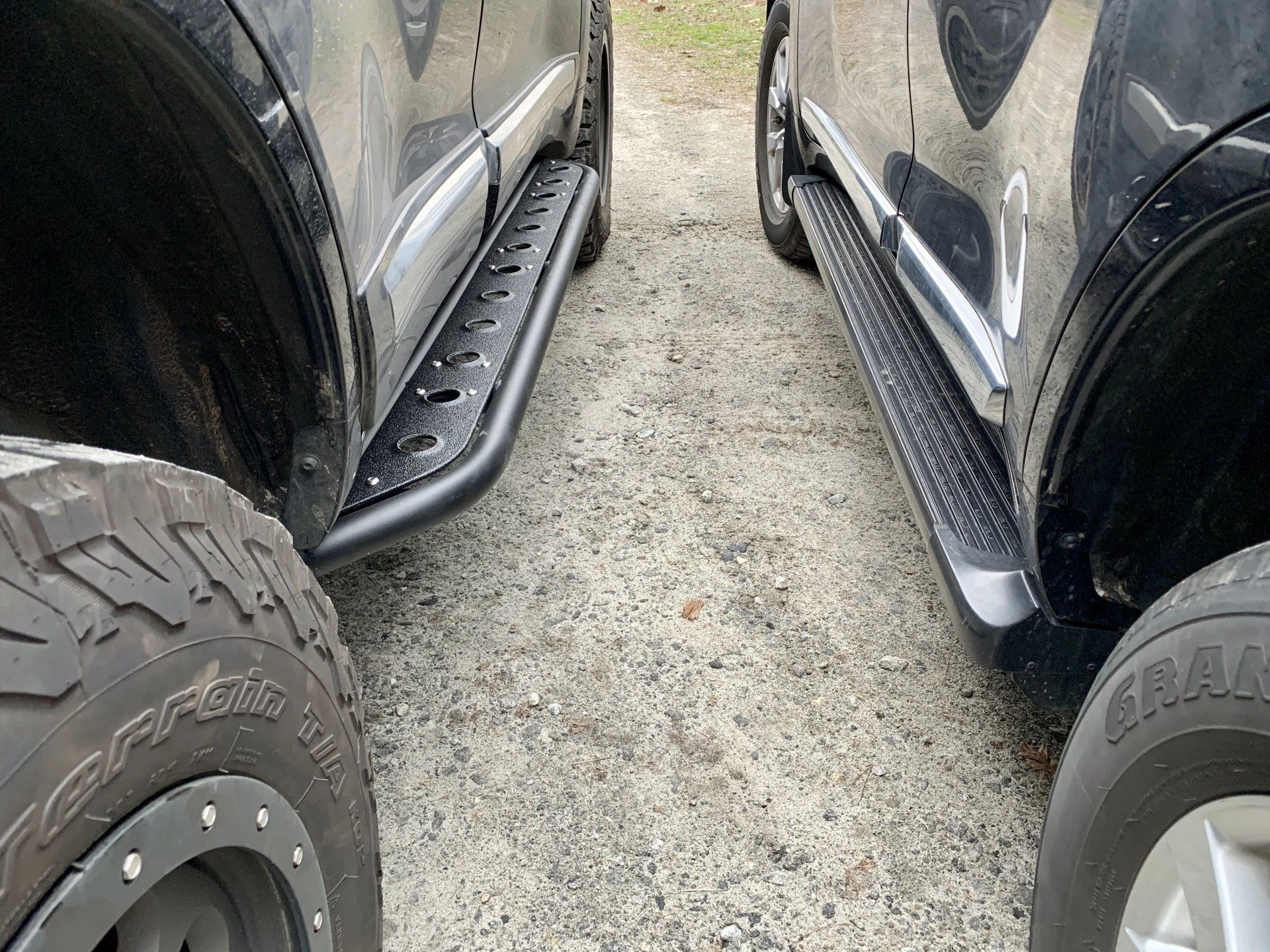

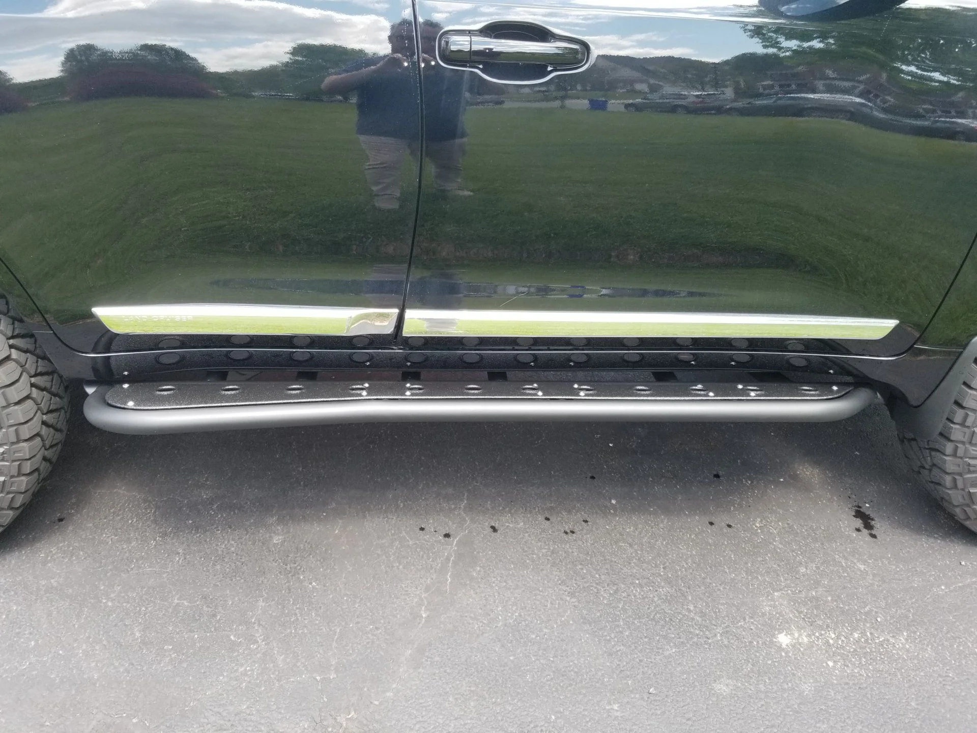

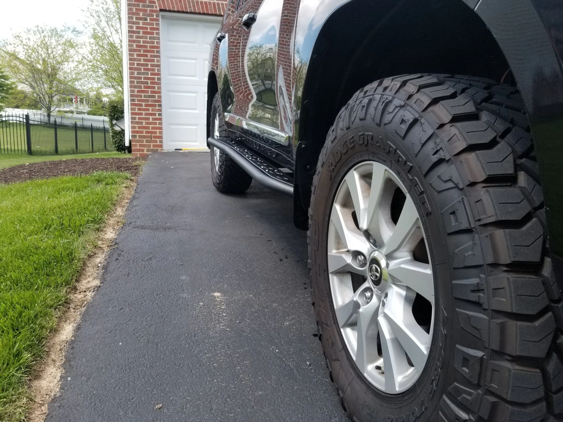

Sliders are now on. 3/8" is so thick, good lord. Please excuse the car (mid atlantic pollen + black == :( )
They have a nice subtle upslant, that should help slide off rocks. They also make the large side steps appear much smaller. Overall I was expecting them to be a bit more obnoxiously large, and they are not at all. Very happy so far. Now I just need the trails to open back up!
What’s your lift setup?
Nothing overly fancy. Basic Icon 2.5" lift, and 285/70/R18 Ridge Grapplers. Stock 2020 OEM rims (so no offset change). Basic alignment (nothing crazy as it pertains to caster). It rubs a bit on full lock in reverse, but nothing that really bugs me, or I can't drive around.
Waiting on the manufacture (already ordered) of Bud Built SS Skid Plates, and Updated Dissent Front Bumper (with bull bar, Comeup seal 12.5rs, and rigid fogs.) It takes a while to get the boutique parts, but it's worth it. My BB sliders, and shock guards are Brick s***house level!

Looks great Chris! Did you by chance install your tires before the lift? If so - any issues fitting them then?
Nope, I did them at the same time.
I'd bet that size Ridge Grappler w/o a lift is in the Tire Database (200 Series Tire and Wheel Size Database) as it seems to be a very popular size. I didn't look it up though.

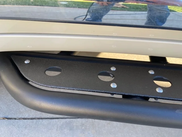

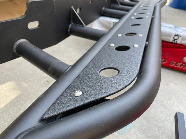

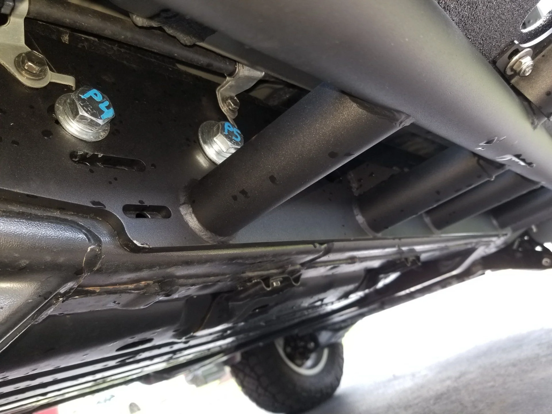

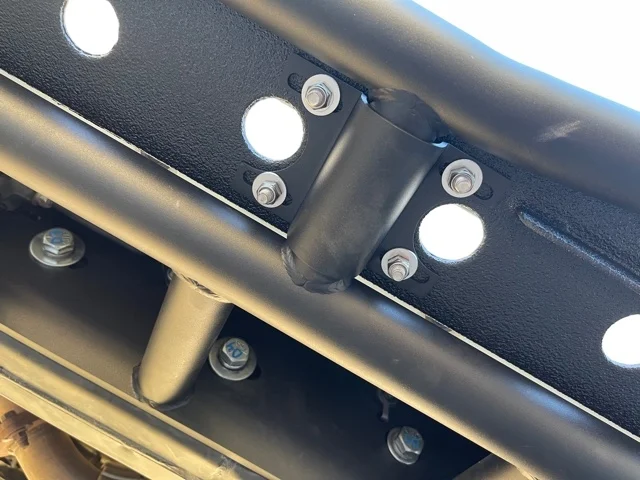

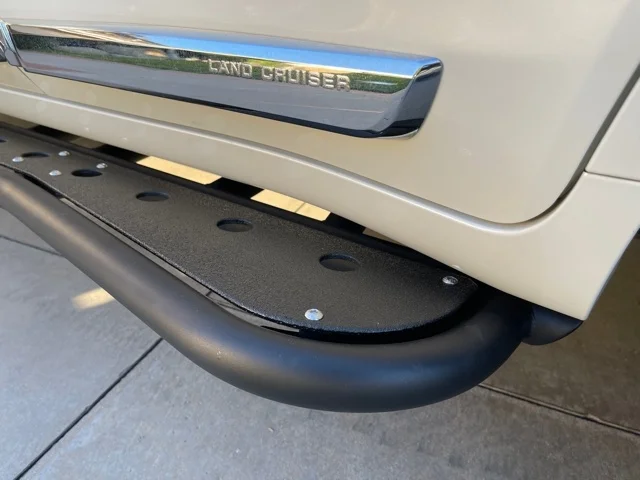

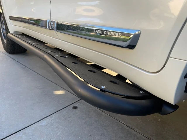

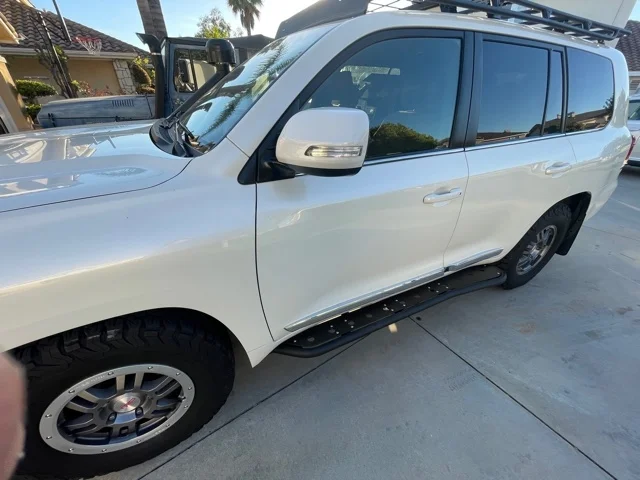

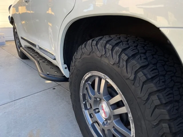

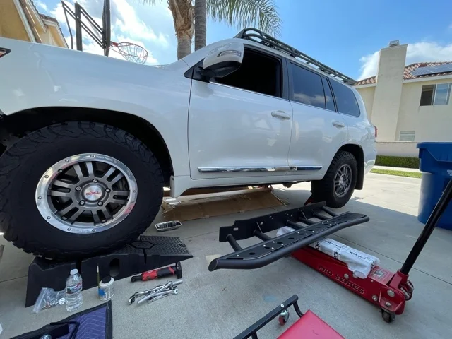

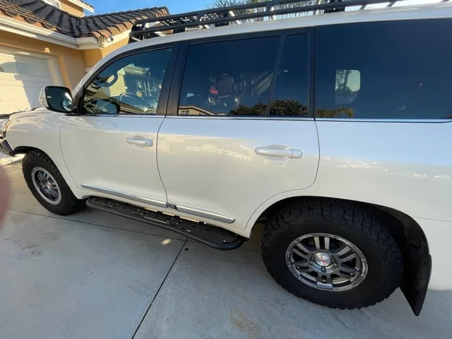

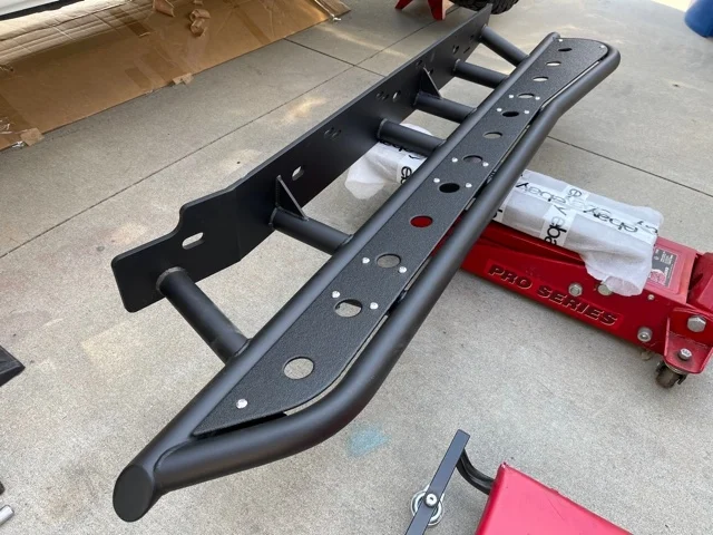

I finally got to complete the install of BudBuilt .120 DOM Rock Slider, non-dimpled (flat with holes) removable fill plates~ Rhino lined 🤙da-bomb👍 I watched the install vid by @Taco2Cruiser right here>>> youtube- BudBuilt LC200 Slider Installation, and again I watched it for the second time on my iPad as I was wrenching and doing circles on my creeper. Hard work 💪for sure doing it alone "solo style" but not too bad (easy to so-so) of a DIY install in my driveway. It took me around 6-7 hours to complete taking my time, watching Rob do the install, pausing & rewinding a whole bunch... It was a 👍👍 install experience plus I got to see and learn more about my 200 being underneath the cruiser most of the time.
Thank you Rob for creating that vid... Also thanks a bunch for the special build with the Rhino-lined fill plate-- I LOVE IT and can't wait to go rock sledding ;)

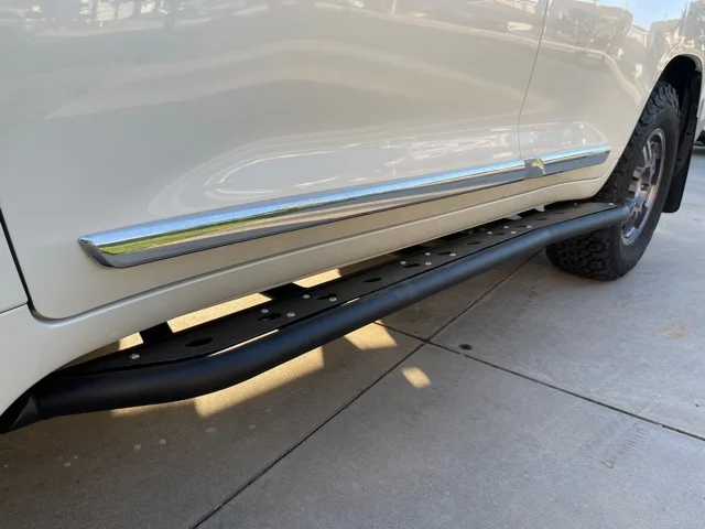

What is the purpose of having it kick out like a 90's Nerf bar at the rear?
The kickout is great for tight rocky spots, it helps pivot the cruiser around the rock or tree or whatever... It also makes a really nice step for getting up to the top of the roof rack.
