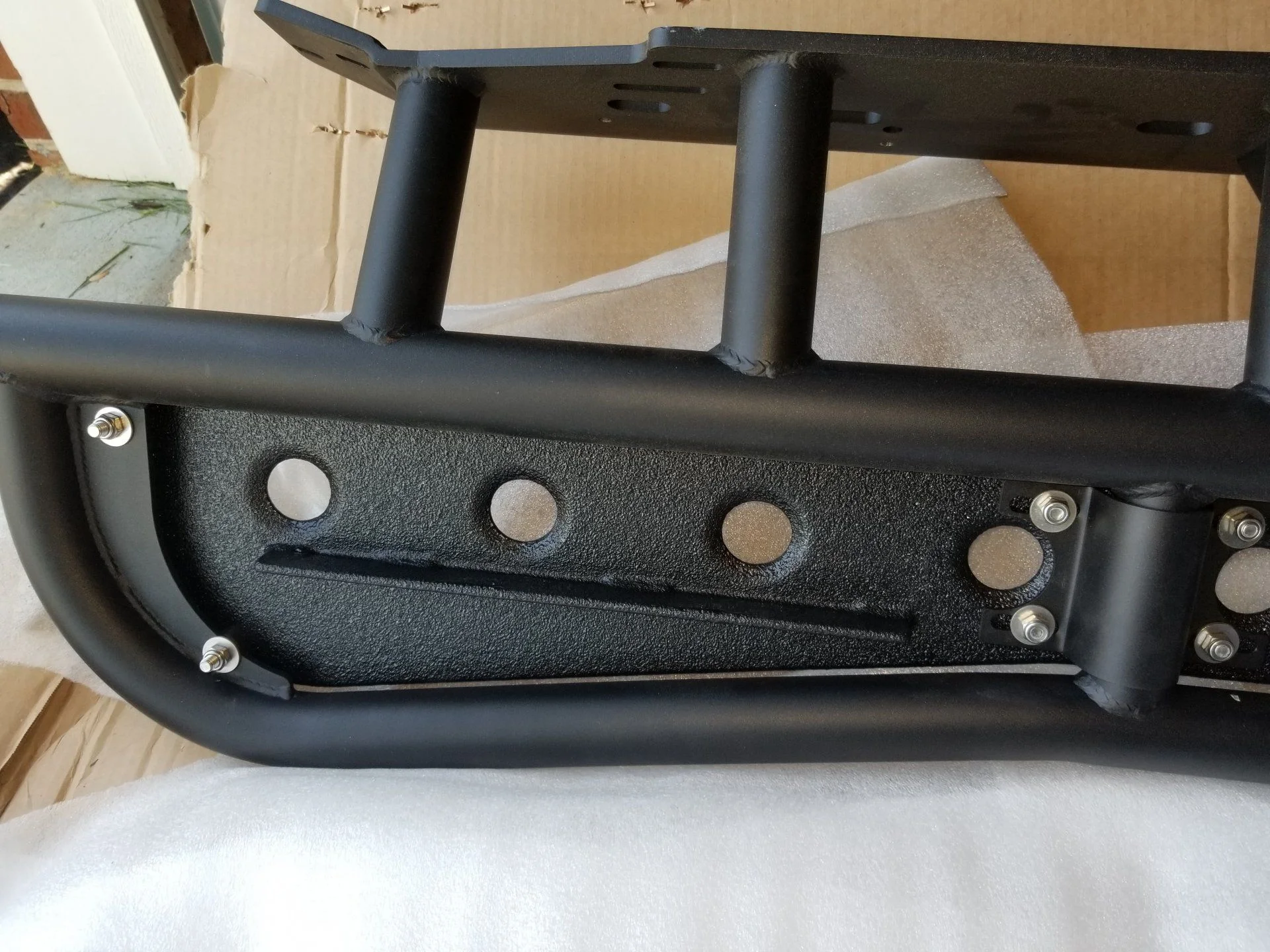

since people seemed interested in how this bolts on. Pics attached.
To clear up some questions up about strength, the sliders gain no strength increase from a fill plate. All the strength of a BB slider comes from the tubing arrangement and angles used.
The bolt in is something that I've wanted to make for a very long time, possibly a decade. So now that I've joined BudBuilt, we started on it about a year ago. These are some of the first to be out there, but so far, the response has been what I taught it would be. A cool option for some, and others that like the weld in. Not like we can't make both.

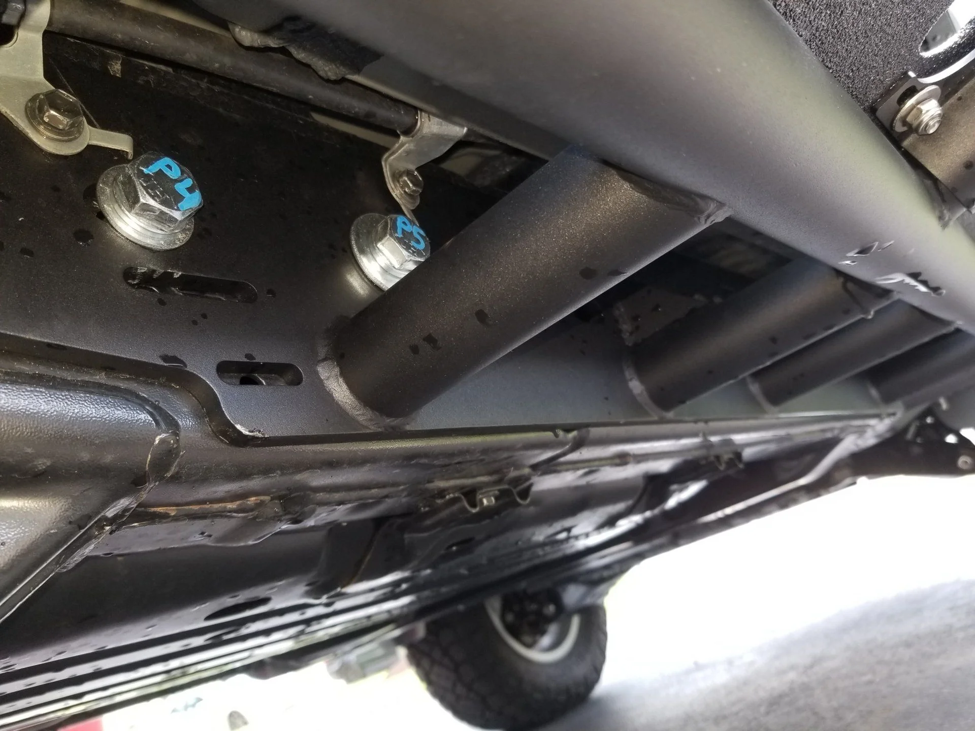

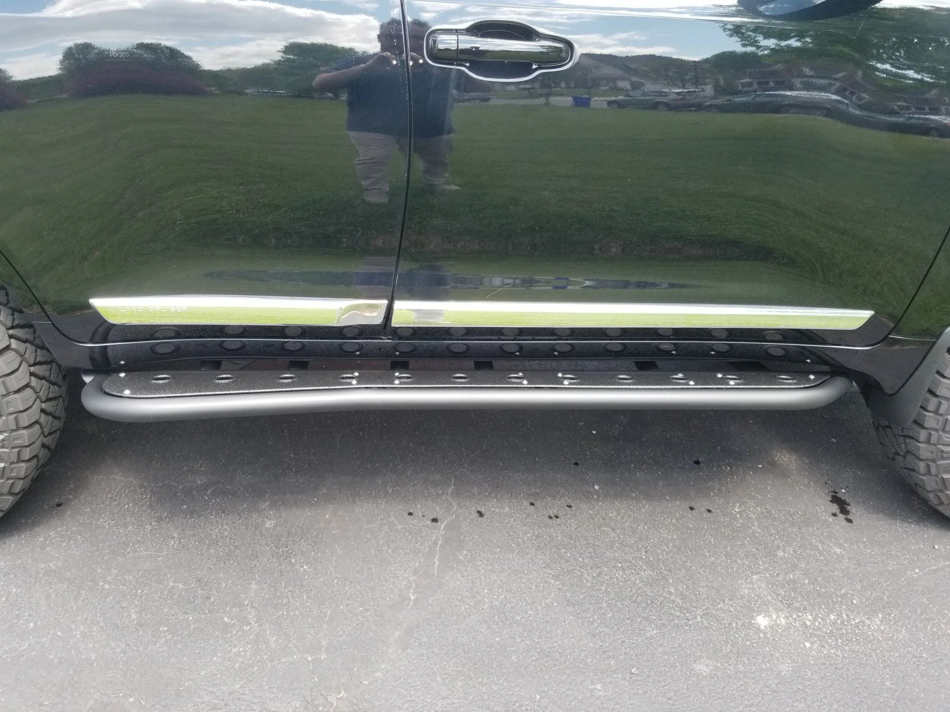

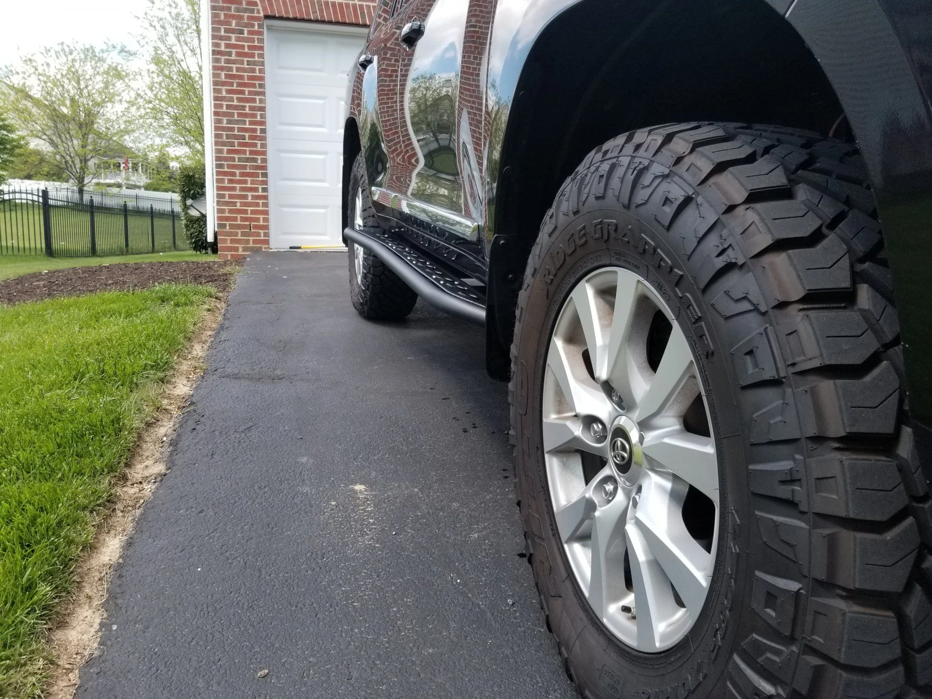

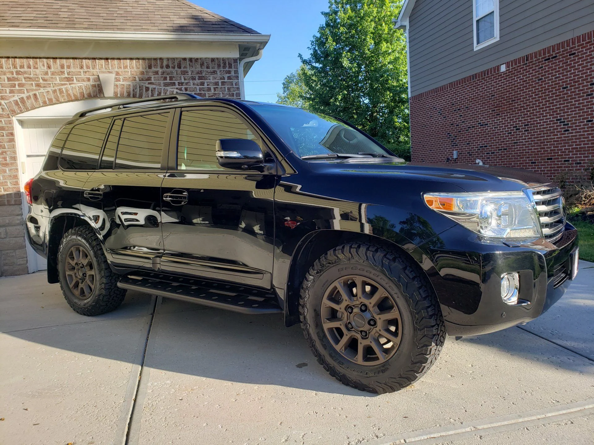

Sliders are now on. 3/8" is so thick, good lord. Please excuse the car (mid atlantic pollen + black == :( )
They have a nice subtle upslant, that should help slide off rocks. They also make the large side steps appear much smaller. Overall I was expecting them to be a bit more obnoxiously large, and they are not at all. Very happy so far. Now I just need the trails to open back up!

Looks great, especially the kick-out.
I don't know if it matters, but it looks like maybe the P5 and P4 bolts are flipped. Since the gas tank is on the other side of those bolts, I was pretty sensitive to bolt length when I installed mine.
