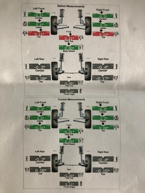

Had an alignment done last week. Big change in the front toe specs. Does this mean the truck maybe hit a curb at some point?
Actually, the before toe alignment looks reasonably good. By some standards, and the alignment seems to vary with model years, it's in spec. Just a touch of toe in which isn't necessarily a bad thing for tracking and stability. I wouldn't say it hit anything. The after touched up alignment is also good depending on alignment standard they were shooting for and what you might be looking for as a driver.

For front toe, it helps to see total toe. Sometimes the steering wheel is just off center which may make one side seemingly way off. Though -.8 is a pretty large number. Wholly possible it got out of whack.

Thanks @Taco2Cruiser. I'll crawl underneath and double check their work. Anyone know if those computerized machines prompt the alignment techs of the specific torque numbers for like LCA bolts and the aforementioned jam nut ?
As i was hovering over the tech it looked like the alignment computer was giving prompts as the caster/camber were being adjusted.
