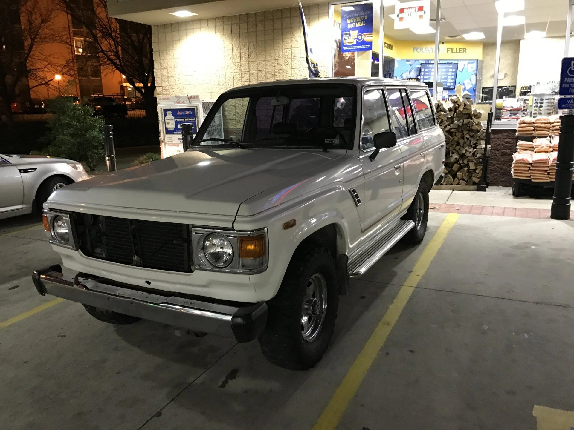

Alright guys I guess this will be my project thread as well.
So I bought the truck, and last Monday I ordered a waterpump (leaking), thermostat, few things it needed such as window regulator, tail light cover, fuel cap, wiper blades, fuel filter, oil and oil filter, air filter, bunch of coolant for a flush, maybe a few other things
That was Monday
Tuesday I lost my job! Horrible timing
So anyway I'm in the project now but I have time and can't yet spend money. Have savings so I won't need to sell my Landcruiser but I do have a mortgage and can't start ordering parts
I'm new to old cars and realized a few things now that I've got a bunch of it apart.
1) I should probably do my hoses while it's torn apart
2) I should probably resolve the power steering leak as well.
Everything is nice and saturated. Is there anyway to diagnose and locate a power steering leak at this phase? Logic tells me to clean up the mess and check for leaks after driving but since the radiator is already ripped apart that's not really an option
What I'd like to do is get a parts list together so when I have income again I can get everyThing I need
Thanks everyone
