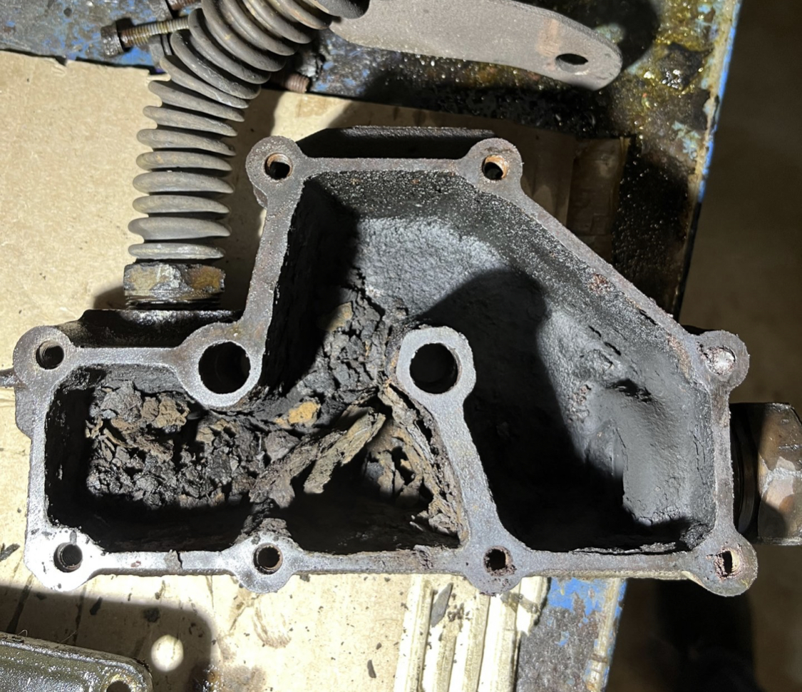

And if it never idled smooth again - the EGR cooler can spit rust rocks into the EGR valve and permanently jamb it open. Gotta remove the valve from the engine to clean it out.
@CruiserTrash has an epic photo linked below

Oh yeah, here’s the photo of inside my EGR cooler that @OSS mentioned. Granted, this was after scraping it, but still … nasty. And all that can get sucked up the flex pipe with engine vac when the EGR valve is open.
