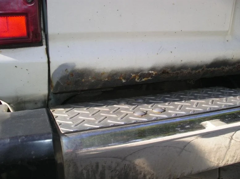

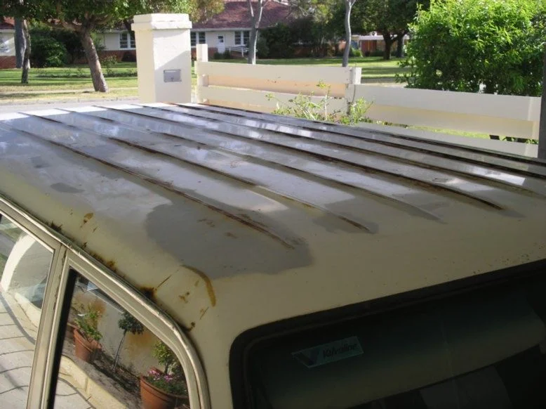

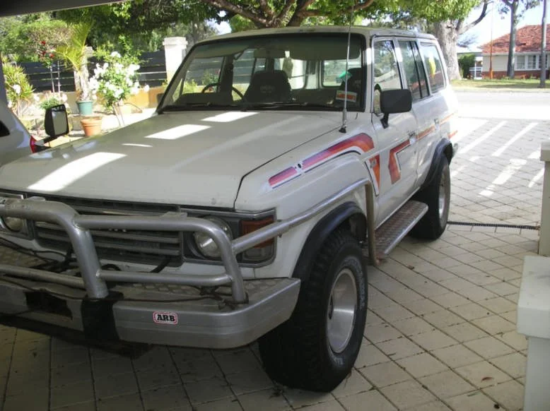

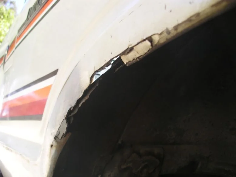

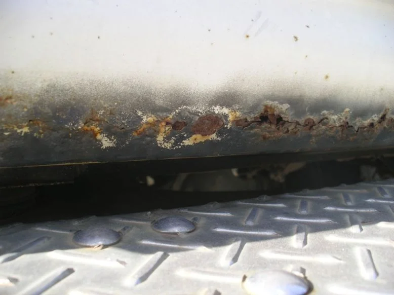

this is my BJ61 cruiser down here in oz. iv owned her for over a year now and decided she'll treat me better when i treat her better. time has come to get rid of the rust, and there's a fair bit! i was tempted to farm out the rust cut but i think i'll be more thorough. As you can see in the following pics, the roof rust is pretty superficial, just some surface rust thats been half stopped by PO. the wheel arches and tailgate are pretty serious and will need a fair bit of attention.
i am open to all ideas, from mild to wild. (sorry!) i am pretty deft with the welder but havent really got much knowledge with auto bodies... I have read "wheel arches gone wild" and that seems like the best idea so far. So any and all knowlegde, experience, products, how-to's, photo's, links and even constructive abuse is more than welcome.

any more pics? I would just get someone to sand blast your hole truck, acetone it down, and spray bomb it army green, I think thats the cheapest best way to do it. If you are going for a more showroom look you will need a real paint sprayer etc. Then you just touch up spots as needed, and even though you don't go through alot of salt CDN winters, go get that old girl oiled, it will slow that rust right down!

the rust doesn't look too bad.
ion the back tail gate measure for a replacement bottom 3" and get it bent up at a metal place.
the roof looks like a good sanding and you should be good to go, except where the patch looks like it was welded in.
the rear quarters lip is the biggest PITA, ask anyone that has done this work. time consuming and frustrating.
love the front bumper and side bars...

I agree , por-15 everything, the whole truck. sandblasting the roof woulf be best, then por.

thats what I am doing now. they make ok panels you can weld in. or glue on, with removal of all the rust and por'd.
you can DIY sandblast and por, then have a prof' do the final spray if you care about smooth paint.
Rocker panel rust can be cut out and a square tube installed. I like that look. Afterwards put some rhino liner on it and you have semi rock sliders. At least non denting rockers......

GD fender flares, probably caused some of that wheel well rot, keep them well greased/ or oiled. From the pics your truck looks really nice, a little body work and she will be mint again.

Whatever you do do NOT sand blast the whole truck or major portions of it. This will lead to a very wavy panel from the impact of the sand particles. In essence it stretches the metal. On large unsupported areas like the huge roof of a 61 or door panels and especially the hood it is very important. Blast on the edges, bottom of doors, inside of pickup boxes, fender lips, etc. Basically anywhere the metal is bent or creased.
If you want to blast, use media blasting - usually walnut shells or something similar. This will remove the paint and rust without damaging the metal.
If you just want to remove the paint, maybe try one of the chemical strippers. If there are major rust holes, cut it out.
If you sand blast the hood, you will never get is smooth again. And you will see it every time you drive your Cruiser.
