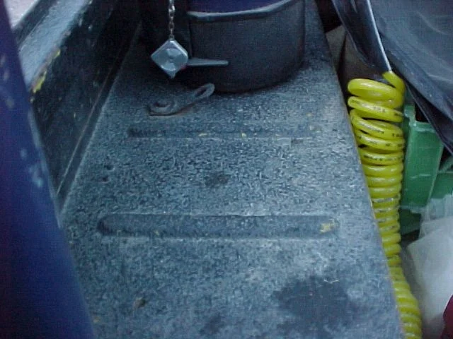

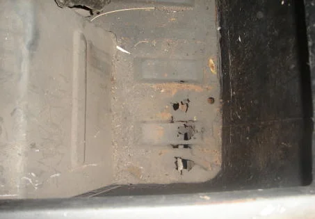

are the holes right at the front wall? if so, i've got three.
ignore the huge rust holes and the square cut.;)

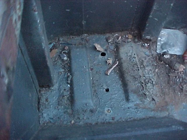

OK, here are the holes in question, there are 3 in the front of each corner.
Also I am certain these are not factory but there are some on the front top of my bed.

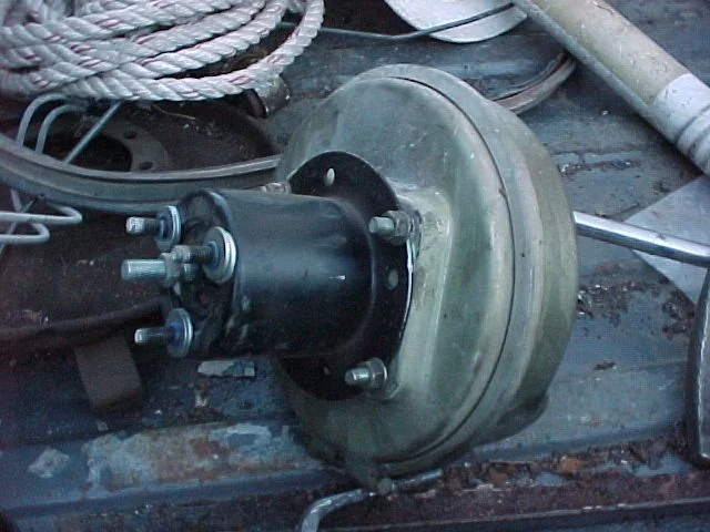

I went to my treasure van today and dug around, and found aMC I removed from a wrecked Camry, I'm gonna give it a shot, it will bolt on with very little modification......and here is the spacer/booster that won't fit....that is an early Drum FJ55 booster....

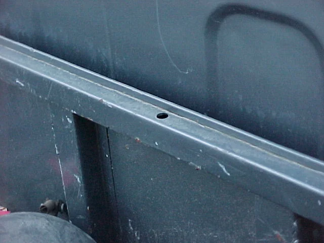

i've got the same drain holes on my 65 that you have at the front of the bed, on the fender, and on the top rail.
also, i've only got the supports on the rear panel of my bed.
Sorry no camera here tonight, it's on loan to a teenager right now but here's an old pic of my bed on the truck. the holes you see are stock, can take more pics once i repo my camera
