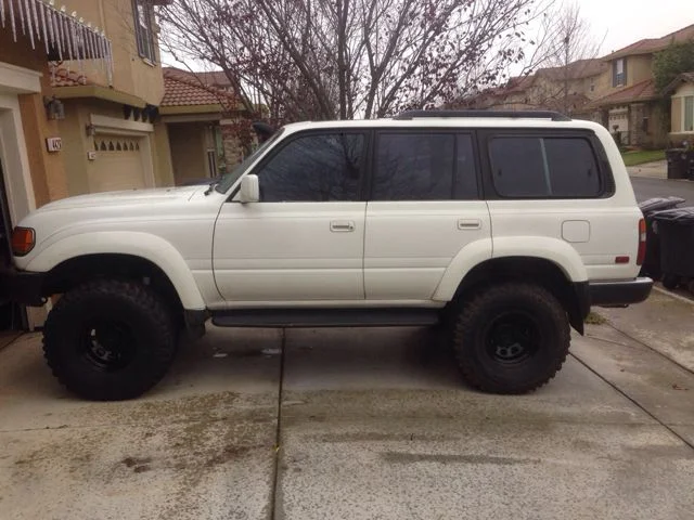

Finally I was ready to do something fun. I ordered up some old man emu springs pro comp shocks. Metaltech 4x4 sway bar drops castor plates, and iron pig off-road track bars[
ATTACH=full]1007125[/ATTACH]
What a fun project and I can't wait for more
