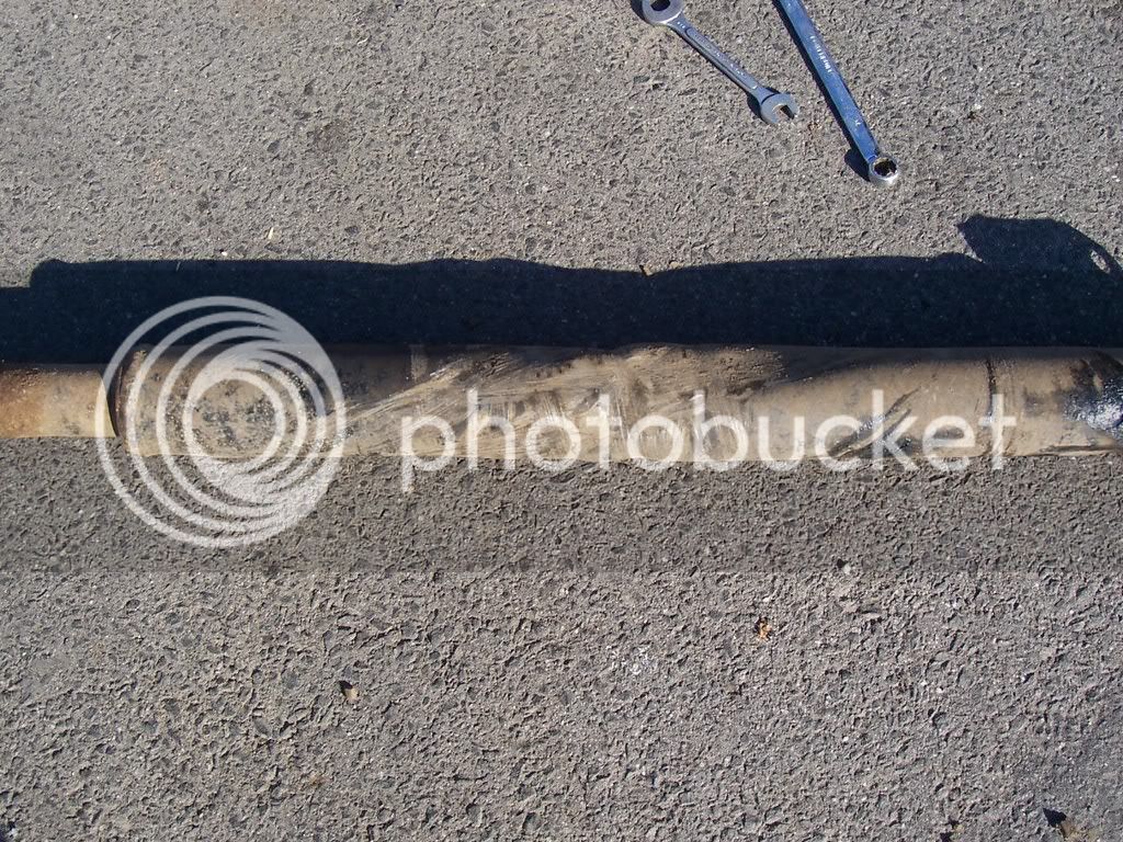

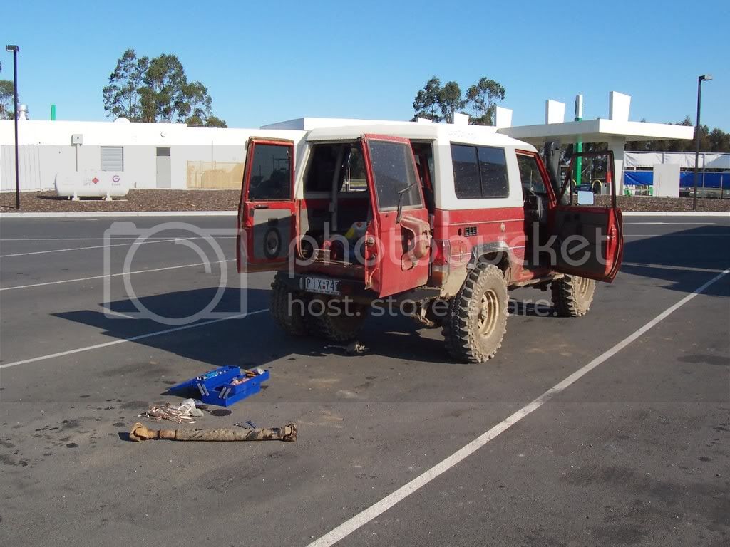

Had a great day out 4x4ing today, but toasted my rear tailshaft, question is, is the FJ73 middy tailshaft common to any other models? like a 45 or 60 or something so I got more scope to look for one?

P.S pics of dead one
HTF did you do that?:D
I think that will be unique to the 73/74 series
Nice job you did there. ;) You must have been laying flat out on the belly on the rocks to get that done....

Hit this massive rock in the centre of the track, the whole driving to the side of it didnt work, so when it came my turn, didnt want to winch so gave it some berries and came up trumps! launched it.... hope the video turns out good was a wild ride!!
I think i might end up taking it to a driveshaft place and getting a new thickwall tube put on it since not many ppl wreck 73/74 sereis cruisers
called pretzeling your driveshaft.
i done a few like that over the years, the best was coming out of a creek bed in the winter in a FJ45 and the rear driveshaft took the load as the ass came out. i cut off the factory tube and replaced with a piece of 1/8" wall pipe, worked REAL nice, balanced up beautifully and STRONG. i would suggest you do the same.

Going to call up some places today, Hardy Spicer and Dana arent far from my work, hopefully then can cut off the tube and chuck a thicker one on. If not i'll get a 60 series one which are common and shorten it.
Driving in FWD sucks, car handles really strange and bucks around when taking off ahahah.
