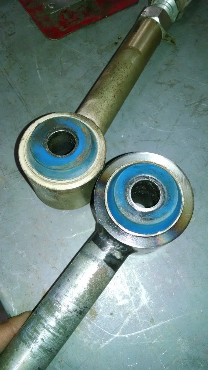

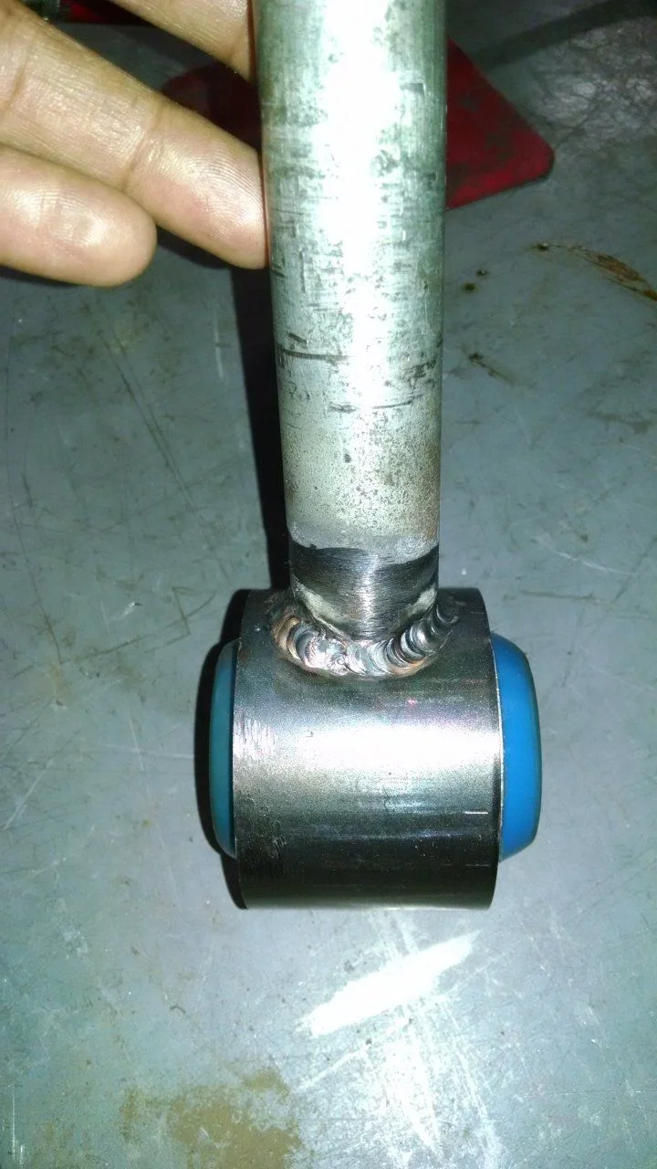

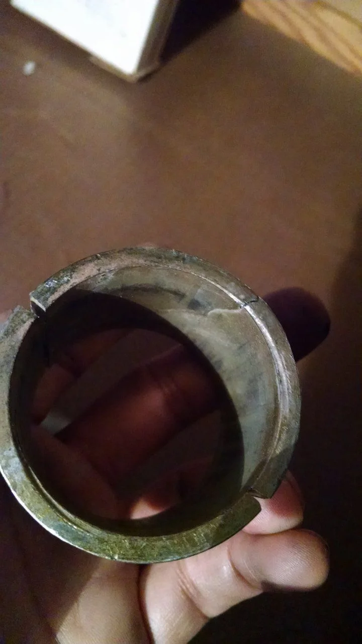

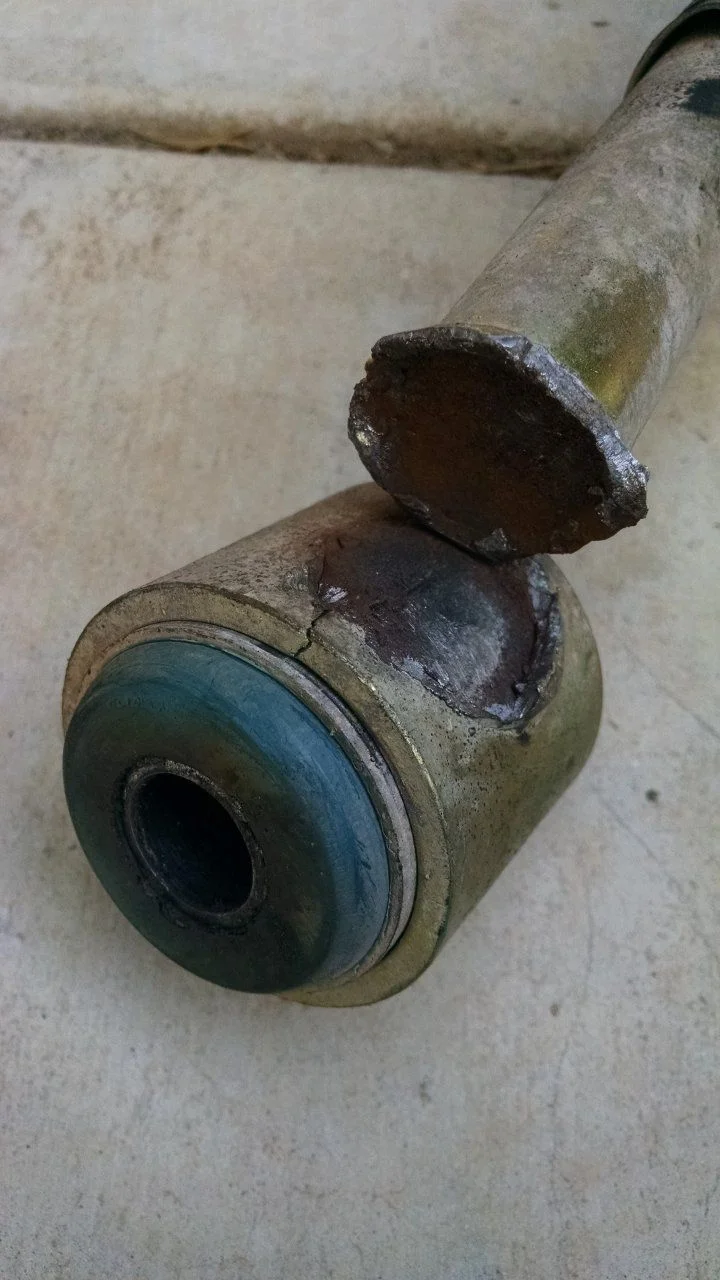

Well, it turns out that I did have some carnage that didn't make itself known until recently. One of the rear Slee upper control arm separated at the weld, probably for some time, but was just about to let go. This didn't become apparent until a short run to Puerco after work one day when I heard a "clunk". It's all good now and I'm very thankful that this didn't happen during the Blanca trip.
New bushing eye is much beefier. You can see how the old eye has a deep crack. One of the pic below is comparing the old one to the new one.
