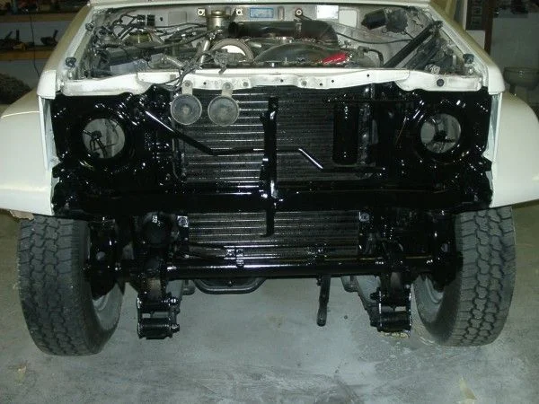

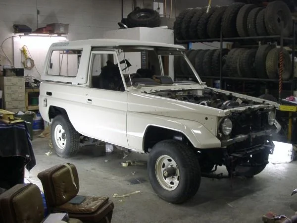

Painting today
WHOO HOO :bounce: :bounce2:

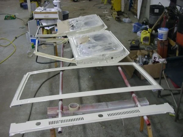

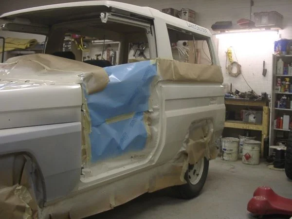

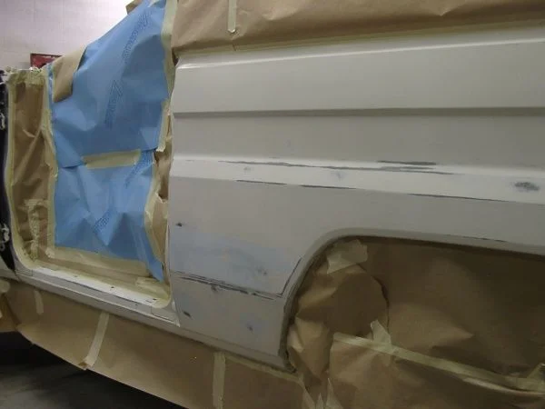

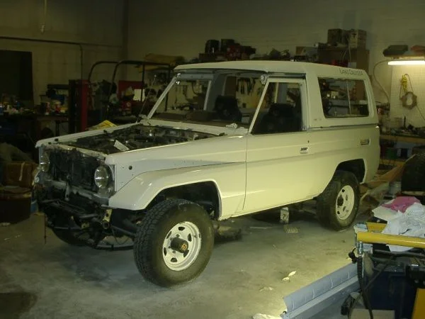

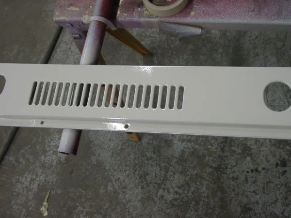

Touched up the black bits today. Stewing about weather I want to wet sand and spray the white yet again. Just too much orange peel for my liking. Prolly easier to sand and respray than to sand and polish.
Looking good, I noticed the orange peel in the photos of the windshiled frame.
I have had this problem a couple times, little more thinner seemed to help it flow out better.
Only down side of thinning is the possibility of running, nice light coats.
The guy who tought me how to spray thinned his paint quite a bit, mind you I have never seen him run paint ever.
What kinda paint did you use? and what code?
I am going to be going white real quick. I was going to go Toyota natural white. But not for sure.
Looking good. Personally I would not worry about a little orange peel. The factory paint job had quite a bit on my cruiser. Thats just the way they are.
I can't remember the paint code... 130 maybe? The paint is PPG concept and while this is not the first time I've shot it I just haven't got it figured out yet. There was a host of problems with this paintjob. It was too hot in the shop, I couldn't see the white paint going on no matter how many lights I had. (I prefer to shoot darker colors) I had the wrong nozzle in the gun and most importantly, I'm a rookie.
Anyway, I decided to wet sand and cut polish. Its working out ok. I'll start a new thread with a how to once I am done.
Thanks for the compliments and suggestions.
