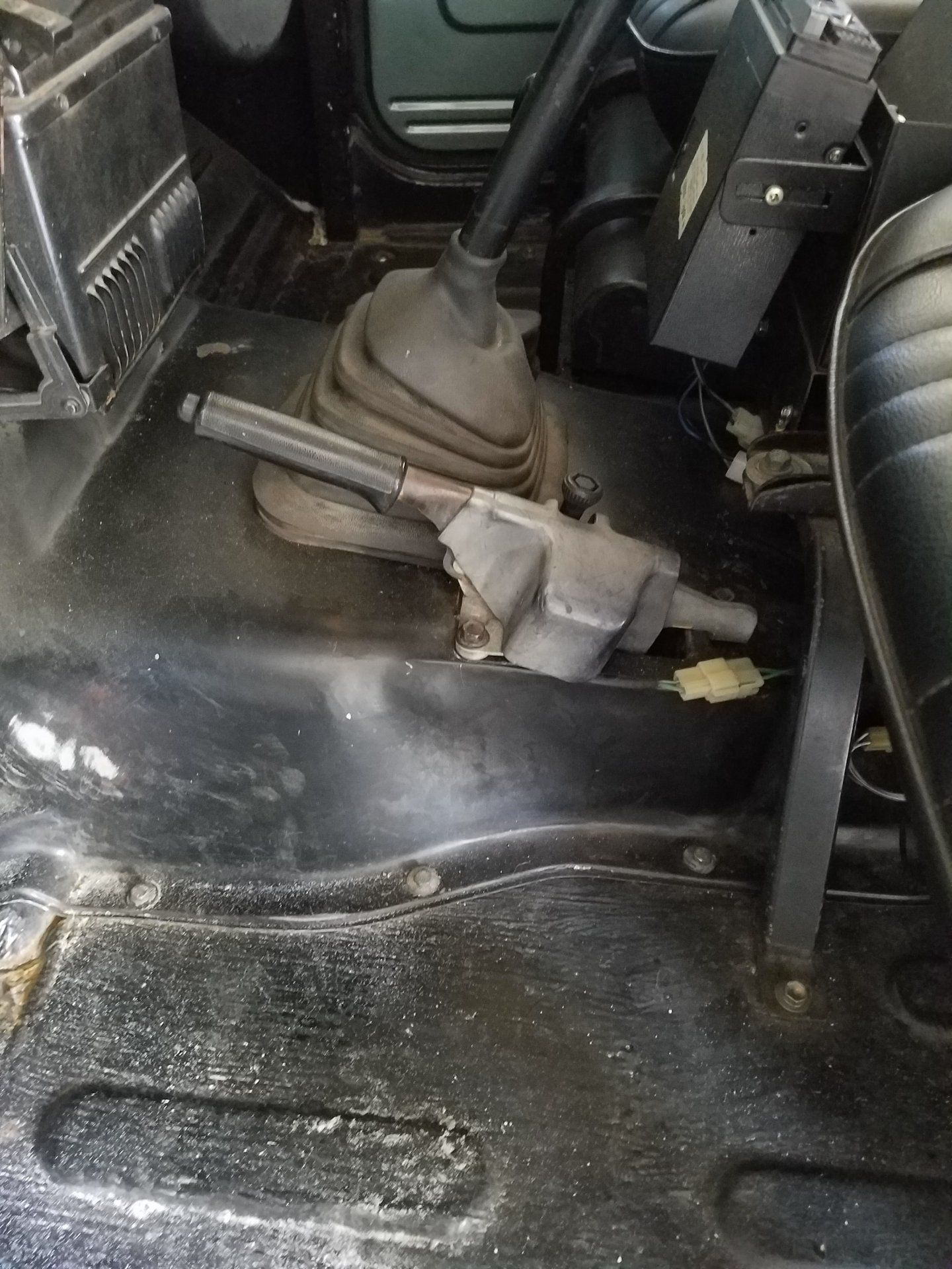

The '79-83 models have it on the tunnel, but the tunnel is wider to support this mod, and of course, the cable is shorter. I think moving it will be an enormous pain and not worth it.

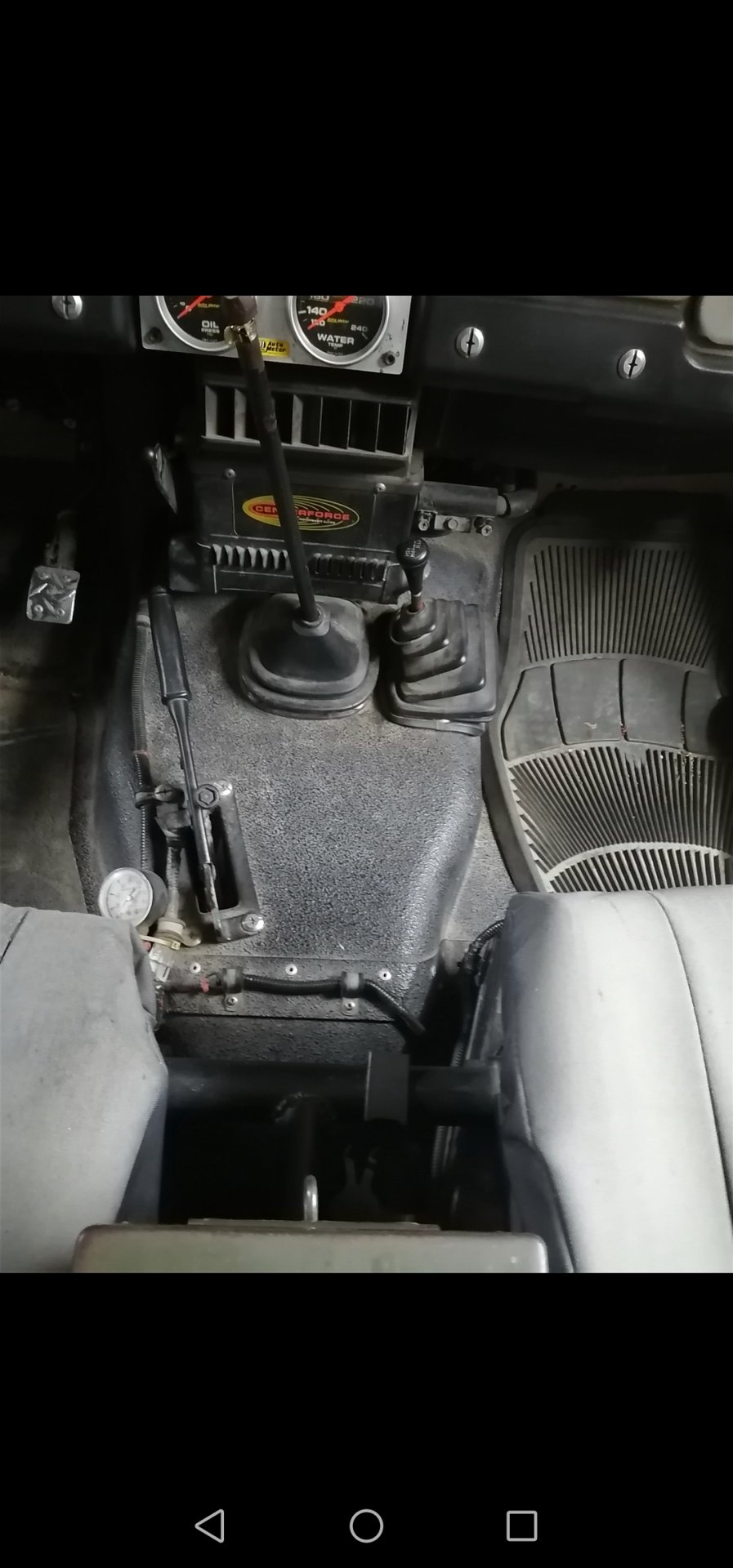

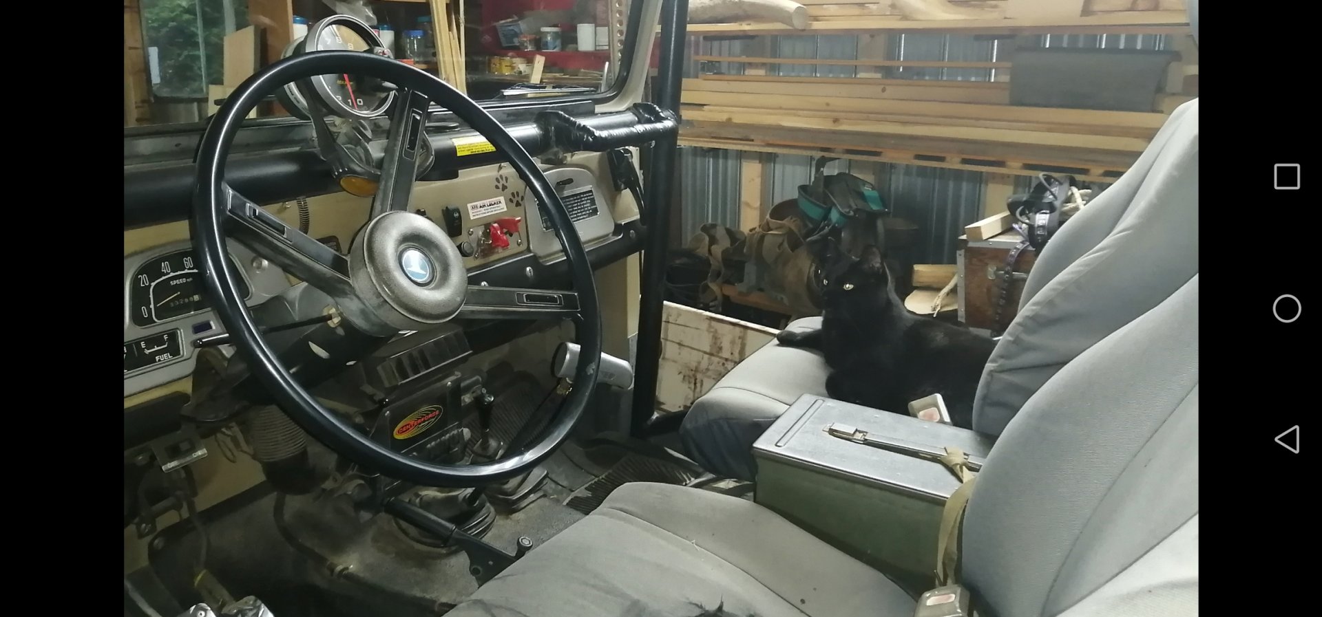

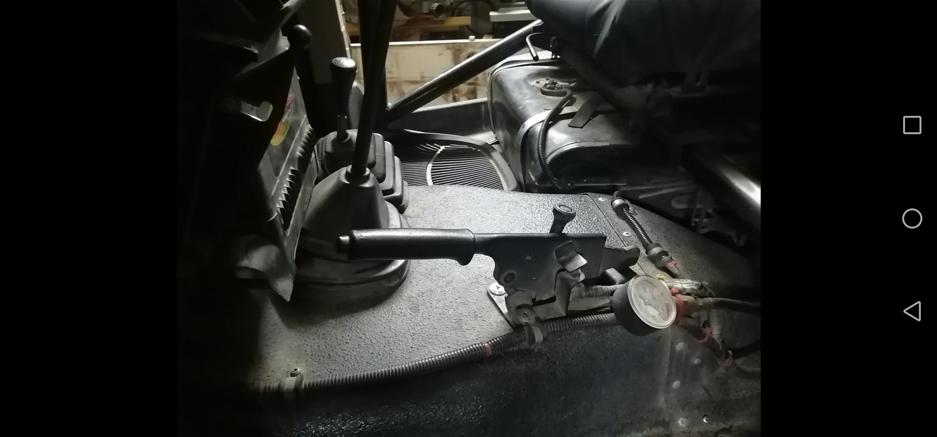

I did on my 10/72 when I installed the later rear axle with e-brakes. I added some sheet metal to create the surface area for it.

What transmission are you running? Looks like the shifter is in the 60 series position.
Am I seeing a 9/73+ heater?

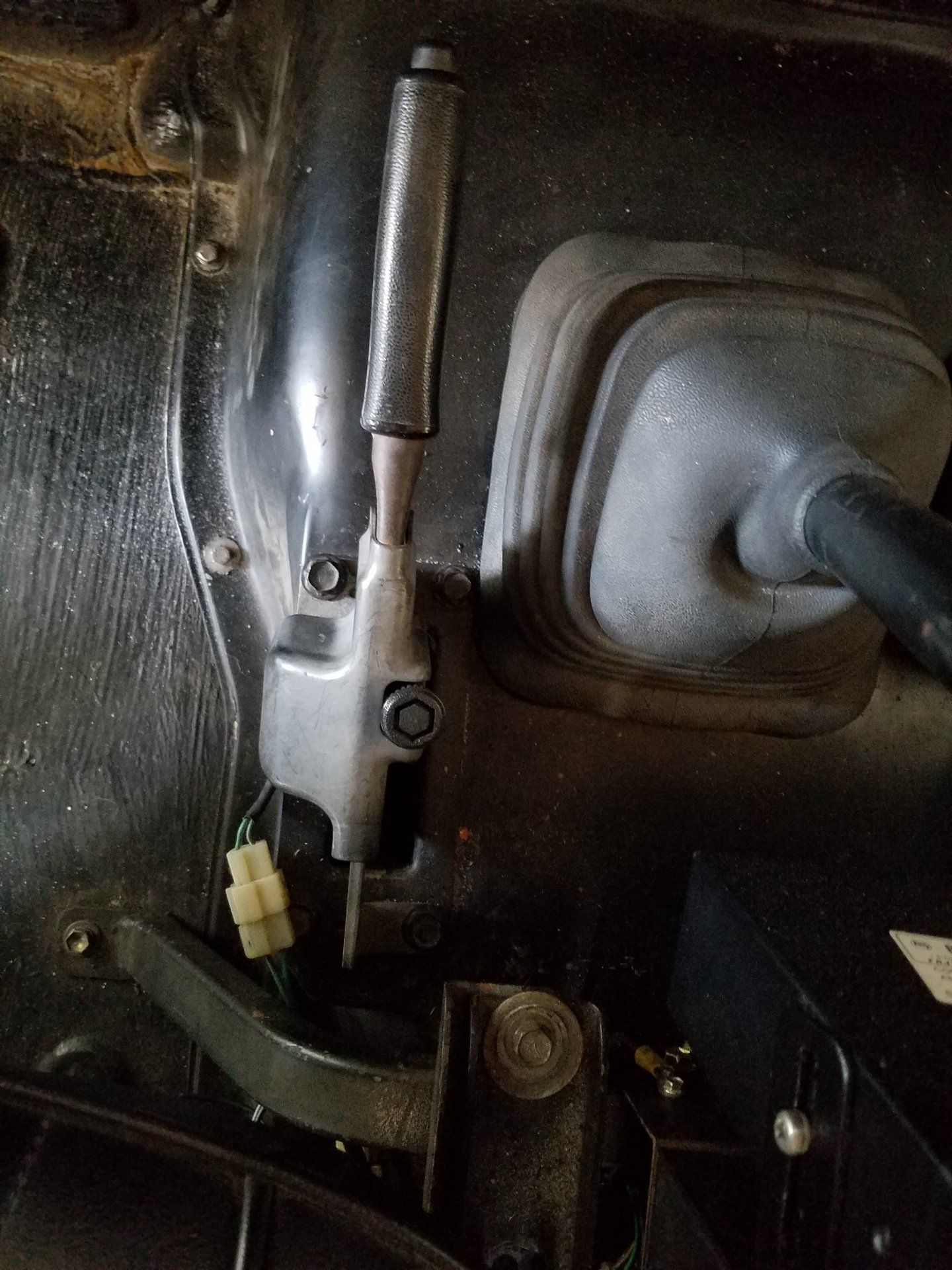

As for the hand brake handle thinking for my FJ45 of grafting a section of the 1/79+ hump onto the removable hump and move the hand brake to the rear axle. Even on my 79 moving it to the rear axle.
