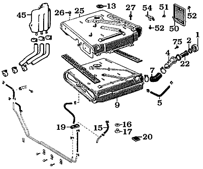

there's nothing wrong with the current set-up. it's only the smell of the fume that my wife is giving me a sharp look especially when it needs to roll-up the glass windows.
gado
Check the fuel Seperator. The stock '78 is made of plastic. Mine had a broken connector releasing fumes into the cab. I replaced it and no longer smell fuel.
hi there sir!
could you post picture of the fuel separator? i belive mine is no longer equipped with said item. where is this installed / connected?
TIA
gado
hi there sir!
TIA
gado
It's number 45 in this SOR diagram. Should be just behind the passenger seat under the silver cover , where the fuel inlet enters the truck.
