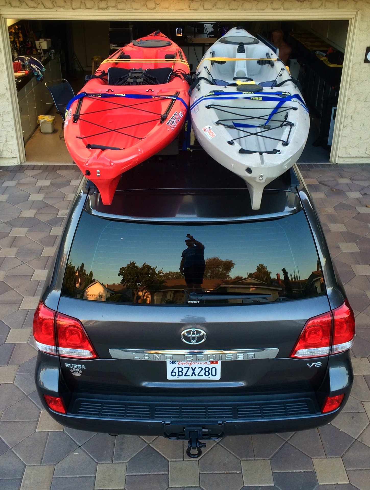

There’s room for two kayaks up there with fin in between.

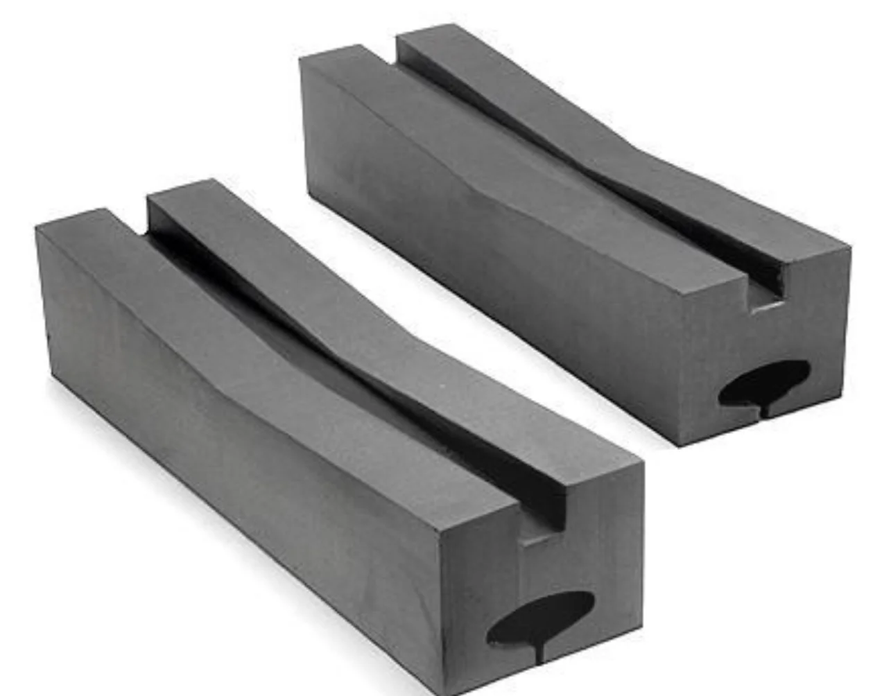

With OEM roof rack, I personally think the best mounts are the simple foam pieces that have slots for crossbars, and a havre a slight V to them. Usually about $30 a pair.
I don’t have the fin, but here’s a photo of my two kayaks on my OEM rack. You can see here that there would be space for the fin if you just choose a side for your single kayak, or two like this:
REI and other outdoor sporting goods stores carry these. They work a charm and stay very secure with kayaks strapped down…
These:
There’s room for two kayaks of there with fin in between.
REI and other outdoor sporting goods stores carry these. They work a charm and stay very secure with kayaks are strapped down…
These:

Those foam blocks are handy too.
