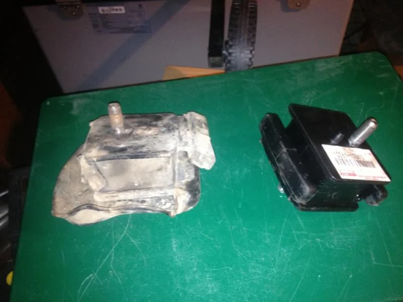

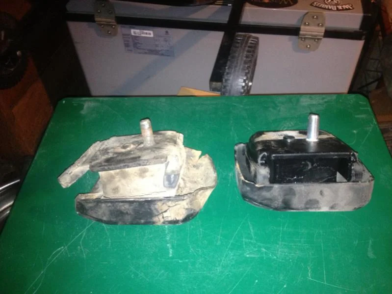

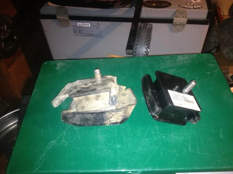

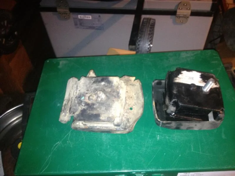

Any of you guys ever have a motor mount this bad? Replaced the driver side today and it was completely destroyed. Not sure how something like this happens.
The motor mount stabilizer, metal piece on top of rubber mount, was completely folded over on the motor mount and was actually cracked in one of the corners. On the right is what a motor mount is supposed to look like. On the left is what came out of my rig.

Maybe the engine was yanked at one time and they hit that metal tab pretty hard. Hard to say without knowing the entire history if the vehicle ya know.
What prompted you to look at the mount? Noticeable idle/revving vibrations, visually noticed them while addressing other issues?
That was the prob will? With the shifter? Same thing that happened to mine remember, I chained myine down. Looks like yours came off and smashed something on the way down leaving it tilted for good?
It was still bolted in on the top and bottom. Not sure what happened. Figured it had been bad for a long time and the torque of being in four low several times over the years took its toll. Kyle, it didn't fix the shifter but I think with the mount being that bad for that long may have made other parts give way. TOR said it may be the rubber grommet that holds the actual transfer case shifter. Going to check that out and I'm still waiting on the other motor mount to come in so I can replace it. Maybe that'll help a bit.
