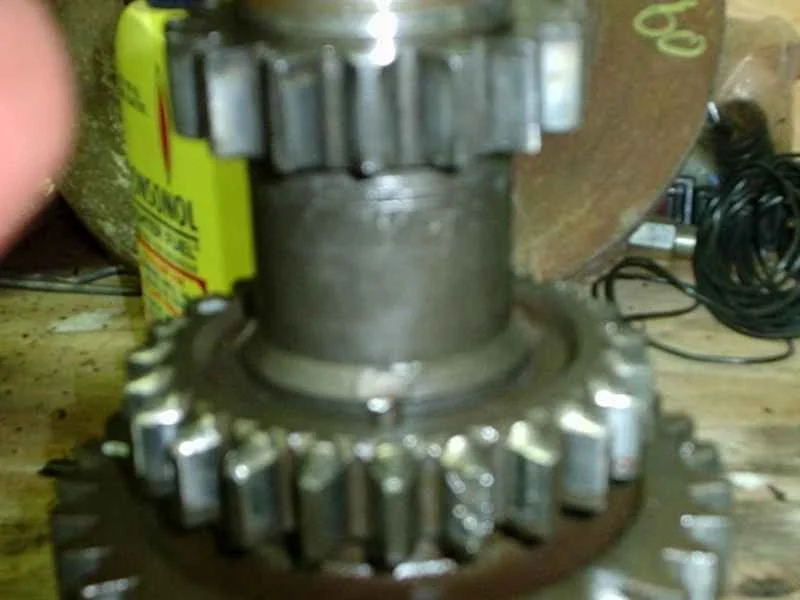

I'm working on Mike's '59 tranny..
Here's first gear on the countershaft. Makes me cringe when people think "low mileage" plow trucks are a good thing. :doh:

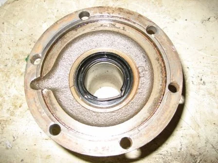

Well maybe after 47 years it was about time for a new seal..................

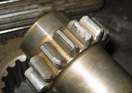

Chips or pits..................you choose. :flipoff2: Since it's first gear it could last another thirty or forty years as a driver, but it looks like the tooth behind it is starting to wear funny from half of this tooth missing.
Anyone have a good spare countershaft with bearings? :frown:
zebrabeefj40 said:
Weld it up and grind it back to shape...
It'll probably still be on the bench when you get here. I think maybe a file would be better though. :D

Jim, this could be your huckleberry...good bearing surfaces, 1st gear shows some wear but no chips...bad bad second...maybe press 2,3,4 off of this shaft and put Fox's 2 on, then the best 3,4....only parts you would need to find would be the four rods that key the gears to the shaft, Mcmaster Carr? The rods from the pre-sm420 would be too short....
Let me know soon, they may make me go to work someday....
Yes, that's perfect. I can send it back to you with the bad first gear on it so you've got a matched set. :D
I believe first is the shaft itself. Our other gears are fine so I'd just use them.
