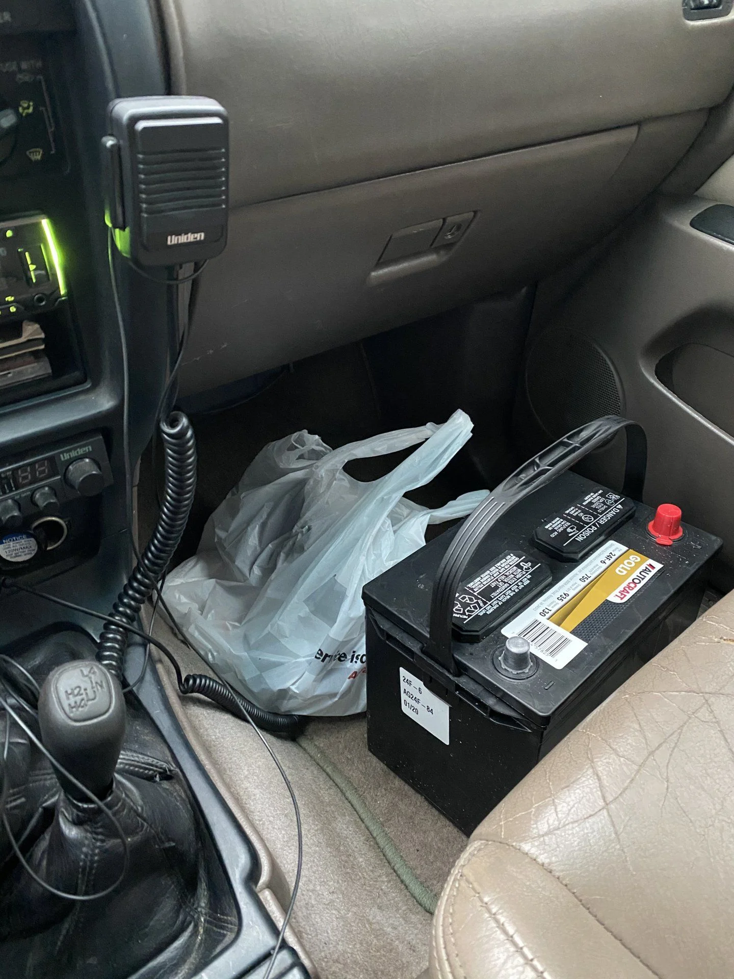

It was awesome meeting everyone! Can't thank everyone enough for their help with the tail light and of course, for the ride home after Pearl's 6 volt's of juice let go.
Hoping to get back to Kilroy's tomorrow night, probably around 7-7:30 with a new battery if anyone is around the area, can probably tackle it myself, but would love some help! Drinks on me if the alternator takes a liking to the new battery...well...still drinks on me for the help regardless, but might need to scoot on home.

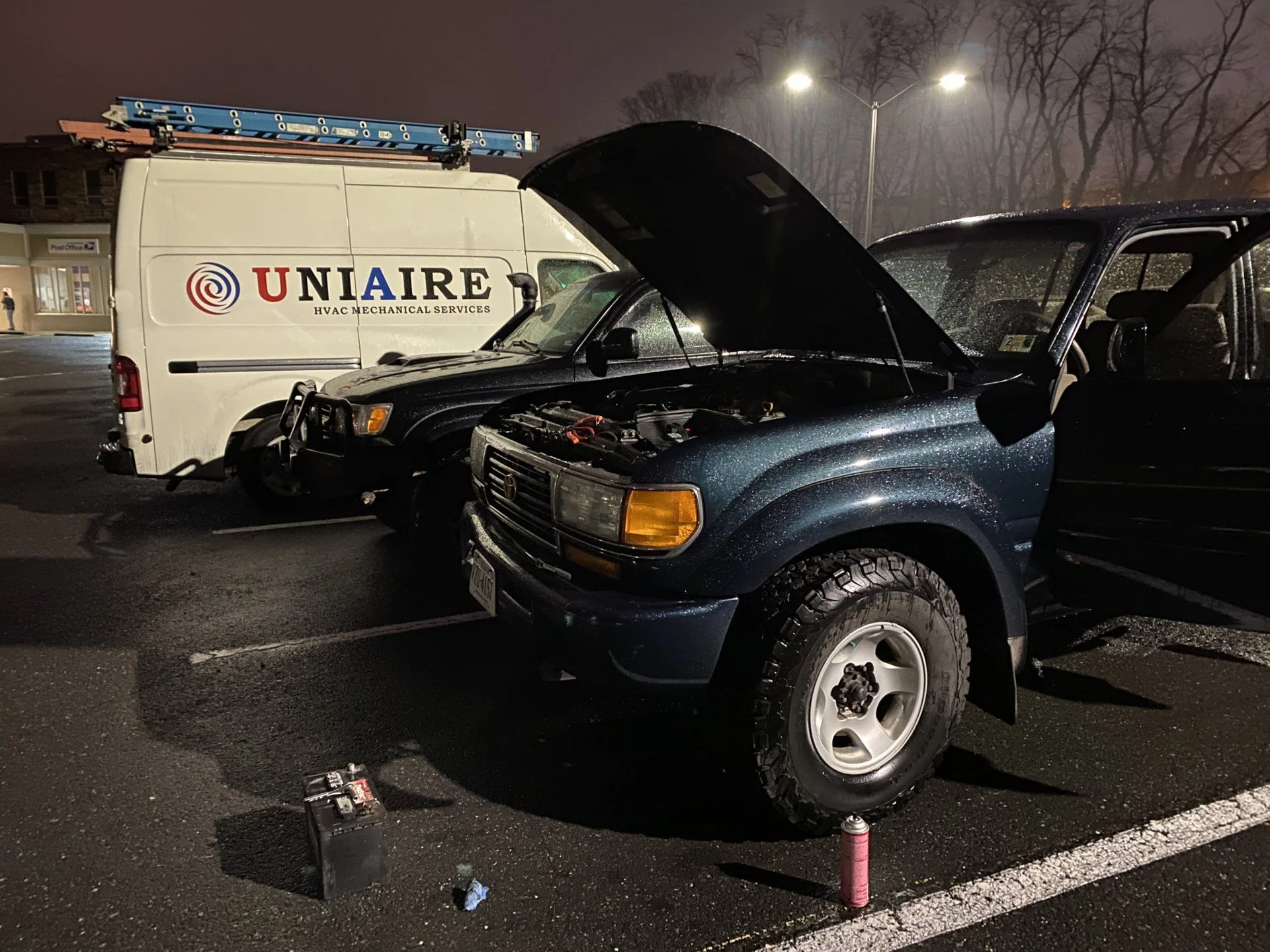

Got it done. Negative terminal was fused together. Cut and striped wires and replaced. Got soaked. But made it home safe from her first Kilroy’s meet. Just took a little longer to adjourn.
No voltage increase when tested with multimeter or on gauge when running. Red discharge light still on. Alternator isn’t doing squat.

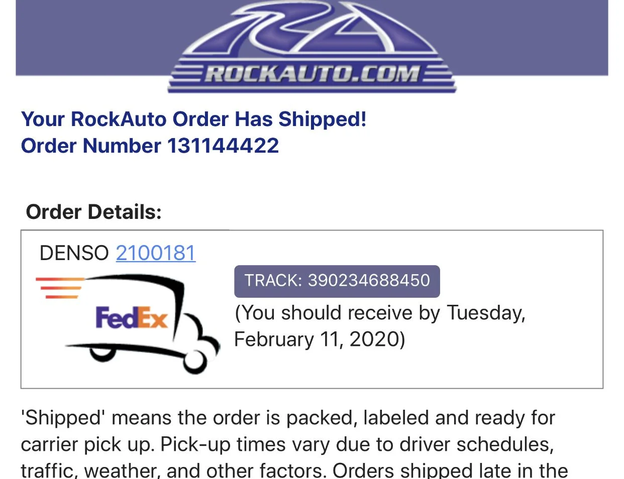

Ordered an OEM Denso reman from Rockauto. $104 after core. Should be here the 12th. Truck will be on the tender. Will aim to do oil change at the same time and get to it from the bottom. Open to suggestions and/or help!
Edit:
Gotta love rock auto...
