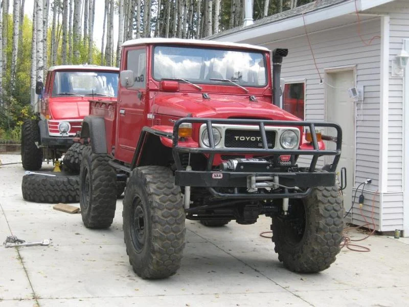

Well the truck is home.
I think the plan is to keep the truck as capable as it is now (same as Robb had it minus the rear steer), but to also make it a little more streetable.

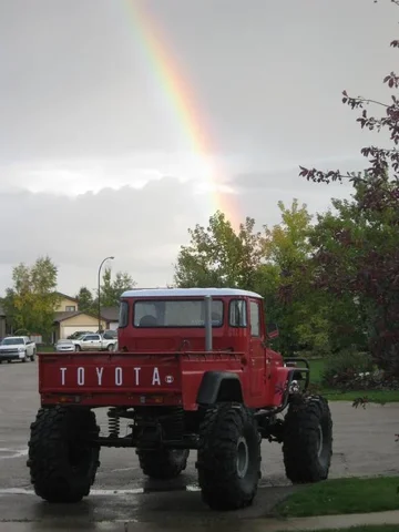

Here she is as I see her every day. Pot o' gold.

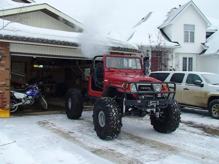

There is a list of things to do. I won't list them yet, I'll just start with getting it street legal and insured. First on the list is a second set of "street" tires. Here I'm trying out my buddy's 14.5R20 s from his mog
Changes the look instantly. Looks like a truck instead of a buggy.

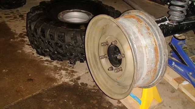

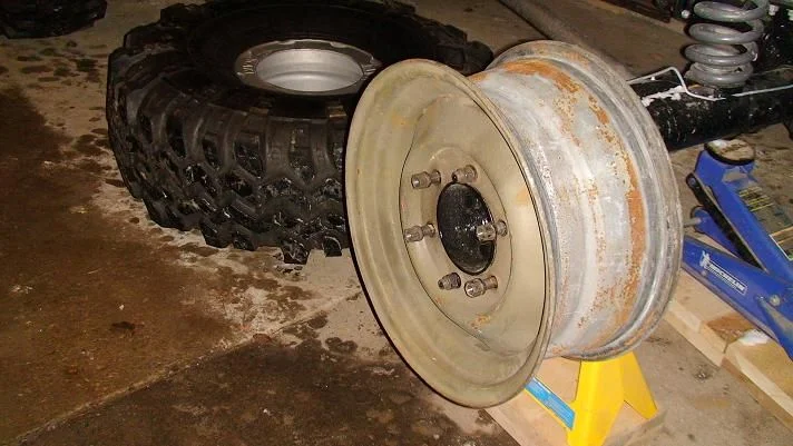

Took one wheel off to try out the new (well used) 404 unimog wheel
The new wheels are 20x9 (from a 404 mog). The BL wheel is 16.5x9 but has considerably less back spacing (2.5 vs 7.5). So the wheel itself brings the centerline of the tire in 5".

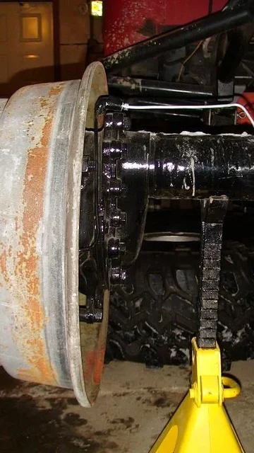

This pic shows the inner edge of the mog wheel just outside of the portal box mounting flange.
This pic shows the BL rim inner edge just outside the disc brake
I love the stance with the LTBs on there, but the overall width is 93.5".... too wide for driving around town and some of the smaller trails. With the inset mog wheels and the set of 12r20 xmls I have coming, each side is brought in 7" for a total width around 80"

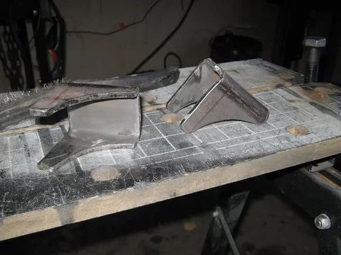

Tried out the new plasma, cut some new shocket brackets for the axle
Got them welded on and painted up. Here's what they look like. The top mounts (on the frame) were already there when I picked up the truck.

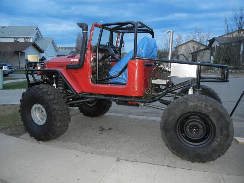

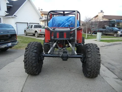

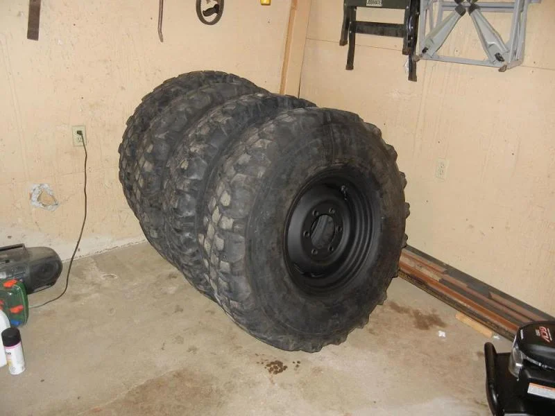

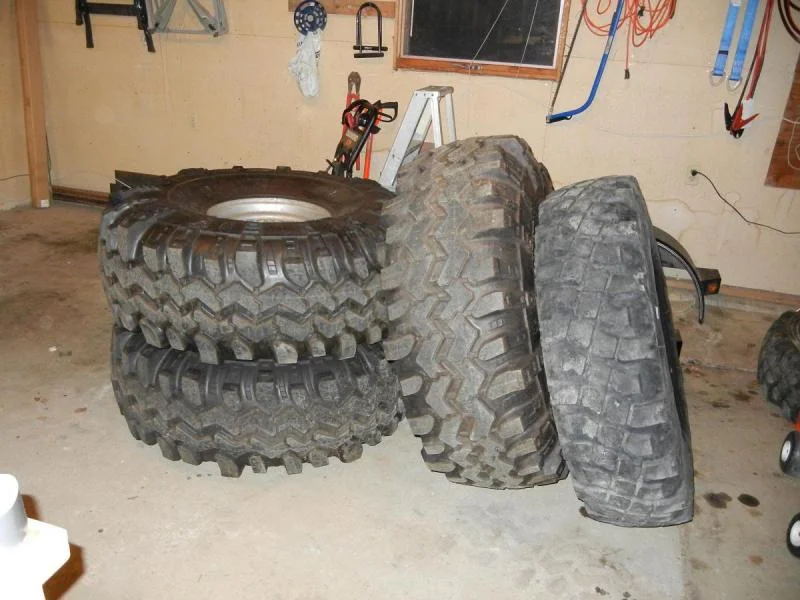

Finally got my michelins (street tires) and had them mounted. Also painted up the rims (they were drab green/rust)
Here is one sitting next to the LTBs
Here the back ones are mounted and LTBs on the front. I'll take pics of them all mounted in the light tomorrow
