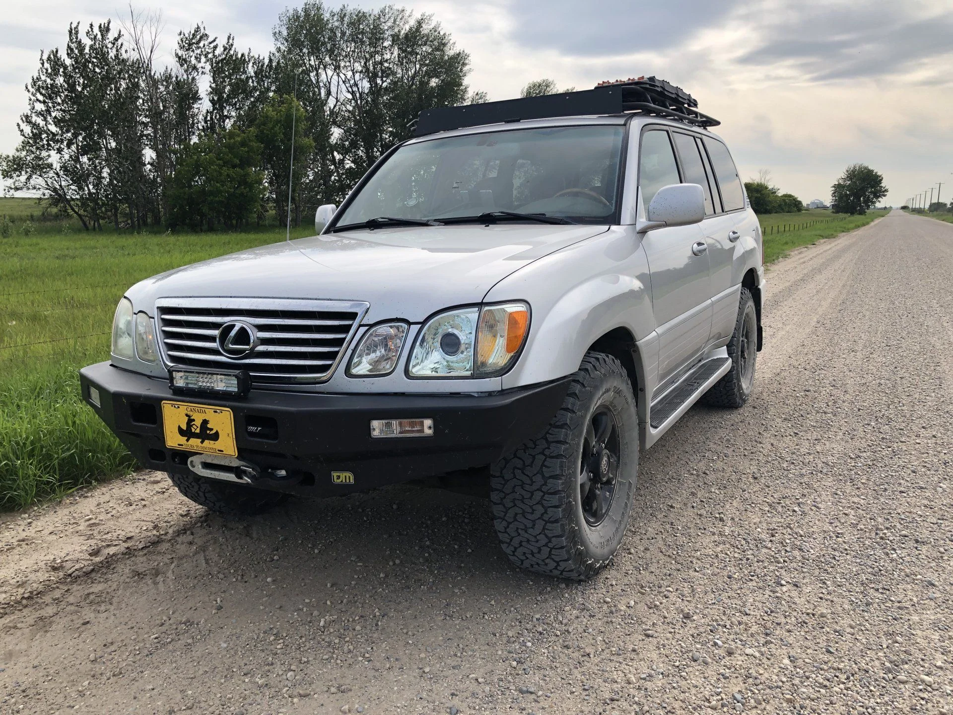

Does anyone have any advice on improving mileage on the 4.7L V-8? I have the 2006 with VVT and my results are inline with other discussions: about 11.5 city/ 13 hwy. I'm running 33" BFG A/T's and a gamiviti rack. Not much else but a jack hanging off the side. Anyway if there are any good threads on the subject or recommendations out there I'm open to suggestions.
I don't want driving tips just suggested modifications that work and are cost-effective without hampering capability.
Regards and thanks for any tips.
Aside from good maintenance and 91 or better octane fuel I'm not convinced there's much out there unless you want to start screwing with ECU tuning or somehow leaning the mixture with some sensor trickery.
I expect someone to mention the 12-hole injectors, but we still haven't seen solid long-term (a few thousand miles before and after) data on that so it's a bit of an unproven theory for me.
The 33" KO2 tires, bumper and roof rack are probably more detrimental than anything you could do to counteract them. I'd just let go of the idea and enjoy it the way it is. :)

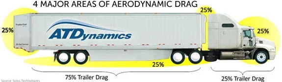

If you look at semi trucks these days they are going with aerodynamic improvements to get better mileage. They are using air dams, skirts, rear fairings. Expect the most improvements will be down this road. Lifted, bumpers that put tires (larger) in airflow, roof racks, stuff mounted on top and in back, creates a lot of drag. The trick will be coming up with significant fairings that you can fold up and stow for offroading. Don't think it will be pretty, but art is in the eye of the beholder. :clap:
Air flow drag under the truck and breaking over the back end of the box are significant.

All of those improvements on a big truck will net you about .1-.2 mpg improvement. It will take 500,000 miles to recoup the cost of the aero aids and the small lose of weight carrying ability due to the weight of the mods. In my years in fleets I have never seen any claims higher. rolling resistance of the tires is also a factor. You could get batter mileage on a big truck by rolling back emissions to 01-05 standards. That seems to be the sweet spot. In 06 emissions went to a higher standard and mileage dropped on big trucks by about 2 mpg.
