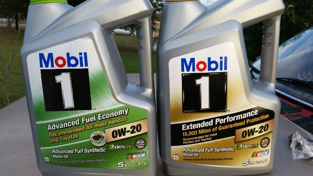

Is there a difference in these two oils? other than labeling?
Green label bought at Oreilly's & states Advanced fuel performance
Golden label bought at Walmart & states extended performance
Thanks,
ML
Thanks Estancio, here is the reply, in yellow, from Mobil oil...
Luis, The advanced fuel economy helps you save about 2% on your fuel and can go 10,000 miles. The Extended Performance is a more robust oil and has 50% more base stock, also a propitiatory on pao oil, and super antiwear package which is our best oil and goes 15,000 miles. -Mauricio
On 1/8/2015 2:36 PM, luis.dominguez@spansion.com wrote:
The following inquiry was sent through: ExxonMobilBrand: ExxonMobilFirst Name: LuisLast Name: Dominguez:
Greetings Mobil,
I have a question regarding Mobil-1 0W20 oil to be used on my 2011 FJ Cruiser on which I do my own oil changes. On my previous oil changes, I was buying the one gallon jugs at Autozone or Oreillys and the latest one I bought was a Walmart. The labels are different I wish I could attach a picture. The jugs purchased at autoparts stores mentioned have a green background label with the statement across it saying Advanced Fuel Economy along with the recommened vehicle use. The jug purchased at Walmart has a light brown label which states Extended Performance, 15,000 Miles of Guaranteed Performance. Is the product the same? Just different labels? Should I use one over the other for my 50,000 mile FJ Cruiser?
Thanks you in advance for your time.
Best Regards,
Luis M. Dominguez
I guess from now on I'll use the brown label stuff from Walmart for better engine protection & in case I go over the recommened oil change intervals.
I was just at WalMart today buying oil. The 5 quart jug of Extended Performance (brown) was only $2 more than the Advanced Fuel Economy. Probably worth the extra 40 cents per quart.
Around here a 5 quart jug at WalMart is usually about $25 but it can vary up or down a dollar.
