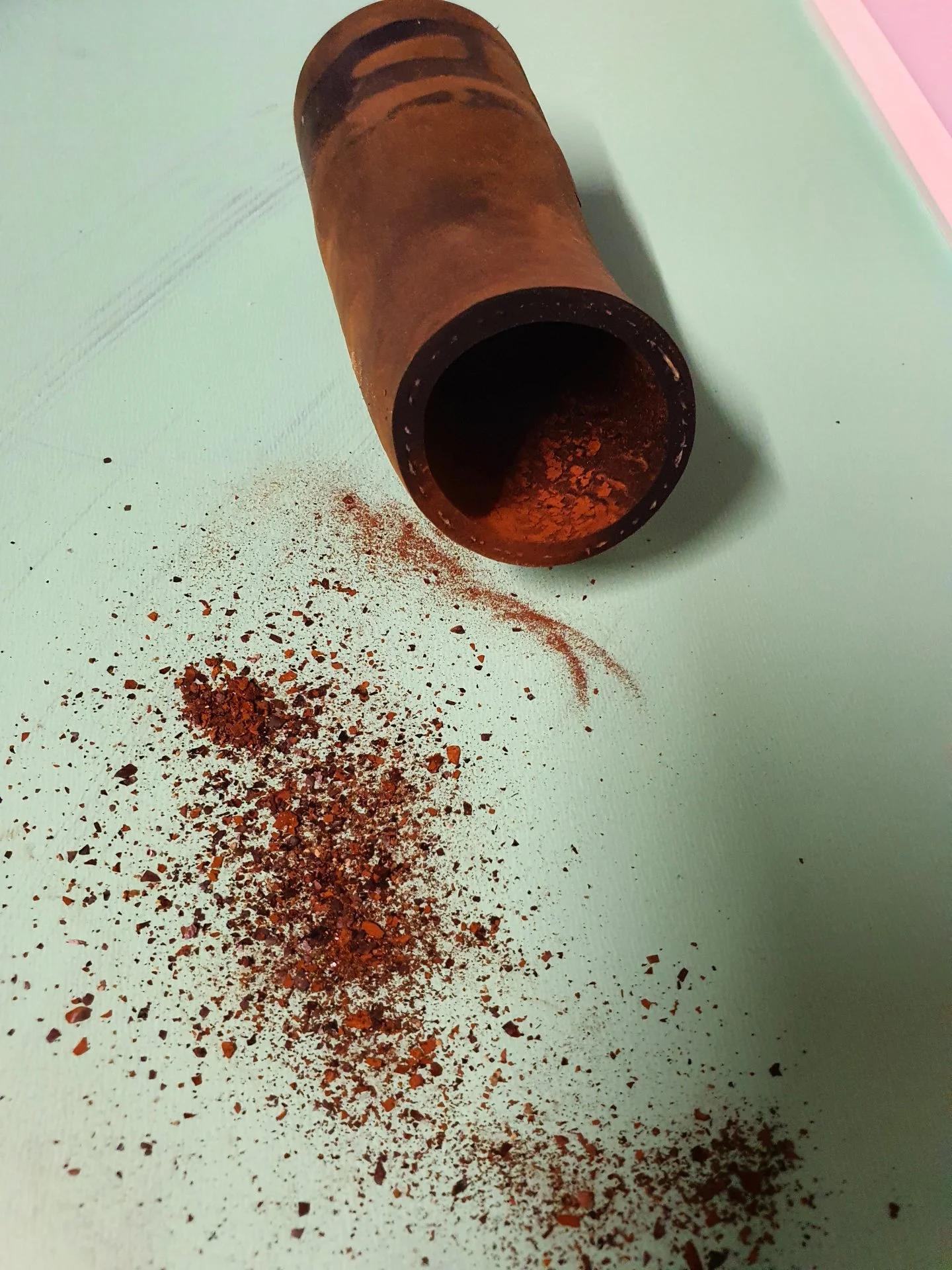

I would flush ASAP.
The PO of my vehicle tried to make Christmas chili like that once, and 4 years later after multiple flushes and a new radiator I am still slowly getting all the crap out of the system.
I am running green now but if I was running red and needed an emergency top off I would use tap water over mixing coolant types.
