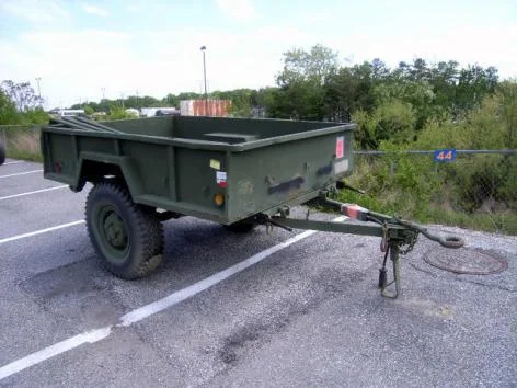

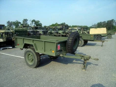

Looking for something I could take off road on camping/expedition trips into the high country - off road, of course. Would this be a good choice of a trailer to haul behind my FZJ80, or is this a bit too big/heavy?!
Trailer. Military M101A3
My truck is pretty much stock for now... I got a hitch in the back and there are the 4-holes available for the pintle hook.
Any info would be appreciated to get me started thinking about this in the right way.
That is a big heavy hauler for big heavy loads.
I have one , and I only feel comfortable towing it with my Power-stroke. I would not think about pulling it with anything less.
That's just me
But I have seen them being towed by smaller vehicles.
You're going in the wrong direction. The M101 is a 3/4 ton trailer. The M105 is a 1.5 ton trailer... :eek:
That A3 would be easy to pull. The height would be the only shame. They are built to trak behind HHmmvs . The best solution to bring the trailer down would be to take the axel and place it over the axle. That wil give you a 4 inch drop once you take the 2 inch metal blocks out. I pull a M116a2 trailer with my 2011 Taco with no problems at all.

The first one is WAY too big to be enjoyed... or pulled ;)

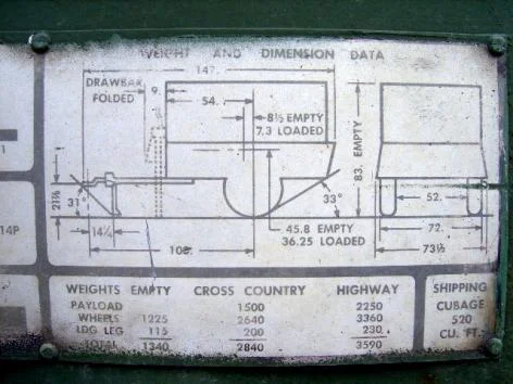

First off the trailer in the picture isn't an M101a3...it's an M101a2 (which has the conventional GM 8 lug wheels, and surge brake)...it should weigh in right around 1400lbs. empty. That's alot of extra steel to be hauling around. As mentioned by notme2...the M116a2 is lighter trailer, simply because of the lack of a heavy metal box....but is no lightweight. Hauls the same amount as a M101a2

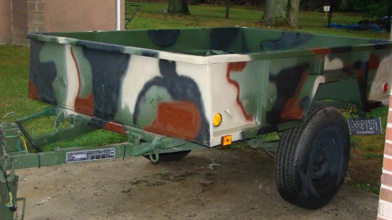

This is a m116A2 cargo trailer. The m116 trailer was and is a trilaer designed for totting around Generators. I have one with a 101a2 box installed by the VRO. Not all trailers are the same. It depends on the unit that they were used by and the Company Commanders discrection. So that being said I have seen !M101a1 trialers with surge brakes, and M101a2's with six lug split rims. The combinations vary..And you cant rely upon the data plates because they are removed often. The M116 frame is heavier than the M101 series. They had to be in order to haul Generators off field.. Here are a few pics of mine. The 116a2 and the 101a1.
This is a picture of an M101a1 I just sold to a friend of mine. It was fun to haul around with my truck.That is why I bought the 101( Green 383) in picture above.
