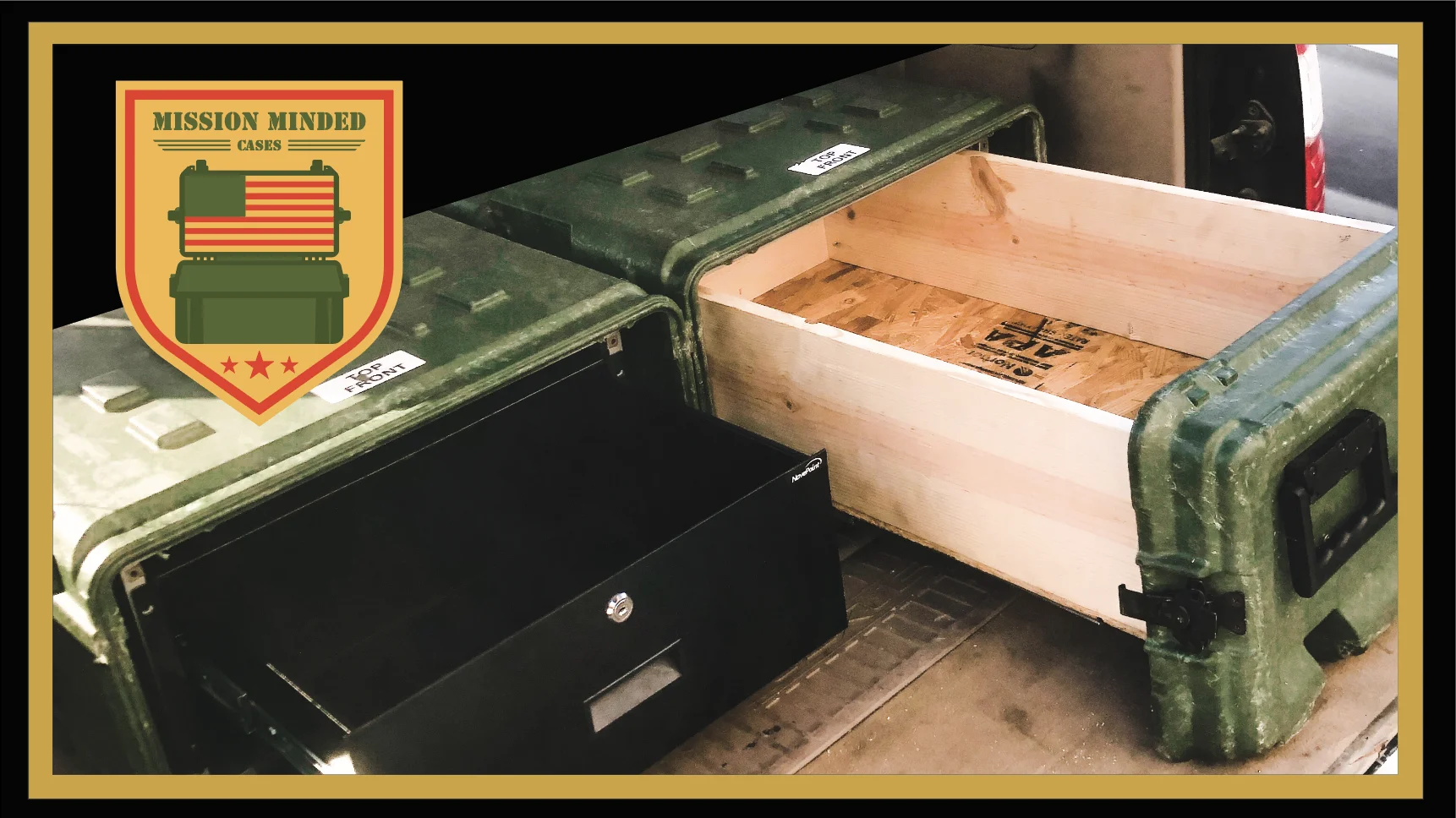

Hey yall I wanted to post how we turned our Military server cases into a solid Overlanding drawer system.
As a disclaimer, I will be upfront and let you know that we sell these cases.
If you are looking for an affordable option for a drawer system these server cases might just be what you need. Watch the video to see the two different ways that the cases can be configured. If enough people want to see a direct how-to with pictures on how I built the drawer I can provide that as well. It is pretty self-explanatory though. You have the ability to stack these or even remove them from the truck easily while maintaining a very finished look for something that is repurposed. The total cost in materials for the DIY drawer was about 42 dollars.4
The tools and the Materials are as follows.

Materials:
-Server Case
-1x8 Common Board
-1/4 Inch OSB
-Kreig Jig Screws
-20 Inch Drawer Slides (cheap home depot
