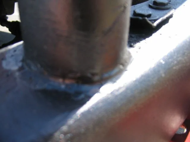

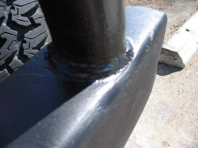

Some pics

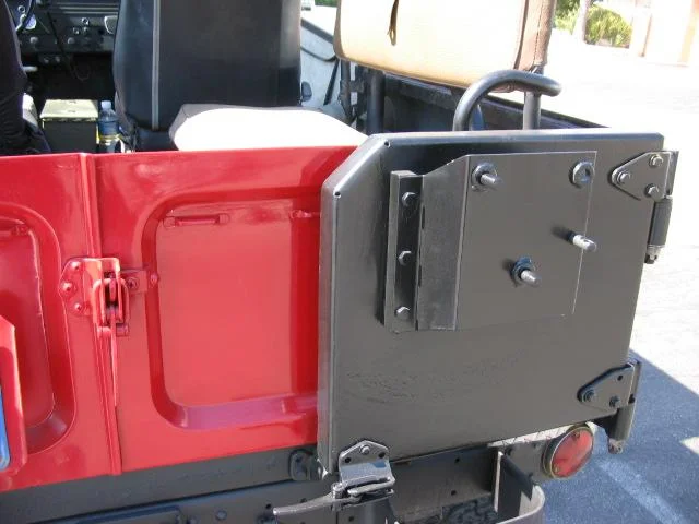

Took a couple close-ups of the shabby work. Also, a picture of what I am starting out with on the tire carrier.
As far as the welds go, I did what you are not supposed to do: I welded a layer between and over the 'uncleaned' surface of the previous welds. The problem that I experienced was that the wire was not burning, as though it was not making contact.
So, take their advice and clean the first pass really well prior to burning a new layer.
