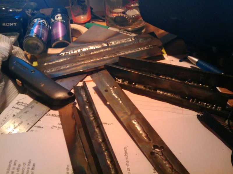

I just learned TIG today and I gotta say it was pretty easy to pick up. My welds aren't pretty but I've been told that will come with practice. After learning this process, I'm not sure I would want to do MIG or stick, at least when I had the choice.
I can't wait to go out and do some more!
