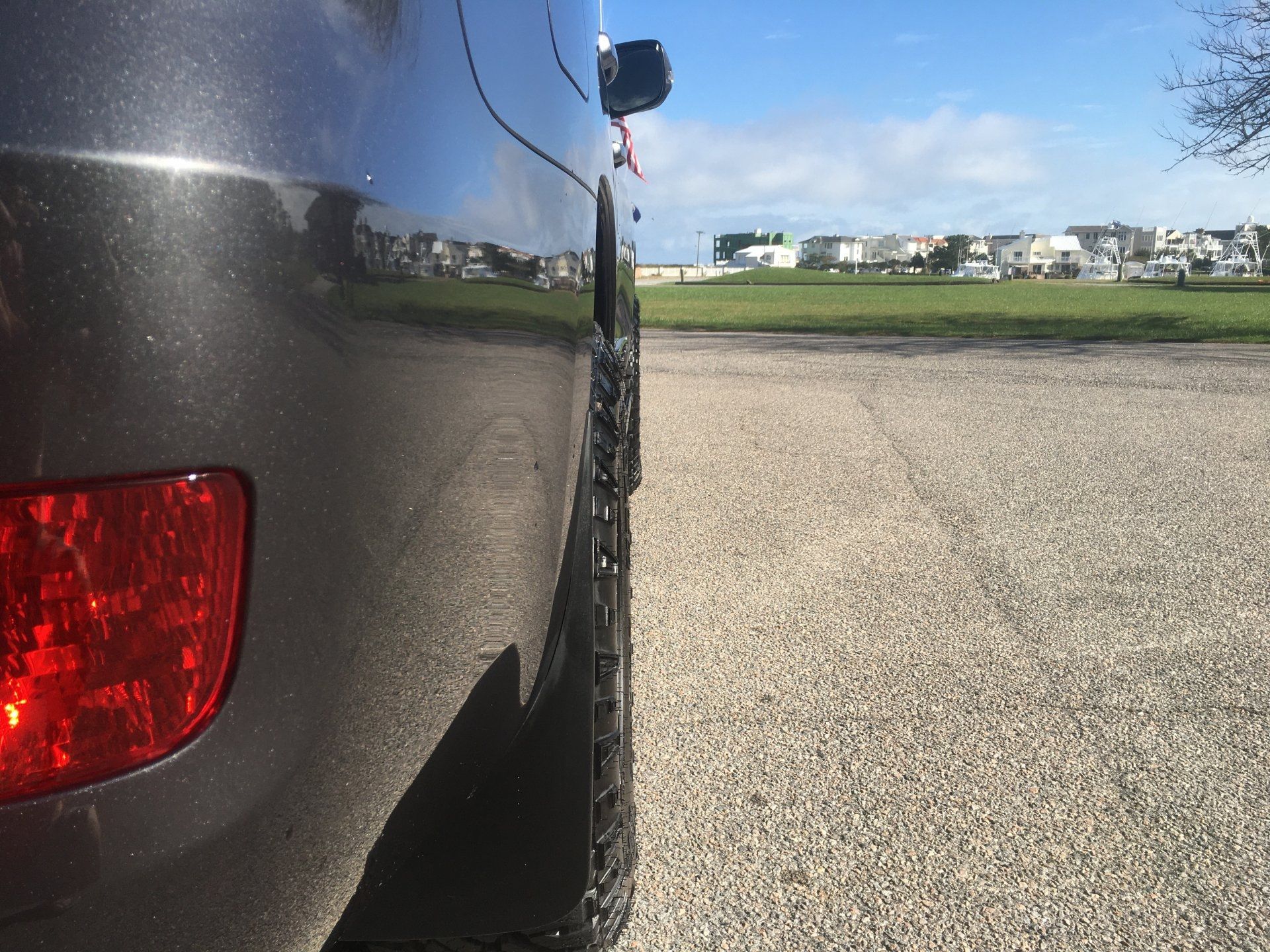

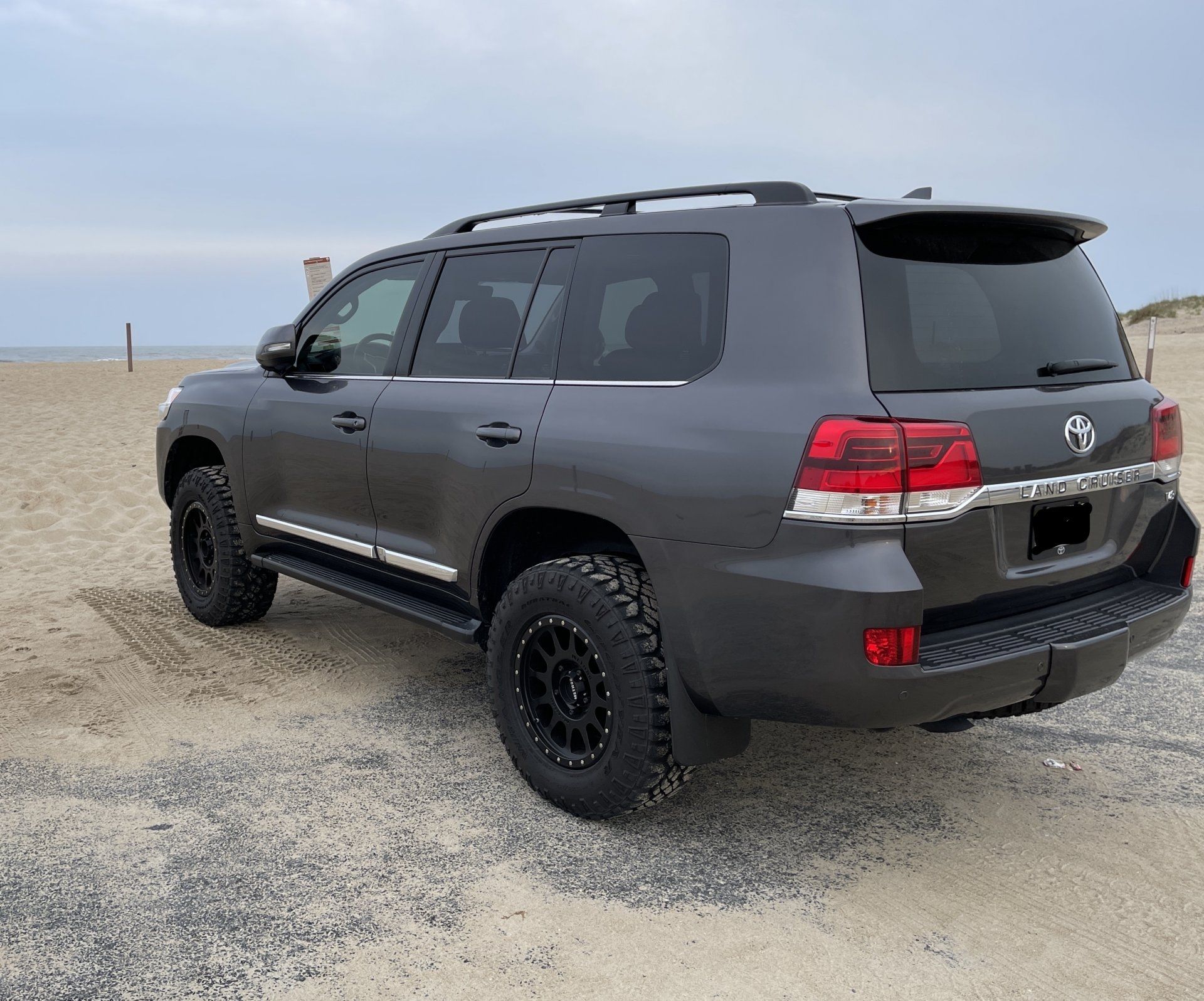

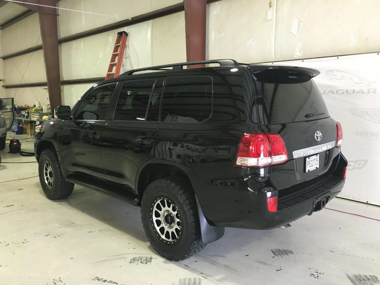

2018 LC, NV305 here +25 and they sit out perfect for me. +18, tire would be out to far for my liking, heres a picture of +25
Love your LC! What size tires are you running?
295/65/18 But I also have a OME BP-51 lift and still rubbed at first till I busted out the heat gun. Now is all good, for me I also noticed that when I changed from the factory wheel to the 18x9 they balanced out absolutely PERFECT, I could never get a good balance with the factory wheels

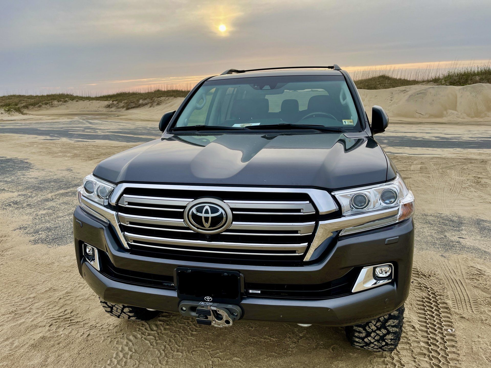

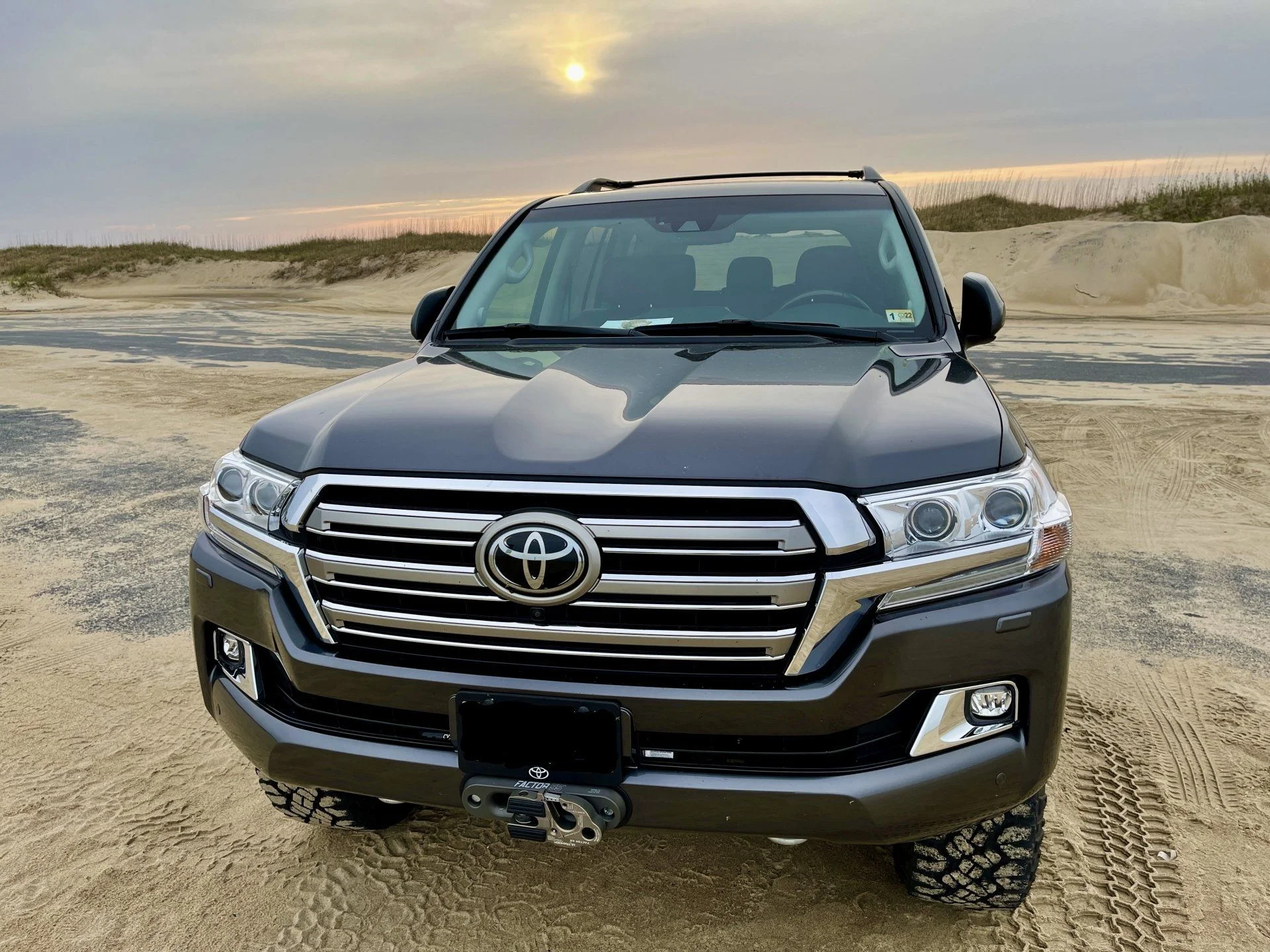

Wow - looking good!!! What front bumper is that?
Here Is a good thread regarding fender rubbing.
I have the Dissent Offroad bumper. Nice and light, minimalist aluminum bumper. Very happy with it.

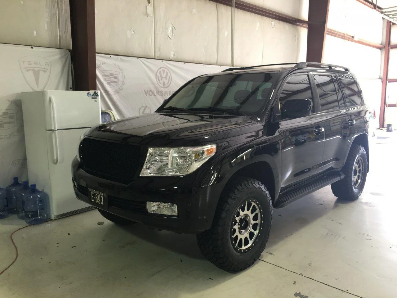

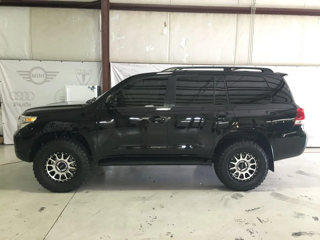

Not mine but here you go.
