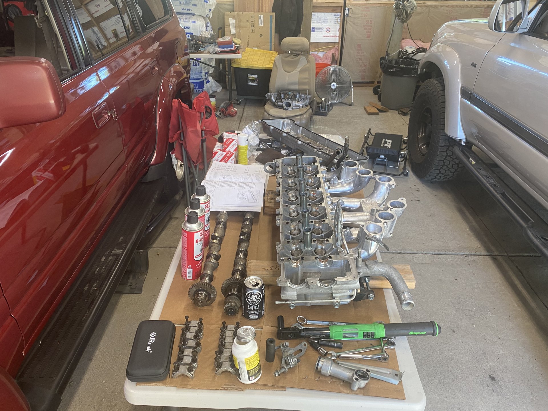

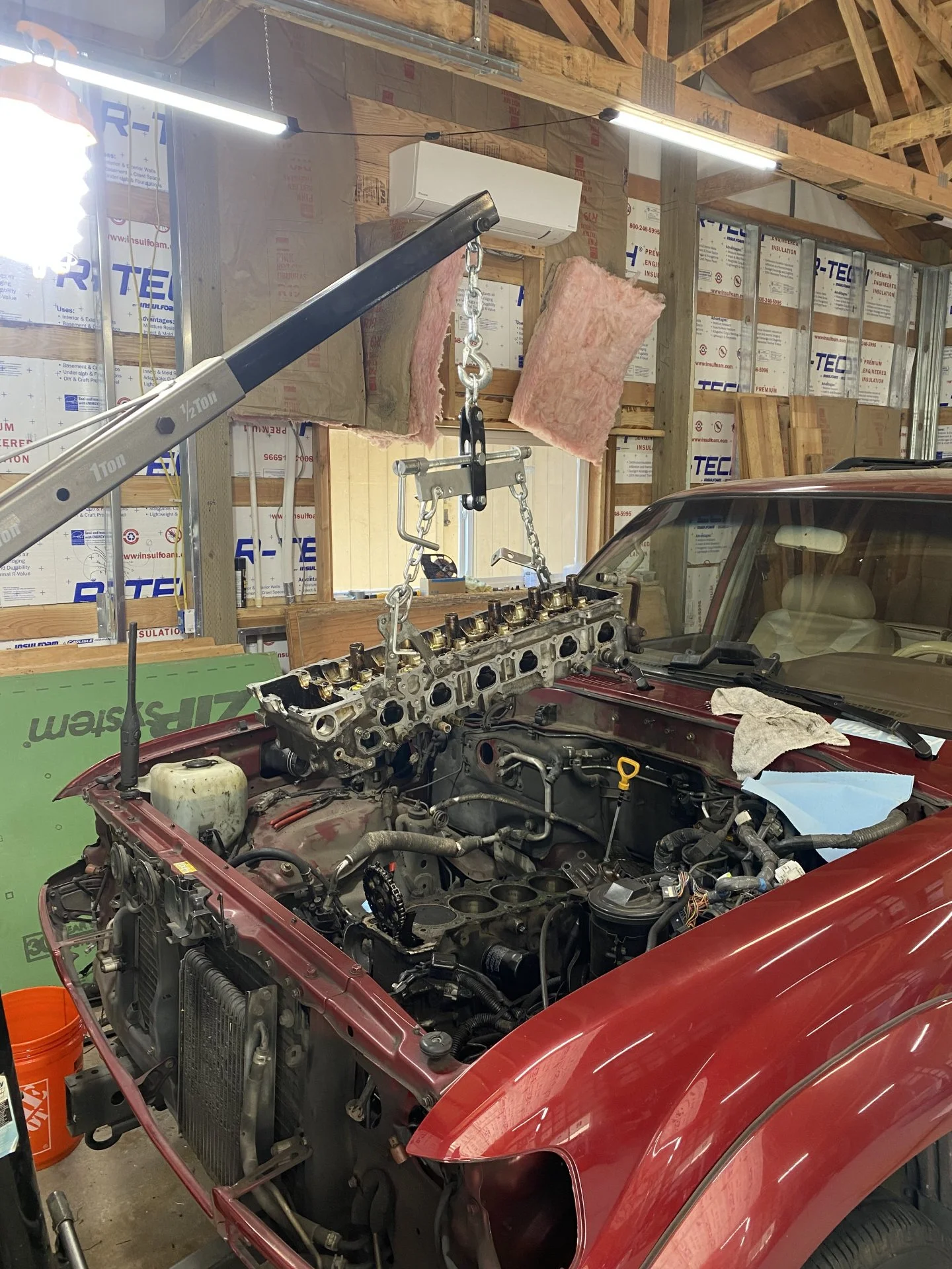

I appreciate it! If I run into anything I will let you know. I have the FSM and a few YouTube videos to reference so hopefully I won't run into any speed bumps! By the way the paint on your 80 looks mint. have you done a respray?

Ill try again after work tomorrow. Got any tips? (pictures several posts above)

Hey im already pretty much there at this point lmfao.
Agreed, in for a Penny, in for a Pound.
So how was the valve clearance?
