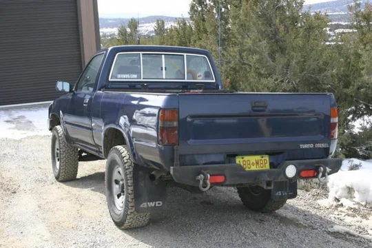

Mine's not a 60, but here's the bumper I made.
It's not done. I still need to build runners to go forward of the bumper to the rear wheels (will do it when I fab sliders), and I should build a swingout tire carrier someday. I put the spindle in, but haven't needed anything else yet.
I have about $100 in materials into that, and it has exactly what I wanted. That's why I didn't just order something for the rear. Nobody made what I wanted--either too big and heavy or just tube bumpers.

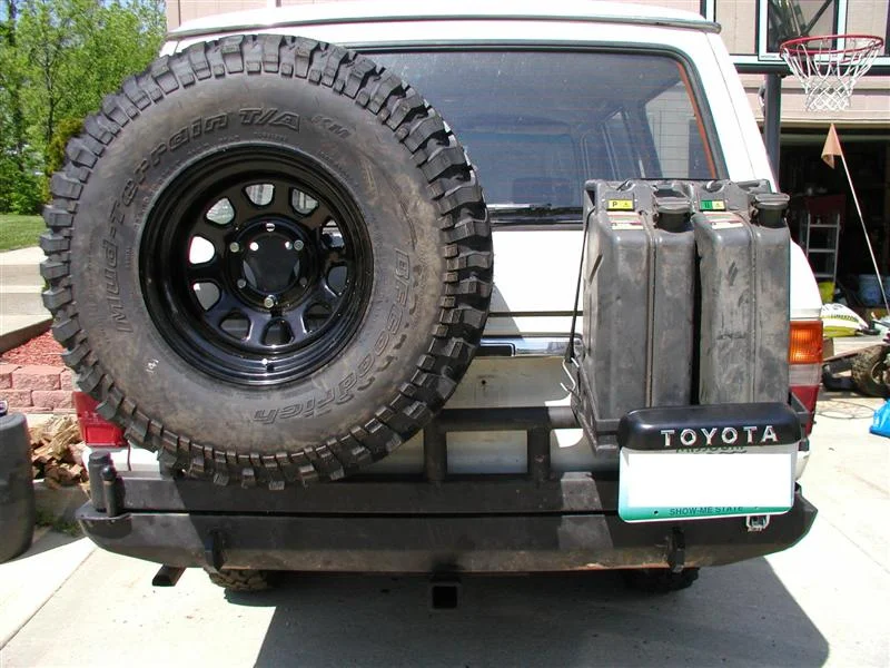

Ali made a really, really nice bumper for the rear of his 80. I'm sure pics can be drug up somewhere of the process. His is probably more of what I'd build for a 60 series. Kind of like this:
attachment.php
Hope that gives some ideas. The nice thing is you can change them and modify them if you've got some fab skills or know someone who does.

The major Achilles heel I see in that design is that the receiver hitch is the low point and unprotected. From experience I've learned that it doesn't take a very hard hit to deform the receiver opening to the point where the hitch will no longer slip in.
Also, that exhaust pipe location will last until the first rock-crawling adventure. When I had my bumper made I wanted the exhaust run through the bumper and out the back but the fabber wouldn't do it. The compromise was to have the tailpipe run through the rear spring and out the side. The spring protects the pipe except for the very end.
