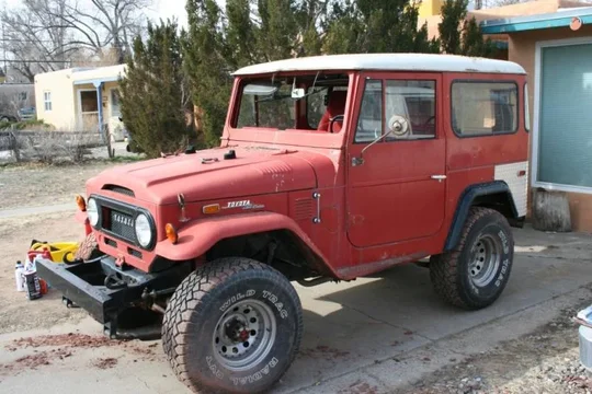

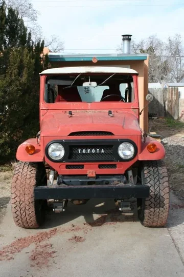

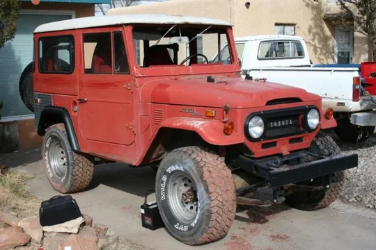

So last Sunday we went out to Tijeras and picked up Leila. She'd been sitting under a pine tree in the east mountains for at least 4 1/2 years, but she looked like she was in good shape. We got her on a flatbed and brought her home. this is what she looks like before I even cleaned off the pine needles... 003 compressed.webp
Yes that is her new battery behind her front tire...

Today we drained out the old gas, changed the oil, checked the other fluids, and put in a new battery. And miracle of miracles, Leila started right up! She blew a mouse nest out of her tail pipe, then we went for a spin around the neighborhood. After we cleaned the dead mouse, and his former home, out of the glove box, vacuumed, and wiped off some dust, she's not lookin' half bad.
Now we just need to get the windshield in.
she looks great! and runs to boot! you have a ready to go vehicle basically. I see Ron's mini in the background and he hasn't even started a thread on it.

She is a 72 with disk brakes (front & rear) on 33x12.5x15 and an F engine. Don't know enough about cruiser engines yet to know what that really means, or if it's a "2F" or whatever... She also has (maybe?) 2" shackles. Anyway, from what little I know at this point, I would say she's pretty much just stock so far except the brakes and shackles.
